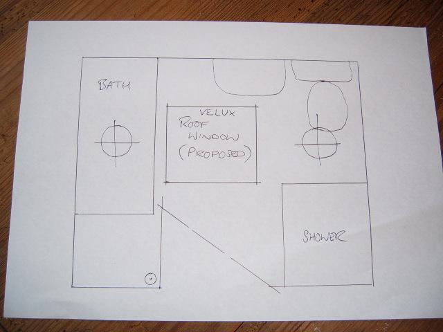

I need to install a couple of lights in my bathroom as soon as I have fitted a new roof window (it's a flat roof bathroom).
After a lot of help from a number of guys on this site I have chosen the following (these are all my budget would allow);
http://www.lightingathome.co.uk/end...-with-clear-outer-and-opal-inner-p-11408.html
From a technical point of view are these correct? Do I need to order anything else? I have an electrician booked for next week and need to have the things here waiting to be installed.
Many thanks.

You can also get IP44 lights here just incase you ceilings are a bit low.
http://www.ip44-lights.co.uk/ip44-flush.htm
They class these a flush ;)

Thanks again for you help gents.
I've changed my mind now I've seen these;
http://www.ip44-lights.co.uk/strata-0291.htm
They're square like the new roof window.
So I'll be alright if I get a couple of these?
Yes
Do I need any other bits or will the sparks be able to crack on when he turns up?
You really need to ask him that question - if the job involves removing and replacing a ceiling rose then terminal blocks, chocboxes and brown/red sleeving may be need - if it involves extra cabling (connecting one light to the other) then normally 1mm or 1.5mm T&E.
