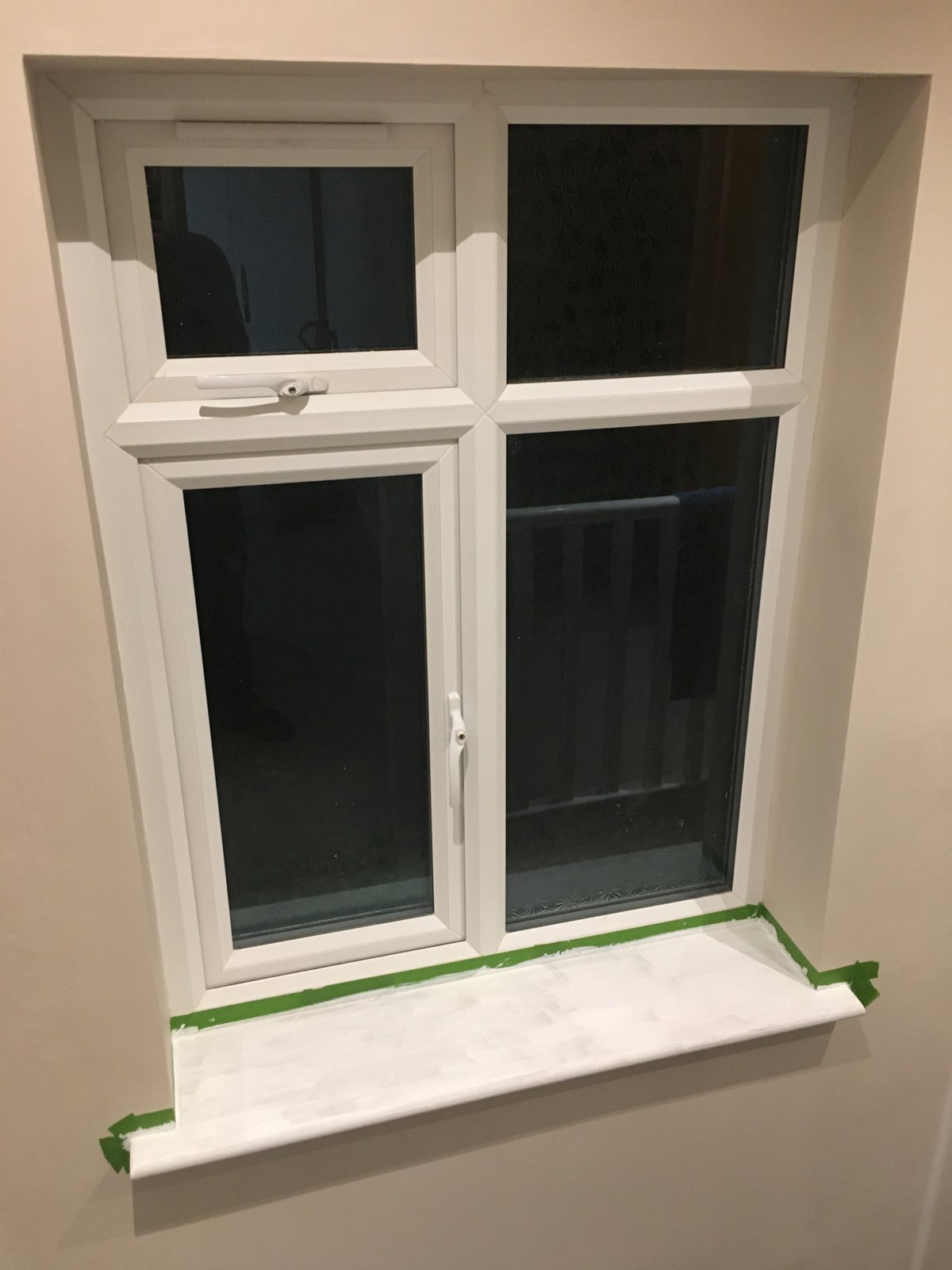

Correct method to paint window board
21 Aug 2019
310
9
Hi everyone I’m looking to paint my timber window board what is the correct method, I’ve already applied one coat of undercoat/primer what do I do next, do I need to sand it smooth the apply another coat of undercoat and primer and then gloss? Any advice what be helpful thank you
Yes, light sand, then undercoat.
For best results, keep applying undercoats until you have a perfect, solid white colour - ie no streaks etc.
Then, after a final light sand, apply the gloss.
This way will ensure you won't have a streaky gloss top coat.
