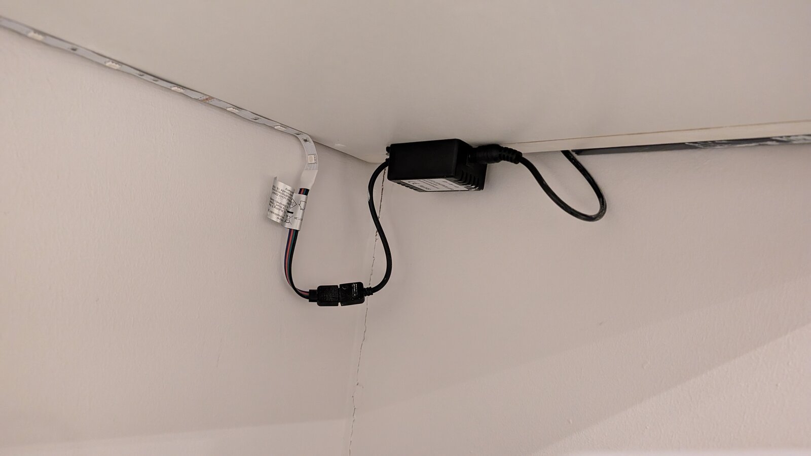

Hi All,
Ground floor are on a dedicated lights circuit on MCB. In the Kitchen, one of the switch is linked to a cable coming out of the wall, above cabinet (not easily accessible). The cable (2.5mm), is directly plugged into a brick transforming current to 24v to power a LED strip. That way the LED strip can be controlled with the light switch. To do this the brick has been drilled to pass the loose cable through it and the whole thing is just sitting on the top cabinet. It works, but looks quite trashy.
The goal is to keep that functionality but make the setup cleaner and up to regs. I thought of:
- Neatly plug the cable in a MK box with a FCU and place a 3A fuse. Attach the box on the whole, above the cabinet.
- From the FCU have a cable going into an adjacent power socket
- Plug the Philips Hue brick in the socket.
That said, I thought I could find a single MK Box to do this job but don't seem to find a fused socket easily, can you think of a better setup than what is suggested above?
Please shoot me down if not adequate or if you have a better idea. Constructive feedback gratefully received. Thank you All.

Yes, agreed, I have now added a couple of photos below.

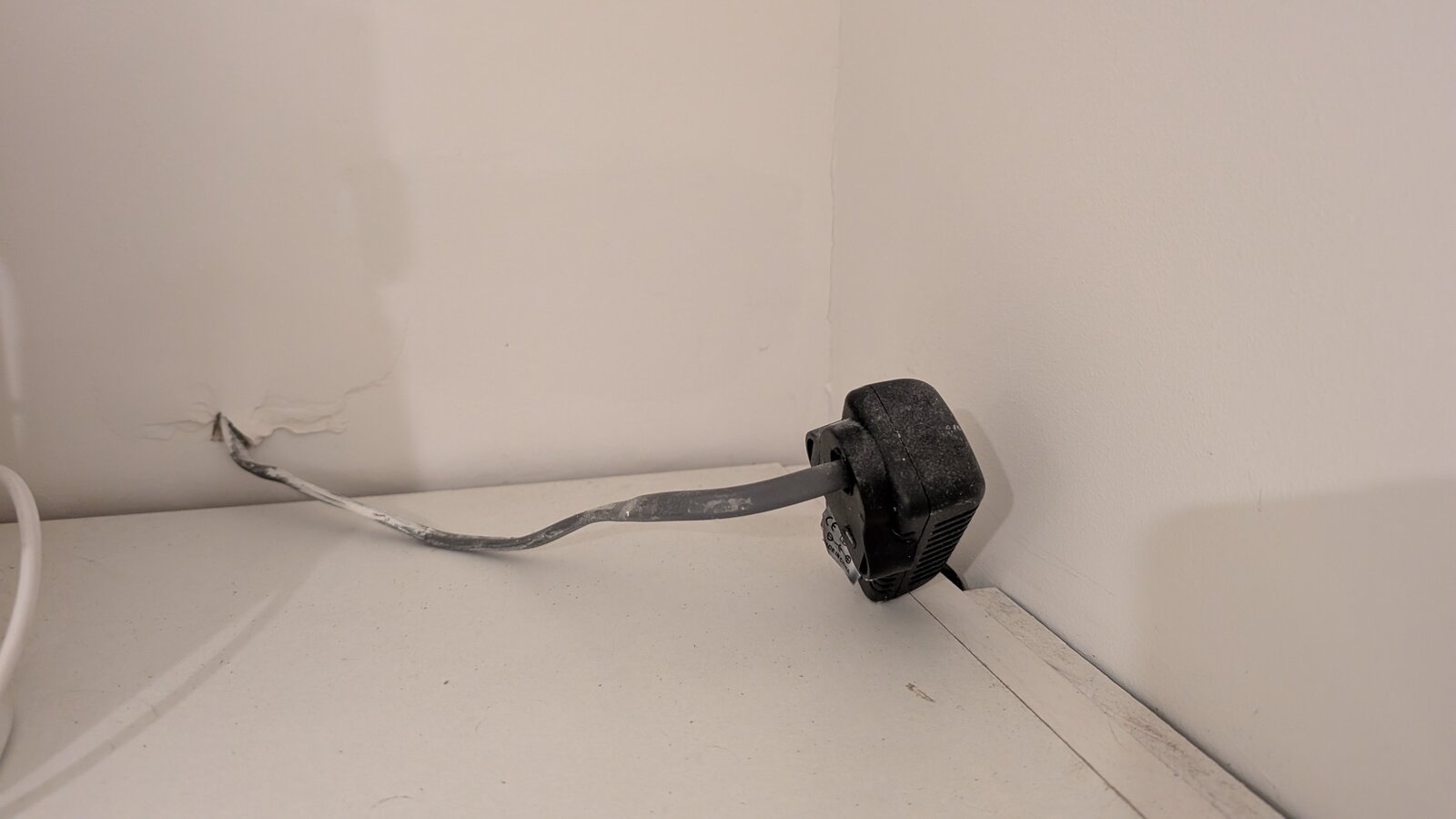

Quite simply the setup is: 6amp MCB module for the ground floor lights => lights circuits => one of the switch goes directly into the below PSU, which then goes into a 24v led strip. Trying to have this a lot neater, using an actual socket, attached to the wall.

What were they thinking drilling through a power brick like that??!! How is the cable connected internally? Be careful as I can see exposed remains of the plug pins that might still be live.
That brick with the cable through a drilled hole needs to be replaced and a socket fitted to the cable. If the socket is fitted to the back next to the wall it is less likely to be seen
