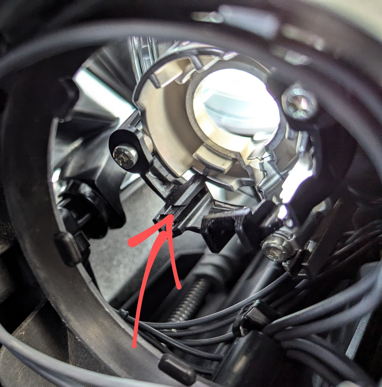

Corsa 2016 - replace holder/clip that holds the bulb holder
2 Aug 2016
194
37
Can't find what this part is called / where to source a replacement.
The bulb clicks into the bulb holder fine, but the black plastic part that then holds the bulb holder is broken.
Photo attached showing the opposite side that's okay for reference.
Vauxhall Corsa Sting Ecoflex 2016 Petrol 1398 cc
Any help much appreciated.
I think I’d be popping the bulb back in and then just wedging it with something.
I can’t see that bit being available separately.

Might do a test/mock-up with blutack and if that goes will give it a go
In the end found a cheap damaged whole light assembly with this part included - so decided to properly fix/swap it.
