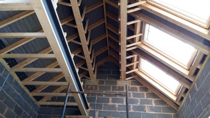

A few vaulted roofs we've done...Ok got it, thanks noseall
Wow noseall that's wonderful work. Do you work near Waltham Forest London? lolA few vaulted roofs we've done...
No. I did my London stint back in my mid-20's.Wow noseall that's wonderful work. Do you work near Waltham Forest London? lol
