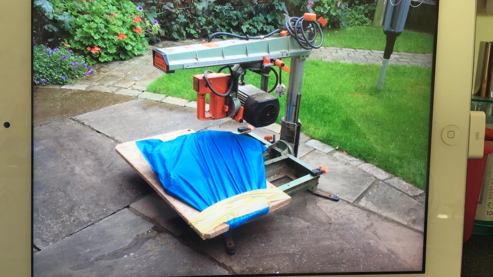

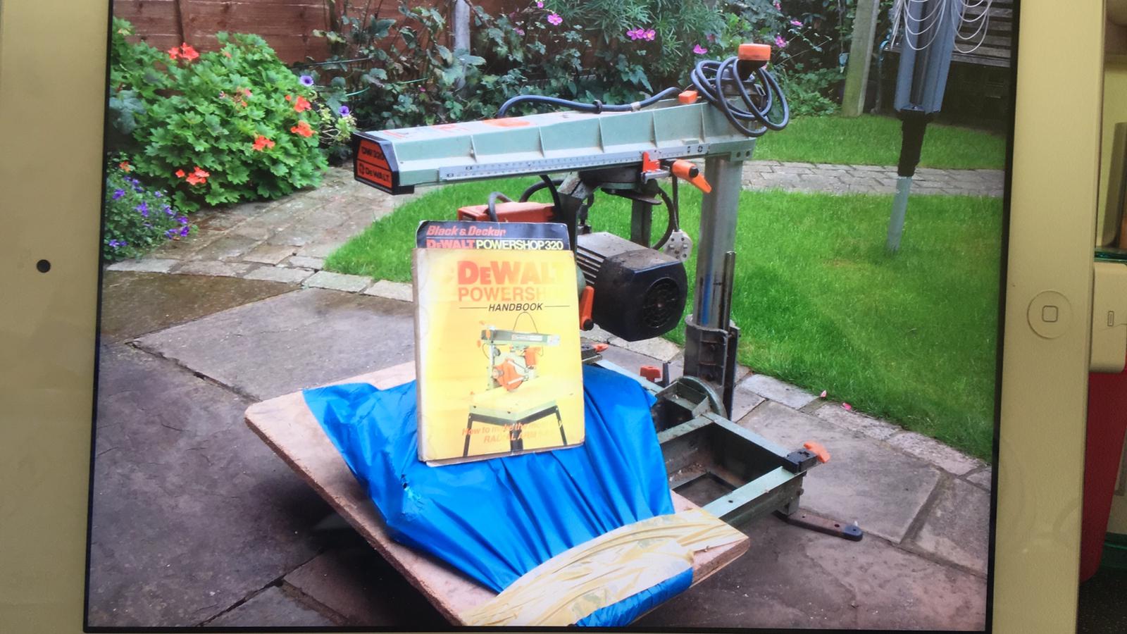

    I just need some help with what this may be worth to sell
    It comes with a few blades
    Any help would be appreciated

    not so much demand these day for a RA saw.

    That's also a pretty old model £100 if lucky (and working)

    Ive never used one but a friend of mine has one that looks like that and said it was the most dangerous thing he'd ever used.

    Am I right in thinking the guard is missing?
    If so £50

    Hmm, if so not £50, scrap metal.

    If the motor is in good order someone will no doubt have that for something

    Hmm, maybe if they can be arsed, radial arms have by and large been replaced with more accurate safer kit.

    Anyhow, to answer the OP's question, likely little to nothing.

    But it's the so-called "portable" (lightweight) model which I believe were under £200 (street price) when new in the 1980s. My DW125 cost me about £250 back then (1981). As others have pointed-out, though, this one has no guard, so it's probably only fit for spares because DW just don't supply spares for them any more (the model didn't survive the transition from original DW, through Elu to yellow, current DW which probably makes it 30-odd years old)
    In general the modern sliding compound mitre saw is far safer and more accurate/repeatable in use than radial arm saws (hobby model radial arms all seem to suffer from base frames which twist and flex in use meaning absolutely no repeatability when cutting mitres - industrial models are a different ketle of fish in my experience)
