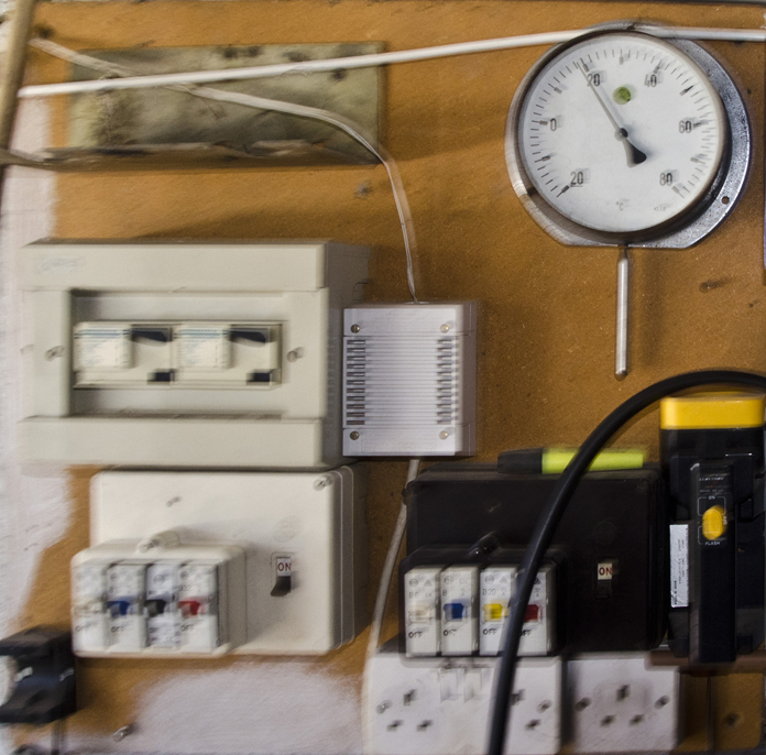

Sorry to hijack this thread , would it be much more expensive to replace a fuse box with a consumer unit ? . I've never had a problem with it but don't fancy messing around with fuse wire is a problem occurs
Not really.
If the gas and metal water pipes enter the house a long way away from the fusebox it may cost a little extra. As bonding would need upgrading
Due to the age of installation there maybe other surprises. Therefore it maybe worth having an EICR doing before hand to reduce the surprises for both you and the electrician.
The fuse box (not the make fuse box but real fuse box) was used until late 90's when the name changed as we started to use type tested equipment, and it changed name to consumer unit, which could and still can have fuses in it, and the old Wylex fuse box can use re-wired or cartridge fuse or a MCB, and very easy to swap from re-wired fuses to MCB. However the main reason to swap a fuse box to a consumer unit is the latter allows use of RCBO's, RCD's and SPU. Although in theory you can all RCD protection Wilex-board-with-RCD.jpg as seen here above the old Wylex distribution units, it is not cost effective, that was done before the modern consumer unit was produced around 1992.

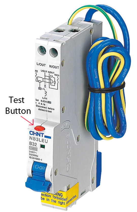

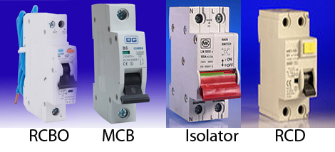

So the consumer unit width is controlled by how many circuits and what is fitted the MCB or RCBO are a standard width around 17.6 mm, so total width is controlled by number of devices, a RCD takes up two slots, so an all RCBO consumer unit is around 70 mm shorter, some SPU are double width and some are single so by using a single width one you can reduce overall length.
However the hight of a RCBO may be only 81 mm, but most are taller, and I don't know there is any consumer unit made today which will not take the longer version, so 260 mm high is around a standard height, there may be the odd one which is not as high, but unlikely anything today will fit in the space taken by the old fuse box. The box has these PartID_CU.jpg in it all around same hight but is designed to take the taller version RCBO.jpg so very little difference between makes and models in height. And to be frank Fuses, MCB's and RCBO's produce heat, and the consumer unit needs to get rid of that heat, so there is a limit as to how small it can be made.
