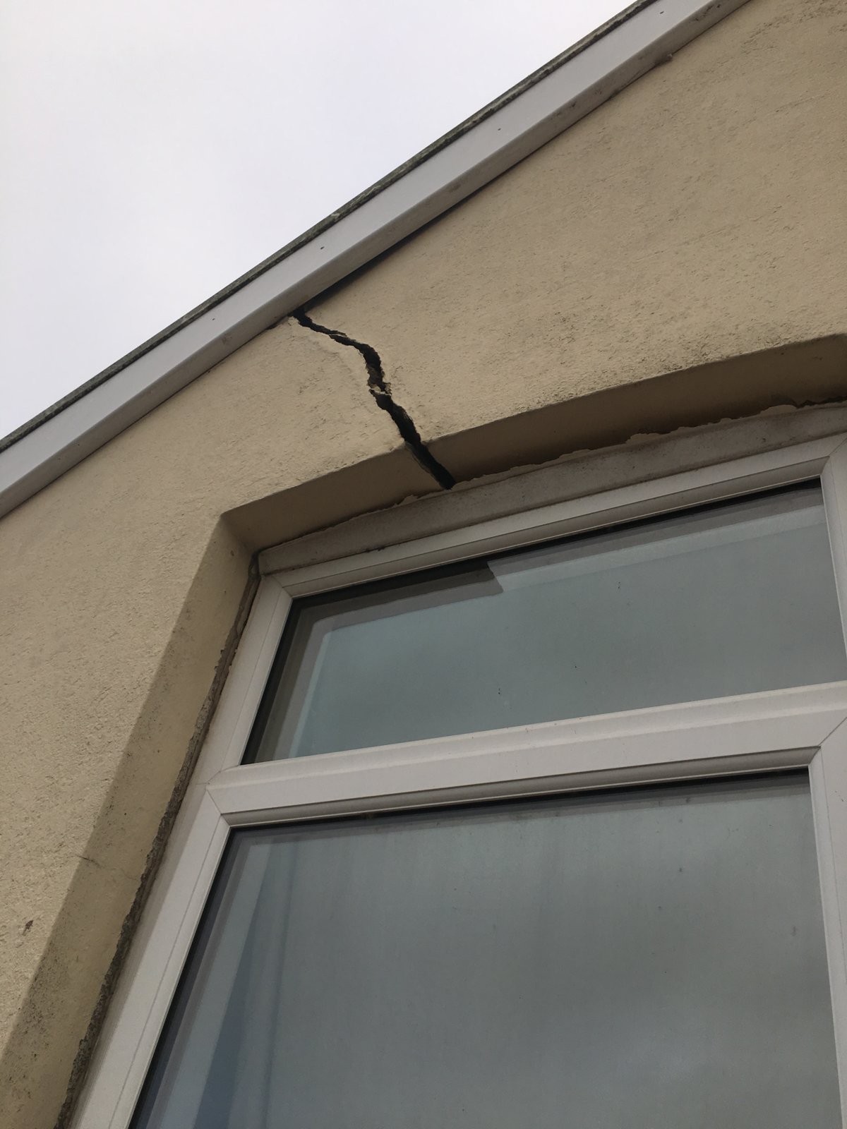

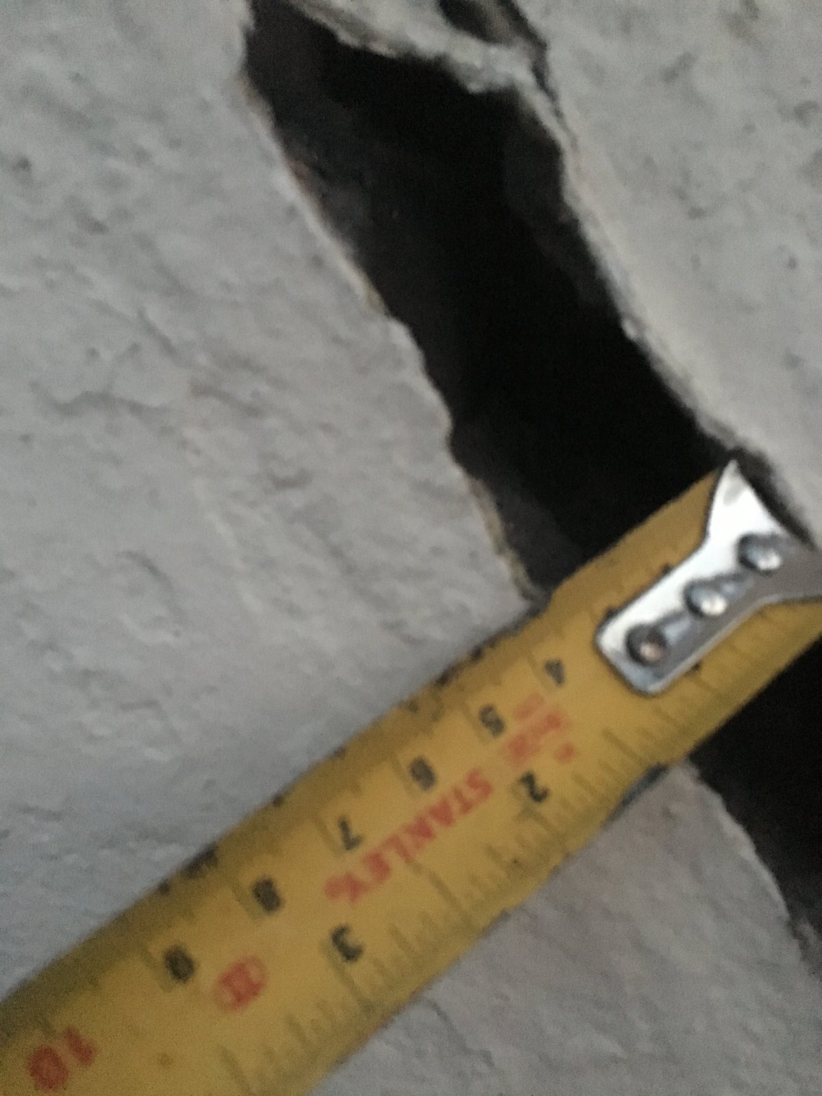

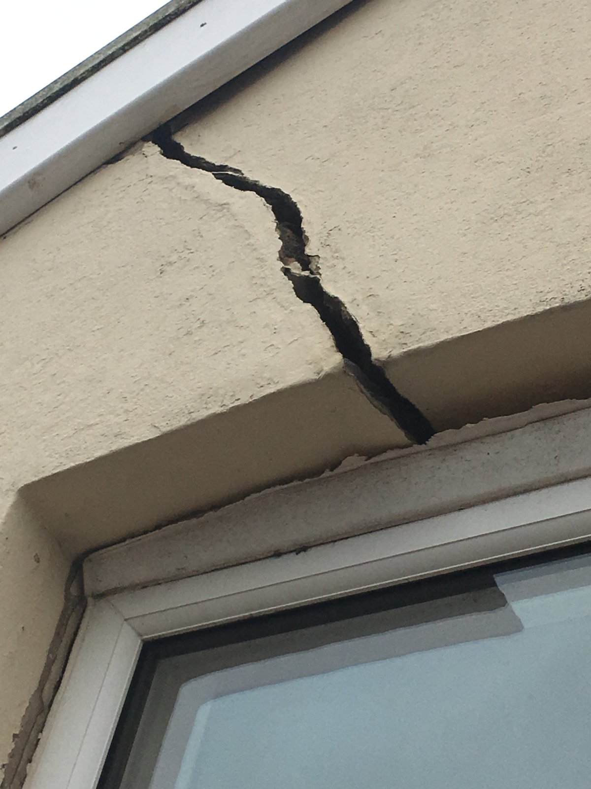

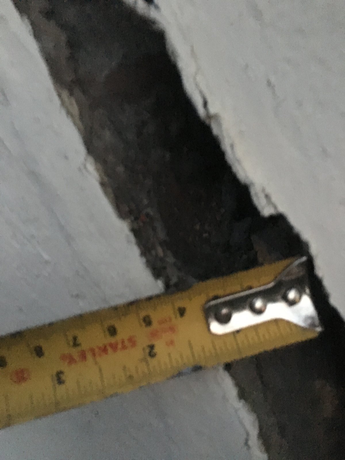

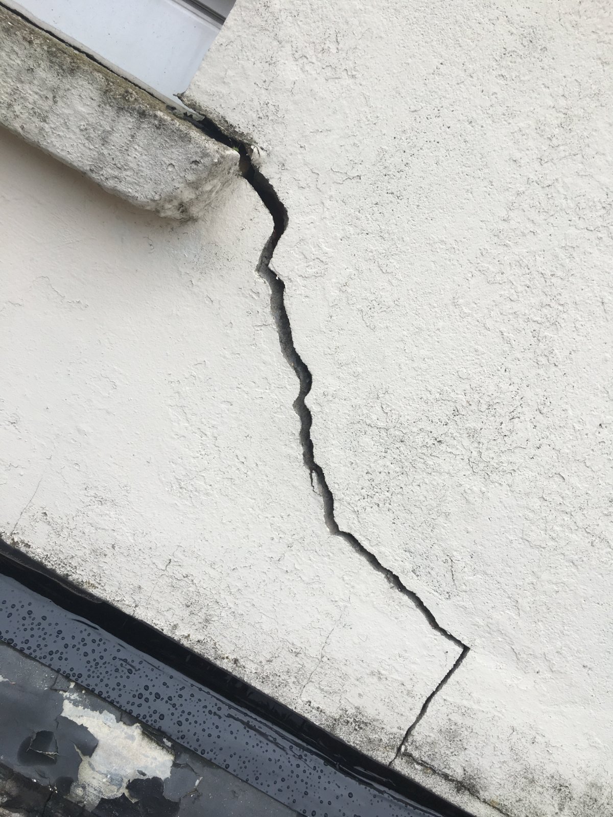

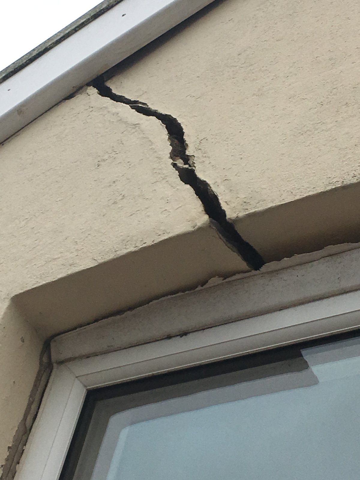

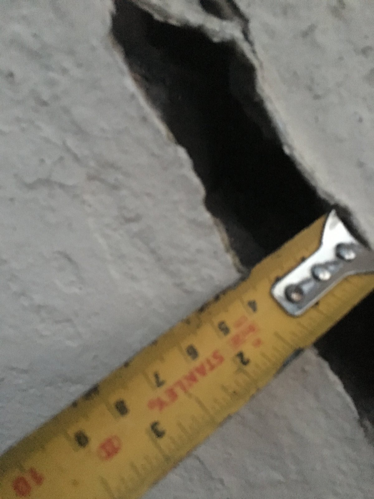

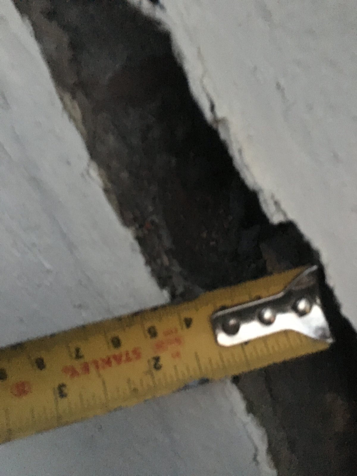

Hi,
I am after some advise. I have had a builder doing a single story extension for me. We have had nothing but problems with him from the start. Him turning up for a couple hours a day and sometimes only twice a week. (This we could deal with) the real problem started when he took out the load bearing wall and placed the steels on. Our house has sub sided and we have 1 1/2” cracks going up the existing walls. He seems to think it will be okay to strap it and screw it together. I was wondering what I could do about this ie claim on his insurance etc as I’m really at a loose end on what to do. I will attach pictures

I think with the size of the cracks if you have concern about further movement you might want to call building control and get their dangerous structures person to take a look and recommend a propping regime, in case it hasn't stabilised. They have a statutory responsibility for building safety so they should be able to help advise with any immediate risk.
If the cracking is entirely above the level of the beam, it's unlikely the house is subsiding - cracks above are caused either by negligent propping/installation of the beam, or a beam which is too small for the span. If there is cracking below the level of the beam as well, then the problem is more serious.
If the beam is too small, it's the responsibility of whoever chose or specified the beam; otherwise it's the builder for a shoddy installation job.
as above,
but how do you actually know if he has the correct insurance or even any insurance?
your house has not subsided, by the way.

The wall seems to have spread sideways not just downwards, so could indicate a more extensive problem and repair.
You need to stop work and if building control are involved you need to get them out now (but not for advice just to record the incident). Then you need to instruct an experienced structural engineer (not one of the builder's friends) and follow their advice. Tell you home insurer too as this could be costly and involve action against the builder.
I am Not a Builder but that crack at the upper window looks like it has been bodged/repaired before to me.
Well spotted - it looks like the paintwork has been touched up.
Odd place for a crack - has it got no lintel? It has an arched head, but would a brick arch crack like that, or is that a decorative arch
Anyway a crack nearly 40mm wide, to me needs a bit of re building
And if you are still living there, or even visiting, then get out NOW and find somewhere else to stay!
