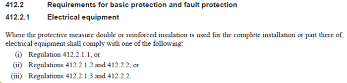

As far as I can see, the issue is not really about the (plastic) accessory, per se. In the case of a plastic ceiling rose or lampholder, when there are usually no exposed-c-ps (not even screw heads), the absence of a CPC is surely of no importance/relevance in relation to safety, is it?
As far as I can see, the only issue arises when, say, a (plastic) switch has a metal back box. As you say, if that backbox (which essentially 'becomes part of the accessory') is not earthed (because there is no CPC) then it can be said that the heads of the faceplate screws (if metal) are (non-earthed) exposed-c-ps, and therefore non compliant - but, as you say, tat can be overcome either by using non-metallic screws or by 'insulating/covering' the screw heads in some way. If the backbox itself is 'plastic' (e.g. a 'plasterboard box'), there is presumably no issue.

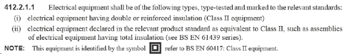

However light switches are not often marked as class II neither are ceiling roses,
As opposed to the definition of class I and class II, the marking of things by law (European Law at the moment in our case) with class II icons only applies to appliances, so the things you are talking about will never be marked. You bring this up rather often and it is simply not an issue.
As opposed to the definition of class I and class II, the marking of things by law (European Law at the moment in our case) with class II icons only applies to appliances, so the things you are talking about will never be marked. ...

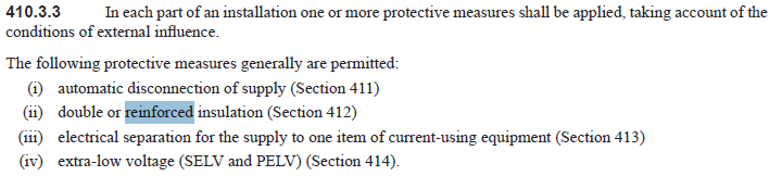

That might be true in law, but BS7671 appears to 'require' marking of any Class II items of 'equipment' (whatever that might include).
It's not the marking that I 'keep bringing up', but the requirements for protection beyond 'basic insulation'....
... My point is that 410.3.3 appears to require that all parts of an installation have to have ("shall have") one or more of the specified protective measures in addition to 'basic insulation". If we forget the special cases of (iii) and (iv), the (i) seems to imply what we would call 'Class I' (reliant on a 'earthed' metal barrier) or (ii) (what we would call Class II). Hence, if part of an installation cannot be Class I (because there is no metal barrier to 'earth', then it presumably has to have "double or reinforced insulation"? Are you saying that you believe that the sort of accessories we are talking about are considered to have "reinforced insulation", even they do not (are not required to be) marked as such?
Kind Regards, John
I believe that the scope of the word 'equipment ' is not clear in this and other standards. Otherwise everything would be marked. The EU legislators take this to mean 'Appliances'. The wiring regulations want it to mean something more general. As it is so unclear, sockets and the like are not (in my experience) marked.
You will notice that I was addressing Eric with that comment.
It's certainly true that few, if any standard 'electrical accessories' bear a Class II marking, even when it looks that they would probably 'qualify'. However, I'm not sure that the authors of BS7671 would necessarily agree that they are "so unclear" (in stating what they mean by "equipment"), given that BS7671 appears to clearly define "equipment" as encompassing virtually anything and everything comprising, or associated with, an electrical installation ...

I confess that I didn't at the time (or, at least "didn't take it in"). However, as I said, whether there is marking or not, 410.3.3 appears to require that, for any 'electrical equipment' (presumably per above definition), in an LV part of an installation, which does not have any external metallic parts which could be earthed (to facilitate ADS) there is effectively a requirement for "double or reinforced insulation" - so, what we would normally describe as "Class II", even if there is no marking or explicit claim to that effect.
If there is 'nothing to earth' and there is nothing confirm that the insulation is "double or reinforced", I can't see how one could be confident that one was complying with 410.3.3 when using a particular product.

As you say not all equipment or appliances are marked, common to see a bulb holder marked double insulated but never found a bulb so marked.
Are you sure about that? How can a (standard/simple) bulb holder be regarded as having "double or reinforced insulation" as a protective measure if one can stick one's finger in and touch the potentially live contacts?
