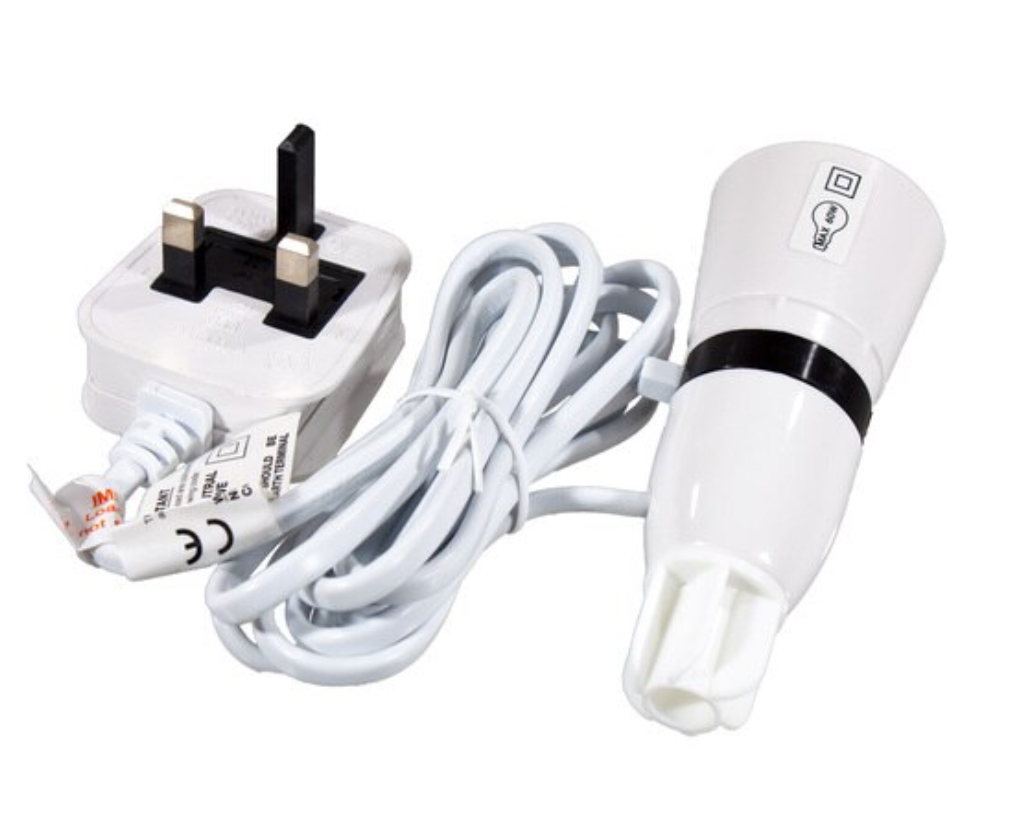

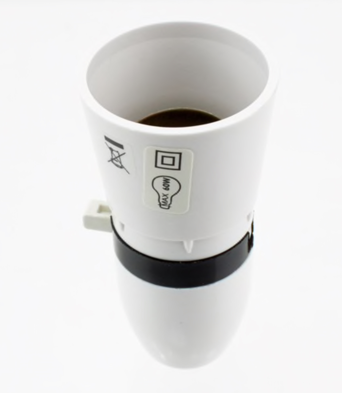

Yes sure, I have had bulb holders with the double square on them.
Hmmmm. Were the contacts 'touchable' and unswitched (within the holder)?Yes sure, I have had bulb holders with the double square on them.
Your guess may well be right, but it's surely fairly ridiculous (and maybe 'wrong') to put a "Class II" marking on it, isn't it?It was a plain simple bulb holder BA22d not the safety type. I will guess it is marked to show can be used with 2 core cable ...
As I said, it just seems plain ridiculous to me - how on earth can something be 'Class II' if there is not even 'basic insulation' (let alone 'double or reinforced' insulation) between prying fingers and live parts?!Isn't that just a mistake?
Well, IF the construction of the lamp were such that it qualified as 'double or reinforced insulation' (between live parts and prying fingers) then I suppose it might but, to my mind the product as manufactured and sold (and marked), itself, certainly can't be.if it had a lamp fitted, would you call it double insulated then ?

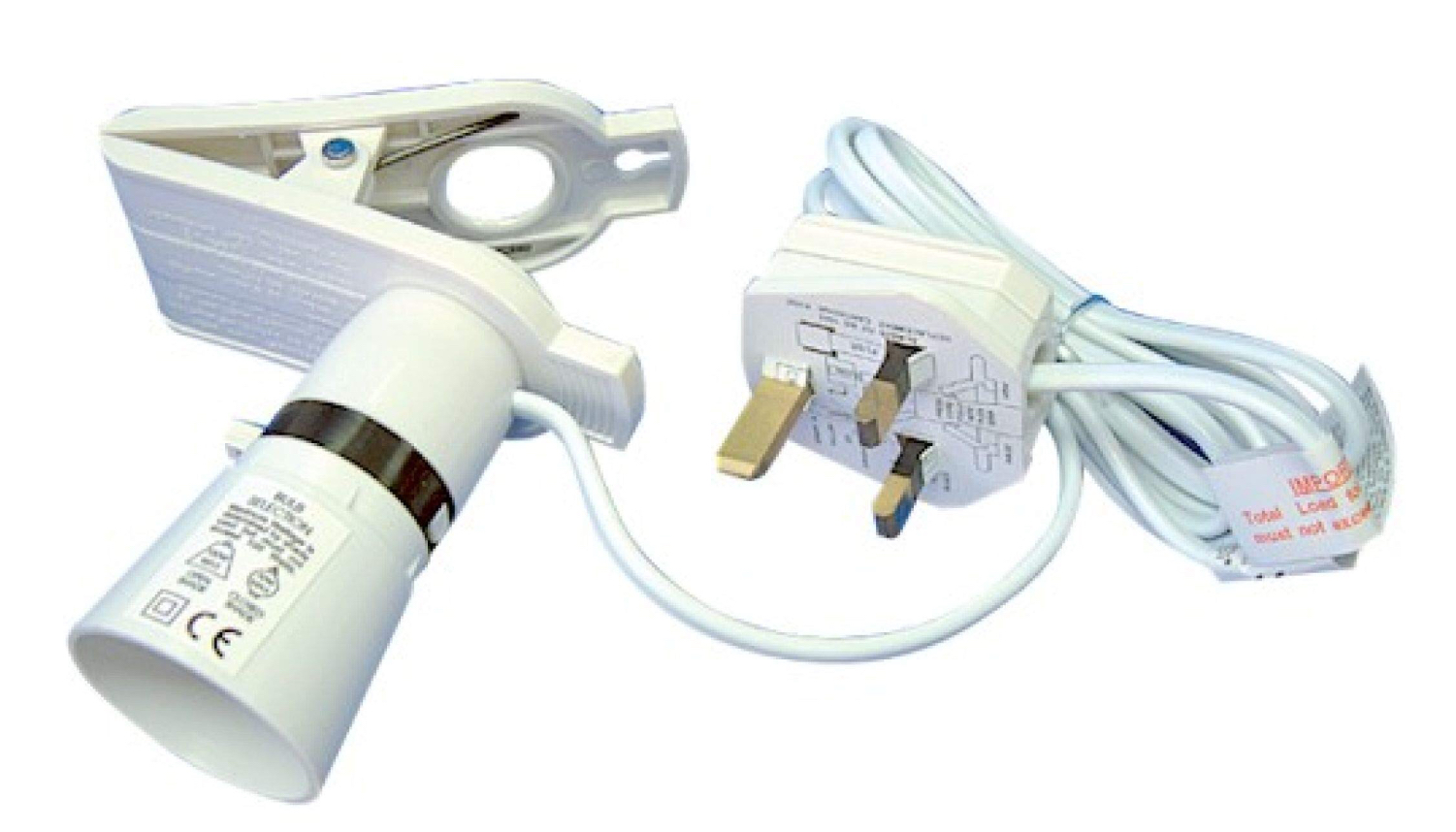

You will presumably know my view from what I've already said, so perhaps I should ask you what you think?... What about these products?
Both those products, as sold, allow (if plugged in and switched on) free access of a finger to live parts, without even any intervening 'basic insulation' - so do you really believe that they are reasonably (or correctly) described/marked as 'Class II'?
Kind Regards, John
Well, as I have said countless times, it has always 'met my eye' that there are some major deficiencies in (what I understand of) this business.I think John must have been correct all along, then. There must be more to this Class 1 or 2 than meets the eye.
