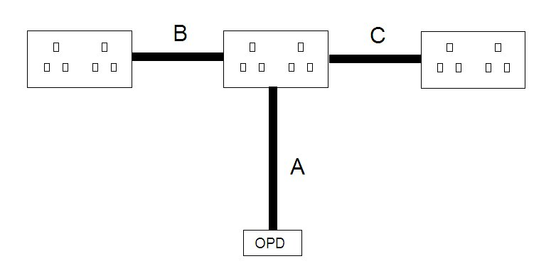

Not necessarily - it is also called 'branch' on a radial. I don't know why.
I had read this as being a reference to the term branch being used as an alternartive to spur, applyng to a radial circuit. I think I have misinterpreted this.
If we break into cable, at any point (even at the OPD), we create what BS7671 refers to as a spur. We don't have forks, or offshoots, or branches. The term spur, is what is used by electricians.

I have seen this many times, but it is just opinion. There are pros and cons and installing a ring is still compliant with BS7671. Some electricians don't like rings and others do. The reality is that the main concerns are not wth the initial installation but rather with future changes introducing problems. FYI, my personal preference is that I'm happy installing either circuit.
Yes, I think there has probably been a misunderstanding. As I presume we all accept and agree, BS761 says that "spur" means a 'branch', or either a radial or ring circuit.
Well, BS 7671 obviously recognises the concept of a 'branch' (even if in an 'everyday' sense) - since, as above, it defines a spur as being a branch (of a radial or ring circuit).
We do - but, as I said, in the case of a radial, that is an unworkable definition, even if it is what the authors of BS 7671 have chosen to write. Taking the simplest possible example (to save time!), what cable has been 'broken into', and which is "the spur which has been created" (B or C)? ...

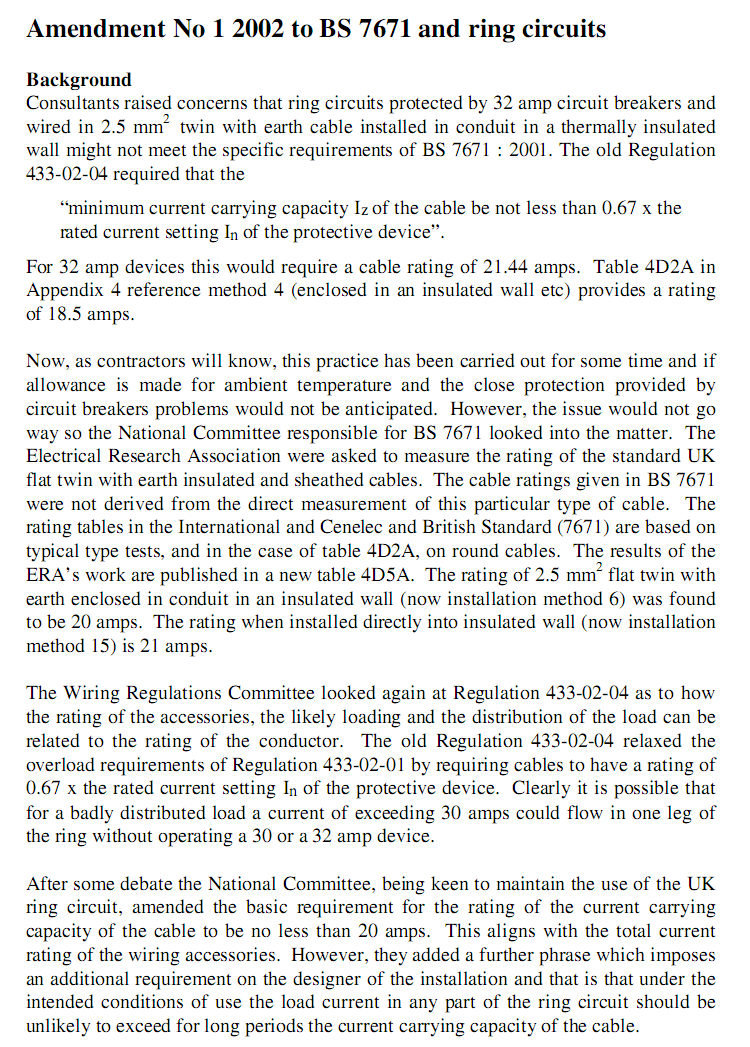

A ring allows a circuit with a larger In than the Iz of the cable would normally support. Whatever the protective device, Iz must be ≥ 20A. It really doesn't matter what the factors are that reduce a cable's CCC - they are what they are, and if they bring Iz down to < 20A you may not use that cable, and if they don't, you may. (Subject to it meeting the minimum csa requirement as well).
Why? I don't know if that is the reason it is as it is. Why would it be?
I wasn't suggesting that is the reason, just pointing out that the minimum is 20A, and that is 27 derated by .725. But it wasn't chosen because that's what it is. It used to be Iz ≥ 0.67In and in 16th AMD1, after much jiggery-pokery they changed it to 20A.
How the original 0.67In figure was arrived at IHNI, but if you can find a copy of the "Amendment No 1 2002 to BS 7671 and ring circuits" article from Spring 2002 Wiring Matters you can read a recipe for fudge an explanation of the engineering work that went into establishing a fixed limit of 20A. It's no longer online at the IET - they apparently do not understand the idea of history.

The 20A is 66.7% of the 30A (3036) rating and the need for 2.5mm² (with 27A CCC) is because of the 3036 0.725 derating.
Neither do I. I am not arguing about that. I accept that there is a valid reason for it.
It does, though, mean a 40A MCB would be satisfactory on a ring.
As above. 66.7% of 30A.

20A is ⅔ of 30A. But 20A was not chosen because it is.
Exactly. So I am correct.
I point out that you need an Iz of ≥ 20A, and that that involves considering installation method and all the other applicable rating factors (of which Cf is only one), and you say that.
I'm not sure what you think I've shown you to be correct about, but it certainly isn't your basic premise that 433.1.204 is still written for 3036 fuses.
It isn't, it's written for ring final circuits wired using cables with an Iz of ≥ 20A, i.e. cables with a CCC that takes into account installation method and Ca, Cc, Cd, Cf, Cg, Ci, & Cs.
Exhibit B: Table 52.3. Sometimes the regulations impose a minimum csa.
Although for 32A MCBs shouldn't it be a CCC of (32*66.7%) 21.33A?
No, it should be 20A, because that is what has been required for the last 16 years.
