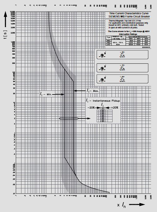

I don't think I've ever seen a 'full' t/I curve for an MCB. However, I can but presume that having initially been essentially 'vertical' (at I=5In) from 10s downwards, it must at some point almost 'turn a right angle' and become essentially 'horizontal' when one gets down to the operation time which is essentially the shortest possible (as imposed by mechanical considerations of the mechanism), regardless of how much higher the current may be. I presume the same is not true of a fuse, since I see no reason why there should be any theoretical minimum to how quickly a fuse could blow.
Kind Regards, John
I've found the following in my archives. It is far from anything domestic (a breaker with an In of 800A, with magnetic tripping seemingly happening around 8In), but I think that (even though hard to read at this resolution) it partially illustrates what I was suggesting. When currents rise above about 10In (corresponding to around t=0.04s), the curve starts flattening out, and even at 100In (i.e. 80kA for this device) operation time is still (fractionally) above 0.01s. It therefore looks as if around 0.01s would be 'the minimum' for that device, regardless of how much higher the current became. [note that the x-axis is labelled is terms of multiples of In, not amps]

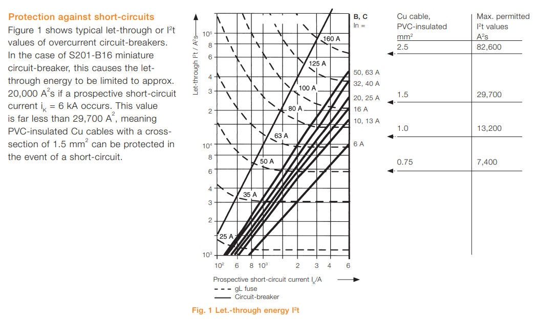

An example of how the I²t values relate to actual cable sizes (complete document here: http://xo4.uk/x/abb_MCB_types.pdf )
Values on the right side are the max I²t, which for a given conductor is also k²s²
The point being that k²s² is greater than I²t.
(examples above use 70C pvc insulated copper, k is 115 )
Note the lines for fuses, particularly the 80A and 100A types which are below the levels of the MCB values at higher fault currents.
This is not only desirable, but necessary, as stated in 536.1

Judging by flameports diagram anything above 4kA. I think i used 6kA but also the wrong i2t.
Anyway as i say now i know the upstream fuse limits it (as a requirement for compliance) there's no problem after all.
Judging by flameports diagram anything above 4kA. I think i used 6kA but also the wrong i2t. Anyway as i say now i know the upstream fuse limits it (as a requirement for compliance) there's no problem after all.
I'm not totally sure what it is you are saying is 'limited' by the upstream fuse - is that a reference to flameport's point that heating of the upstream fuse will reduce the fault current to below the calculated PEFC based on a 'cold fuse' figure for Zs? If so, do you (or he) have any idea how one can estimate the magnitude of that effect?
I'm also a bit confused by your reference to "a requirement for compliance". Are you talking about compliance with 536.1 (as quoted by flameport)? If so, that is surely about breaking capacity of the devices (and is seemingly the basis underlying the dispensation for 'type tested CUs' in domestic installations to have 6kA, rather than 16kA, devices), not anything to do with the adequacy of ('adiabatic') protection of conductors, isn't it?
If my reasoning is correct, the graph posted by flameport seems to illustrate why 'assuming' an operation time of 0.1s, or even 0.01s for adiabatic calculations will usually result in wildly misleading answers ...
... reading It figures as best as I can from the graph, it would seem that the operation time of a B32 is just under 1ms at 6kA, about 3ms at 1kA and about 5.2ms at 500A (note milliseconds). It would therefore seem that even 0.01s is pretty conservative, and that an 'assumption' of 0.1s could lead to one thinking that much larger conductors are needed than is actually the case.
