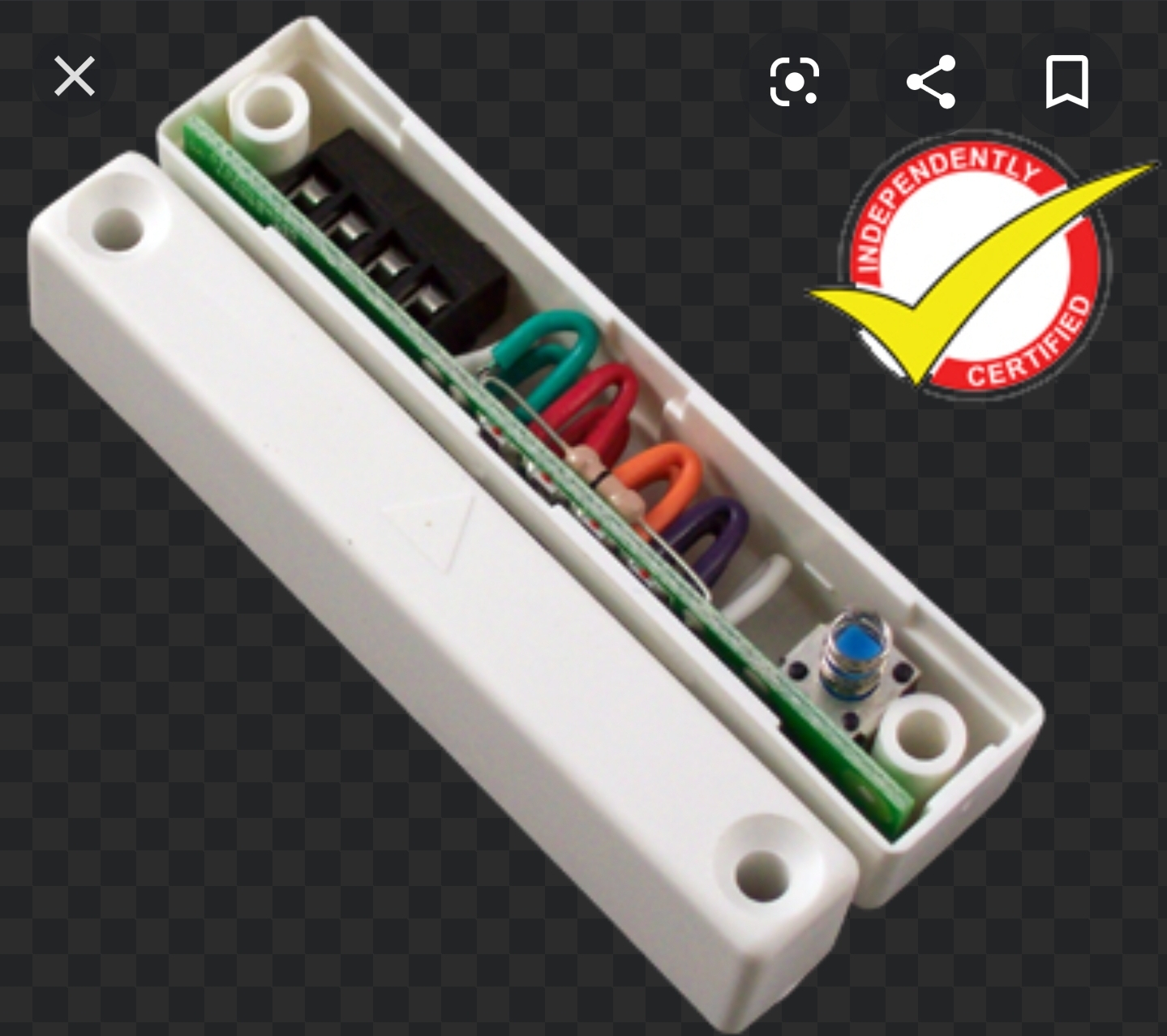

CQR SC517 door contact wired to Enforcer v10
link insecure, however the manual should tell you which ones to cut depending on how its wired ie one or more units.
They come with a sheet ....normally the red links for this value
Thanks after looking at it you where right just instructions said pyronix Various and then clocked castle caretech red/red
