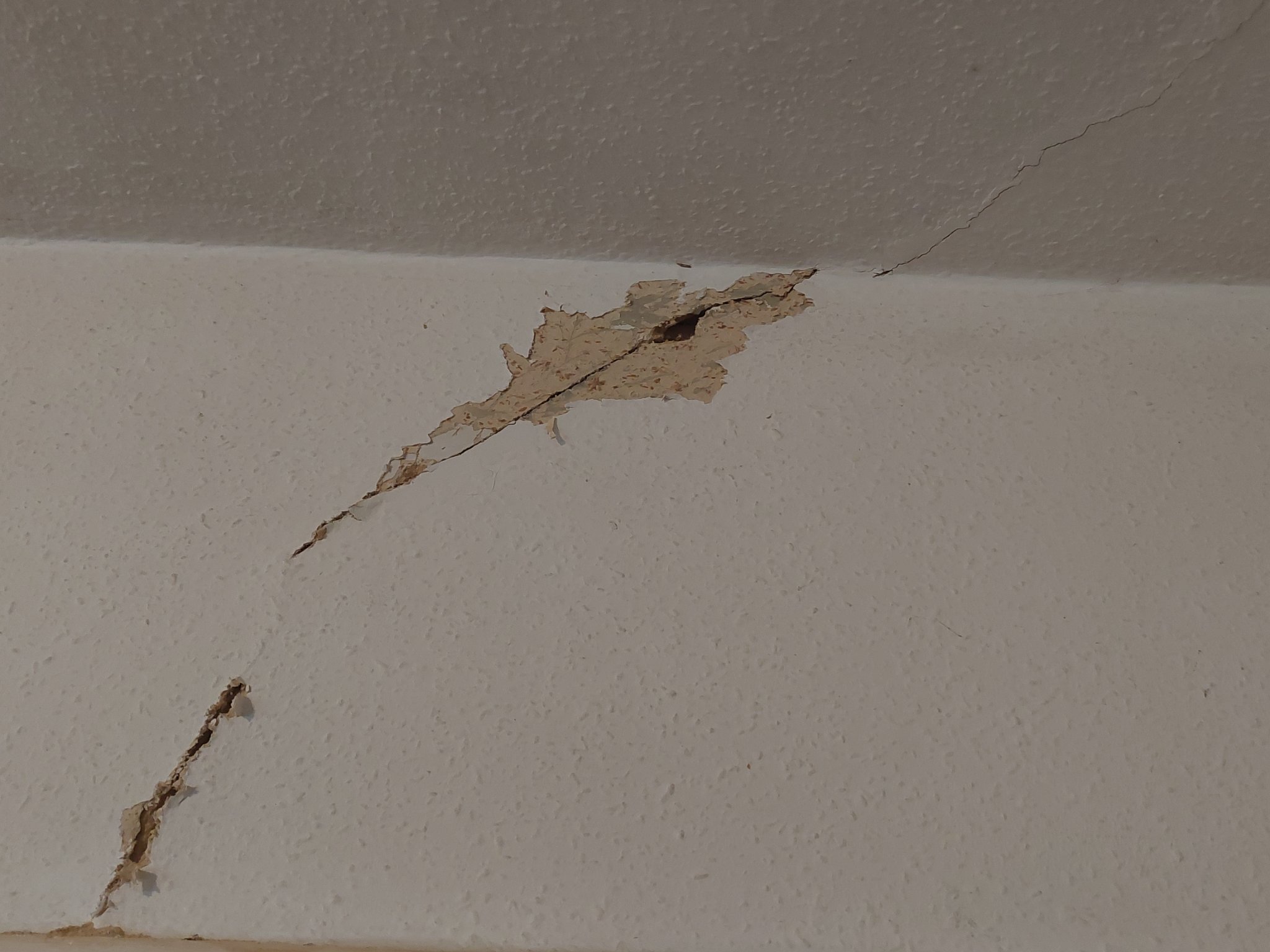

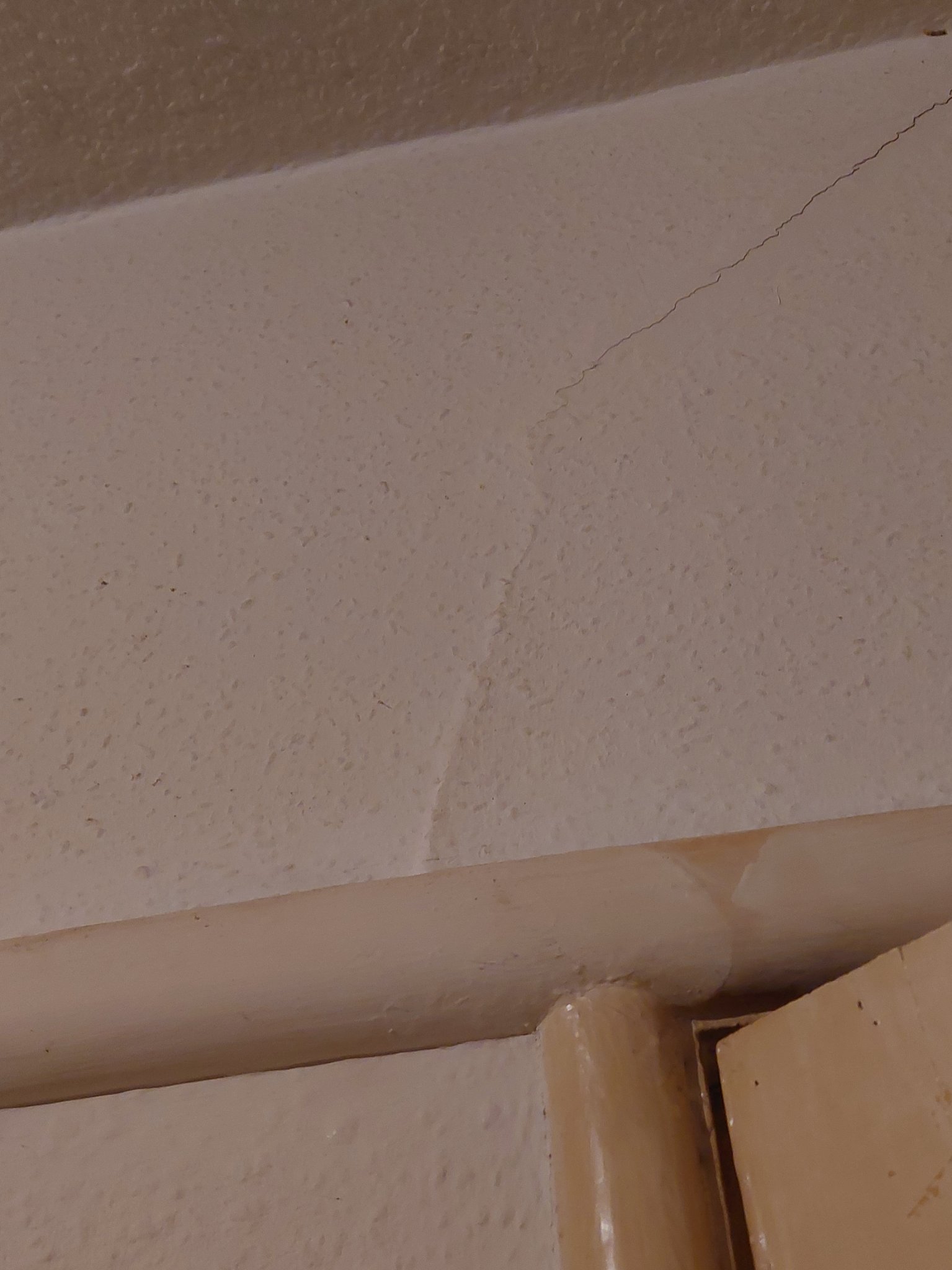

The crack is above an internal door and goes up into the ceiling :/
Any idea what could be causing this?

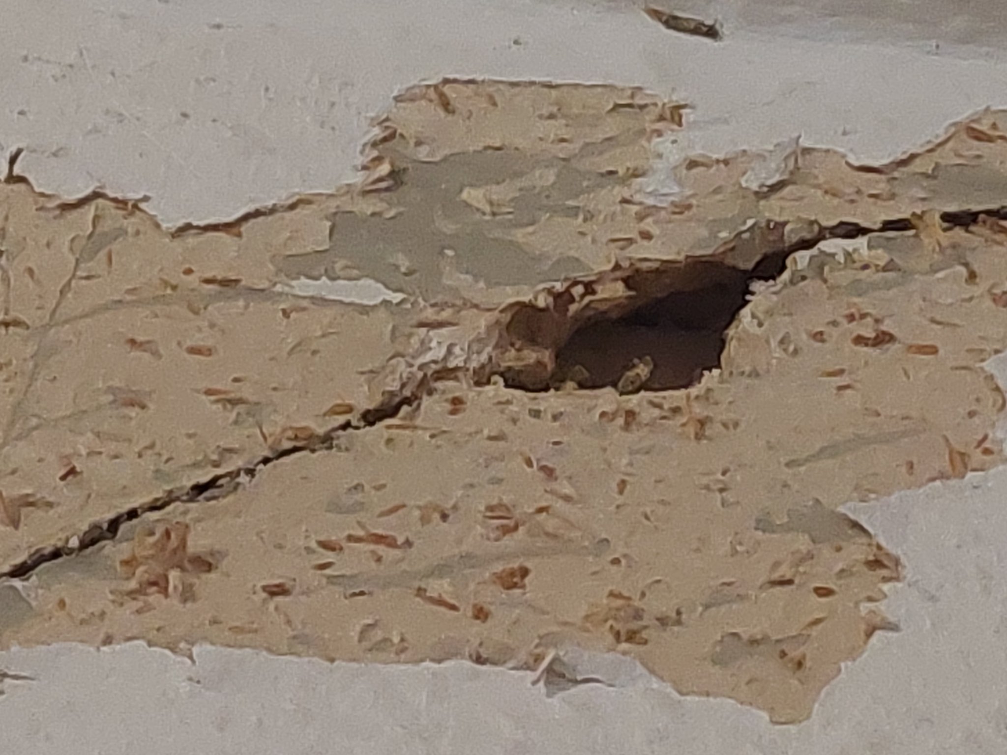

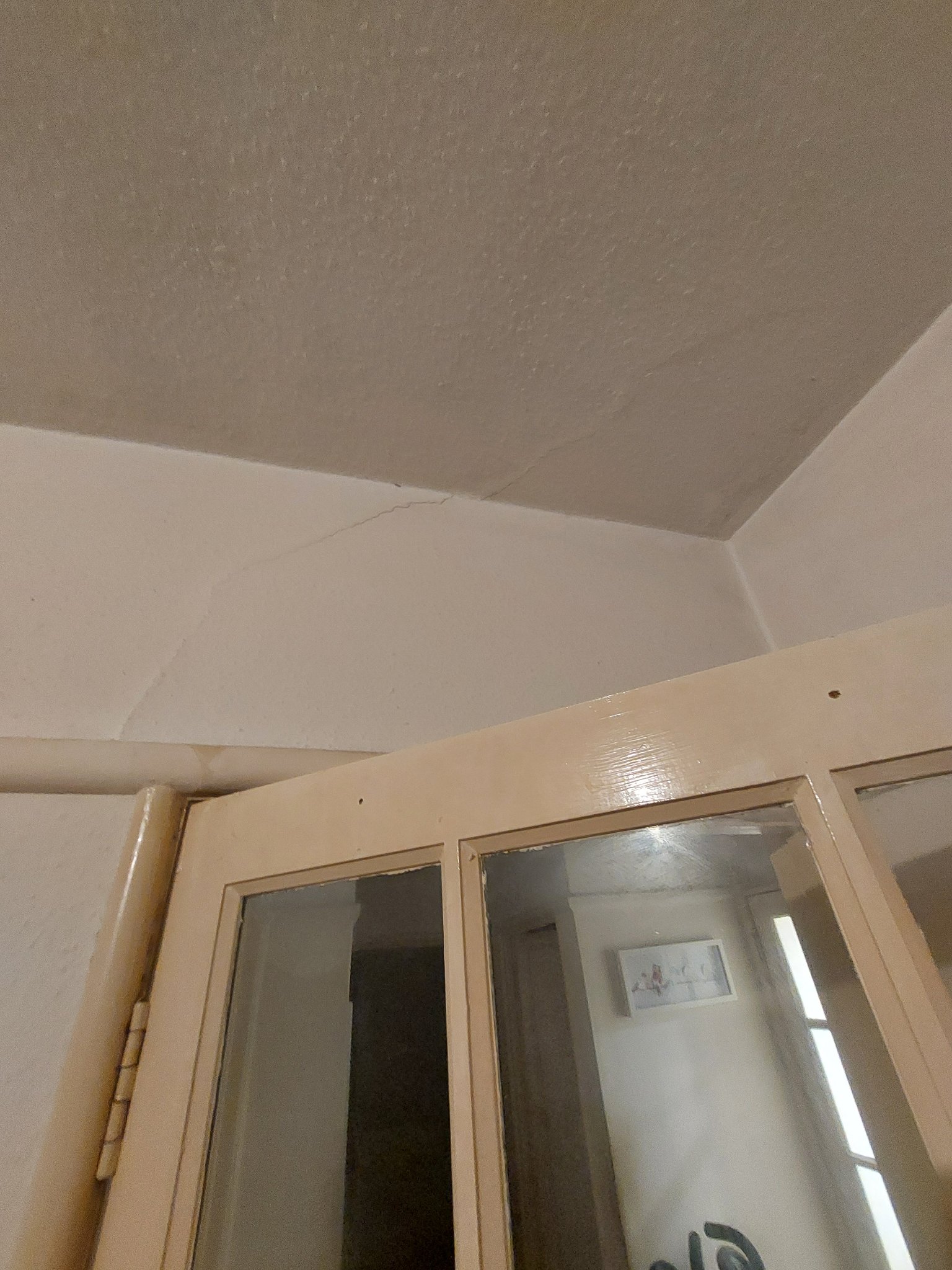

Lath and plaster walls/wall and ceilings?
Normal.
If you had coving it would of gone through that as well.
Loft above?
Prop up ceiling.
Vacuum off loft side.
PVA 4 to 1 ISH
Pour some plaster over.
Wall rake out.
PVA.
Filler.
Just an old house and movement. Needs TLC and keeping up to standard.
This is how it looks after I've taken off the wallpaper
