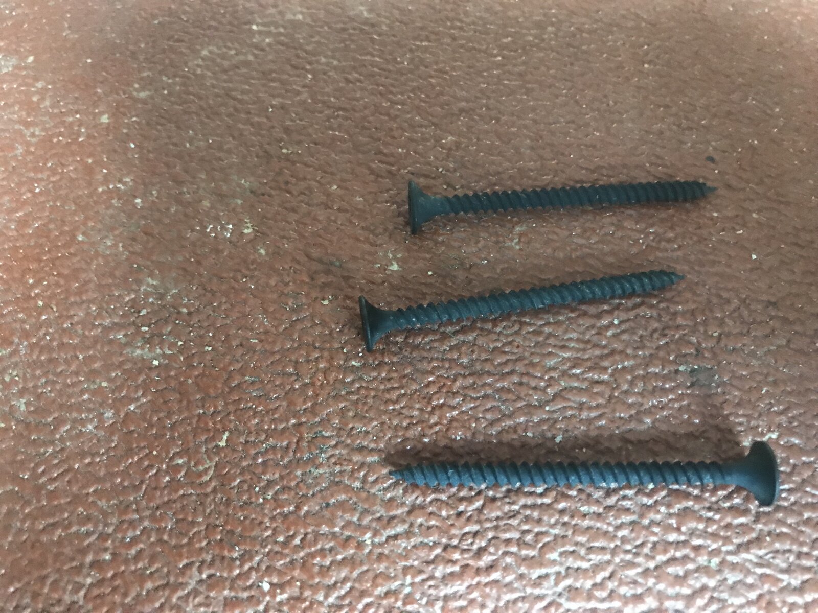

Add two extra screw fixings, in the middle between #1 and #2, and between #3 and #1, make then a little below the plaster surface, so you can apply plaster over the top. That should pull the board up, then you should be able to plaster over the top of all 5 heads.
Thanks. However, not much good at plastering.
Hi again
Have these plasterboard screws in toolbox but not sure of drill bit size to use.
Also how far into plasterboard should they go?
