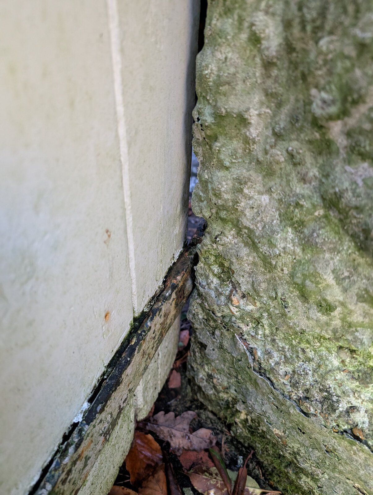

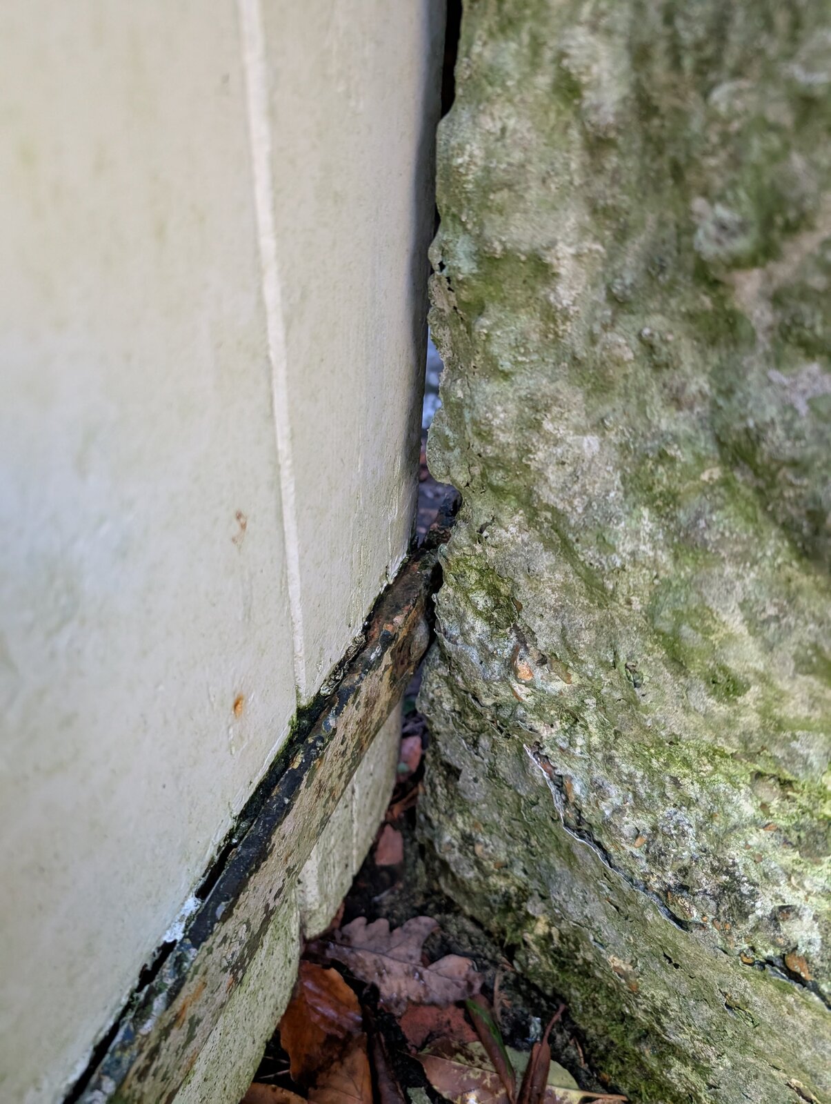

Let me clarify the point regarding the hinges because there might have been a misunderstanding. The hinges are attached to the door by a raised metal bar. When I open the door fully, there is no doorstop. The only way the door stops is when the raised metal bar from the hinges hits the pebbledash. My thoughts are because this contact point happens at a point close to the fulcrum, then it is high leverage and so therefore high force. Perhaps this is a possible cause for the crack?
If you look at picture number 3 in my first post you can see this contact.

I do get your point about the hinges. But there's no crack between the hinge and the ground. It hasn't detached a small lump of the building.
I'd put it another way... if the right-hand side of the building had a solid foundation, then do you think you could have pushed half of the building down into the ground just by opening the door and pushing it back really hard? The answer's no by the way!
Building movement almost always comes from below ground, not above.
The crack appears to be wider at the top than the bottom, because the chunk of building to the right of the door has sunk into the ground at its right corner, so it has tipped away from it. The door lintel and a bit of mortar obviously didn't hold back several tons of bricks obeying gravity so it cracked at its weakest point.
Have a dig, see what's holding it up. Also look at the other side of the same lean-to, see if that entire end is sinking or if there are fractures along that outer wall indicating that just its corner is sinking.

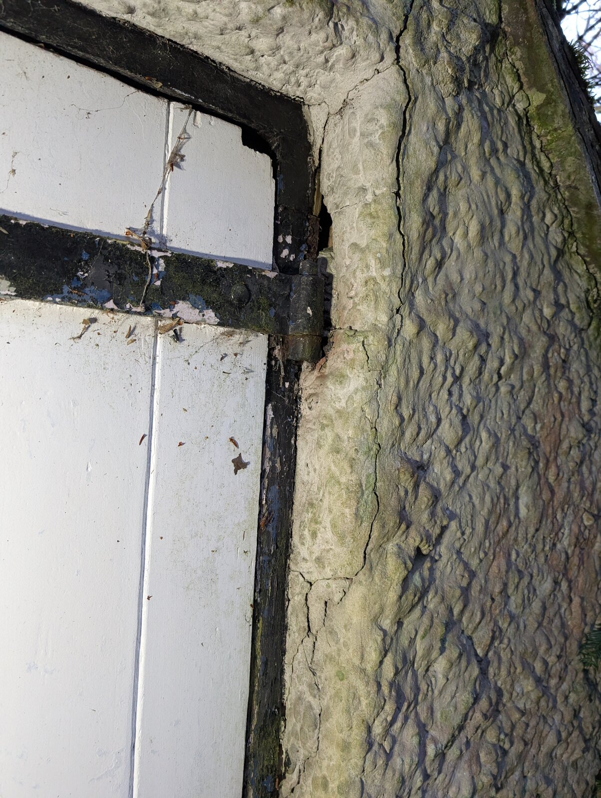

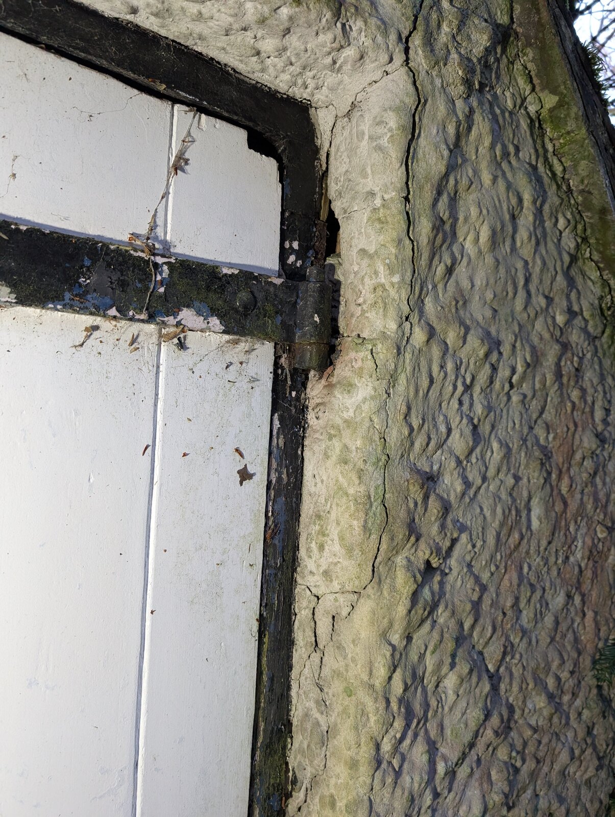

Ok, let's explore this a little bit more. Firstly, the interior wall has a hairline crack, as opposed to a 5mm crack on the outside. My assumption is that the internal wall and external wall are likely to be connected. If so, why is there also not a similarly sized crack on the internal wall?
Secondly, I have enclosed the lower hinge image, where you can see the pebbledash has come away. Also, another image showing the crack going below the upper hinge.

Perhaps just the render is falling away then. You'll be able to tell better than someone at the other end of the internet!
Try prising it off, see what happens. If it's loose it needs to come off, you can't glue it back on so you won't be doing any harm.
Surely the question is....is it still moving/cracking further? Glue some picture glass across the crack and monitor for 12 months
That just looks like water penetration and frost heave or mechanical expansion - ie rusty fixings expanding... see the black being washed out the block work... I would check the roof first.

The internal wall is probably more flexible, perhaps the wood lintel hasn't gripped the mortar so has slid instead of cracking.
The internal wall is solid brick, so I am not sure how much flex there is in it. And because they are only hairline cracks on the internal wall, I cannot see any sliding.
One possibility I see is that when the door is opened, the raised metal bars hit the pebbledash. This, over time, has led to cracking. And instead of the cracking stopping at a certain point, it has spread upwards. And then the freeze thaw cycle due to water ingress has led to a widening of the crack.
On the other hard, because the crack is wider at the top, that suggests possible movement. And so does thd 5mm width of the crack at the top, and the close location of the trees, with possible root issues causing a foundation problem.
And they are not mutually exclusive. It could be that the door hinge mechanical force has created a crack, and there is also some downward pressure due to root issues from the trees. The existing crack then means less force is required for movement to occur.
