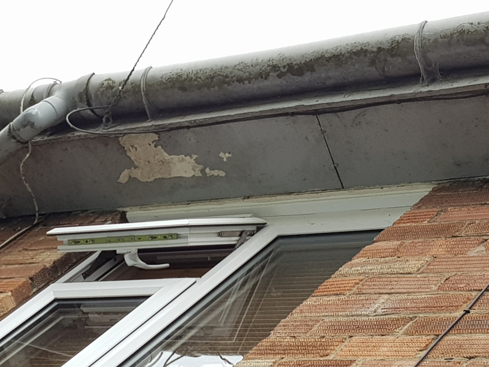

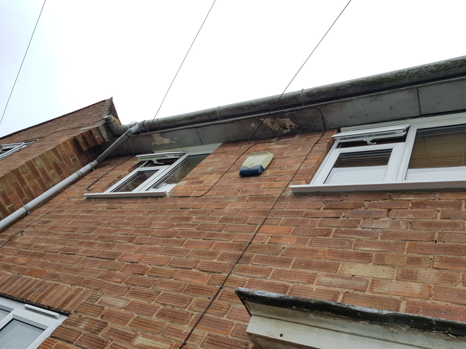

Asbestos cement was used a lot in the 50's and is pretty safe if left
My soffits gutters and downpipes were made of it.
A normal window replacement company did my soffits and gutters , taking care but not excessive protective measures. Later on I removed a couple of drain pipes and double bagged as instructed by my local council.
Then I took it to the tip and they disposed of it.
No real drama
I doubt that there is any danger from leaving the stuff in situ. It could be painted (without sanding!) but asbestos reacts with paint and tends to make the paint fall off after a bit
