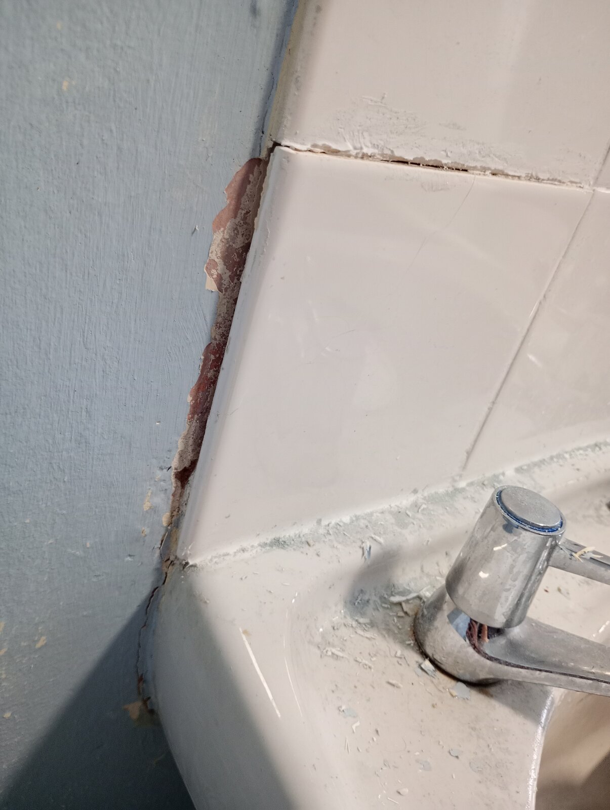

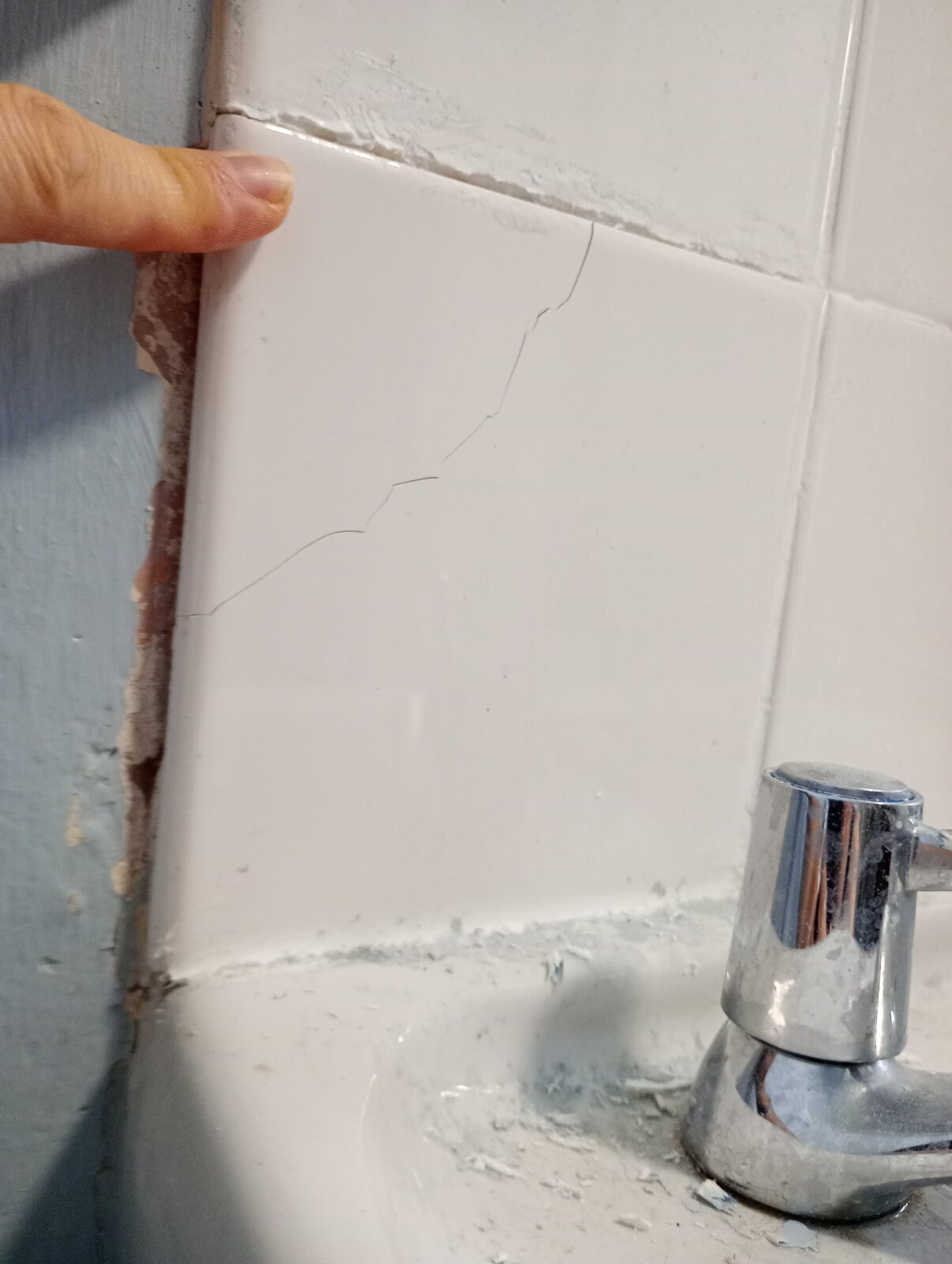

I have badly fitted tile that cracked on the edge of the basin. It sticks out of the wall and crack shows only when I press it to the wall. How can I fix it ? What do I use? Glue? Sealant?
Can I just put it under or do I have to remove the whole tile?

Depends if you want the honest ‘professional job’ answer, or the one you want to hear…….
The first answer is :- just take them all off and do it properly. They’ve not been stuck properly, grouted properly, or siliconed properly. It’s a relatively quick, easy and cheap job to do - and you’ll feel all the better for it.
Even for the second answer, you still have to remove and replace that tile. ( so you need to buy grout and silicone anyway)
