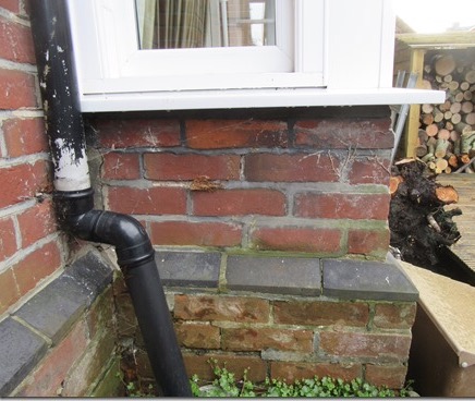

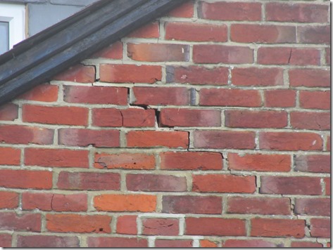

Thanks so much in advance for any help! We have just received concerns from a survey about wall movement in an Edwardian house. They did make comment that this is a common finding but raised specific concern about two points - 1) failing window arch with cracked pointing with possible ongoing movement 2) some movement with cracked air tile on corner of a front bay images attached). Can anyone offer any advice at all whether they would a) avoid like the plague 2) chill out its normal or 3) proceed with caution and follow surveyor advice?! He has recommended repointing of whole area around the window and underpinning of the front bay window - anyone have any kind of very very rough price range of what this might cost?! Im guessing significant as he advised that agreed price was too high. Thank you so much for any rough pointing in the right direction (no pun intended....) :cry:

I'd worry a bit more than that. The arches are no longer functioning and the whole panel may have moved. Stitching rods are not a remedy for this problem unless designed to form a lintel, and further investigation into the potential panel movement might be necessary.
As above - the whole brickwork panel above the central (LH) opening is dropping and a min 10mm crack has opened up higher up the gable.

The first picture shows the arch dropping to the left, and with the crack in the wall further to the left suggest there could be movement in that direction, so there may be more underpinning required. Catlad might be right in that some of the damage has been caused when the DG windows were fitted, as a lot didn't put in an inner lintel when they took the old sash cord windows out, but that would mean problems above the arch, not to the side of it, and there would be evidence inside as well. You'd need to put a strong boy under the arch, cut out the crack at the left of the arch, and then repoint with a few bits of slate jammed in the crack whilst you repoint.
Crack stitching rods will work in picture 2, but picture 1 shows broken bricks which suggest movement, so that side needs further investigation.

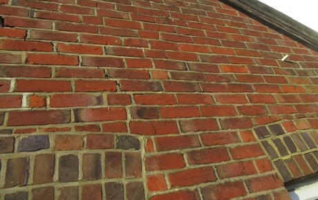

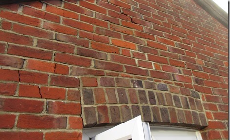

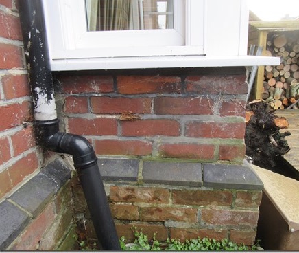

Sorry yes air brick! Ive attached a couple more photos - one of the brickwork above the window arch and the second of the bay window.
The surveyor was very thorough and he couldnt have been clearer in that in his opinion there is ongoing movement in that brickwork on the side wall above the arch. Im checking with him but I assume that has something to do with the pattern and size of the cracks.
In terms of the front bay window, he said there is the broken air brick and clear sagging. His suspicion was leakage from that down pipe has potentially caused instability in that area and needs underpinning work - exacerbated by the fact these properties tend to have shallower foundations in this front bay area. Even though it would only be local underpinning required, does this still attract the same insurance and resale concerns as main house underpinning? Seems to be such a red flag word to some people for whatever reason! Thanks for all the massively helpful advice - I am gutted but looking more and more of a risky buy!

Thanks for those Brian. The bay definitely need underpinning, and it'll be debatable as to whether to underpin, or remove the bay, dig the foundations deeper, and then rebuild it. Most bays tend to be a single skin wall, so rebuilding it would allow you to insulate it at the same time.
Exactly what did the surveyor say about the crack coming down from the roof line, and is it by any chance around the corner from the bay.
The brickwork on that bay has moved before the window was installed. If the window is still fixed, and no gaps below it, then the bay may well have stopped moving now, and is not a significant issue. Lots of houses move, move and stop, move up and down or keep moving one way. But movement itself is not a probelm until it becomes a problem.
Alternatively, the work required to stabilise a bay is relatively simple and not costly.
Cause of cracks to the walls need to be determined. But generally, if the cracks are not showing on the inside, then foundation movement is less likely, and are easily repairable. They are not related to the roof, so the cause is either foundations or the arches, or a bit of both

Thanks - sounds ominous! here was the comment about the roof line (this is the house rear, away from the bay, doesnt appear to go around the corner)
"There are two areas where some noticeable movement has occurred and this appears to be on going and needs to be investigated further. On the rear elevation , over the rear bedroom window there is some window arch failure. There is some evident cracking in brick work around and above the window arch. Though quite common in properties of this age, cracked pointing needs to be thoroughly raked out and replaced in the short term"
He feels the movement is ongoing due to the size of the cracks and this is obviously a big concern

I don't think I've ever worked on a job where a single storey bay was underpinned, as it's normally much easier to take it out and dig new footings and rebuild the brickwork.
