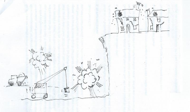

Tony1851 - that's a fine drawing, but not wholly accurate.

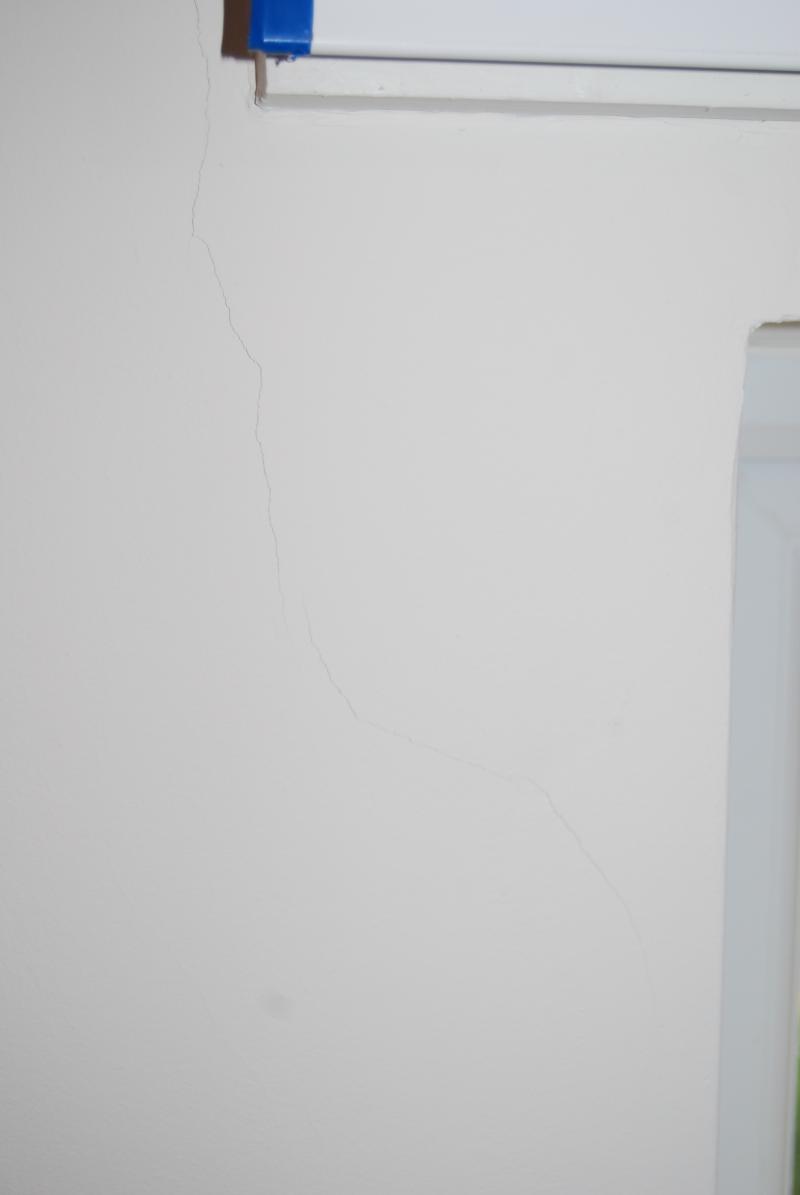

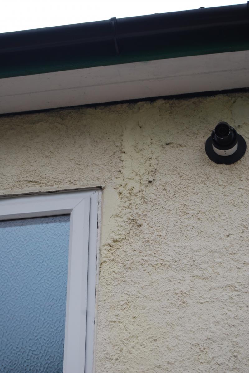

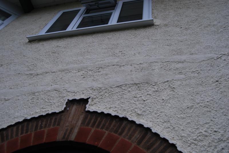

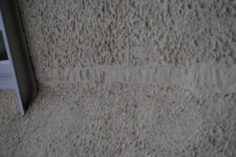

Here are three images. First one shows horizontal crack on front. Second shows typical crack from window. These are present on all upstairs windows, and all run from the middle of the side rather than the corner. The third shows the inside of that crack.

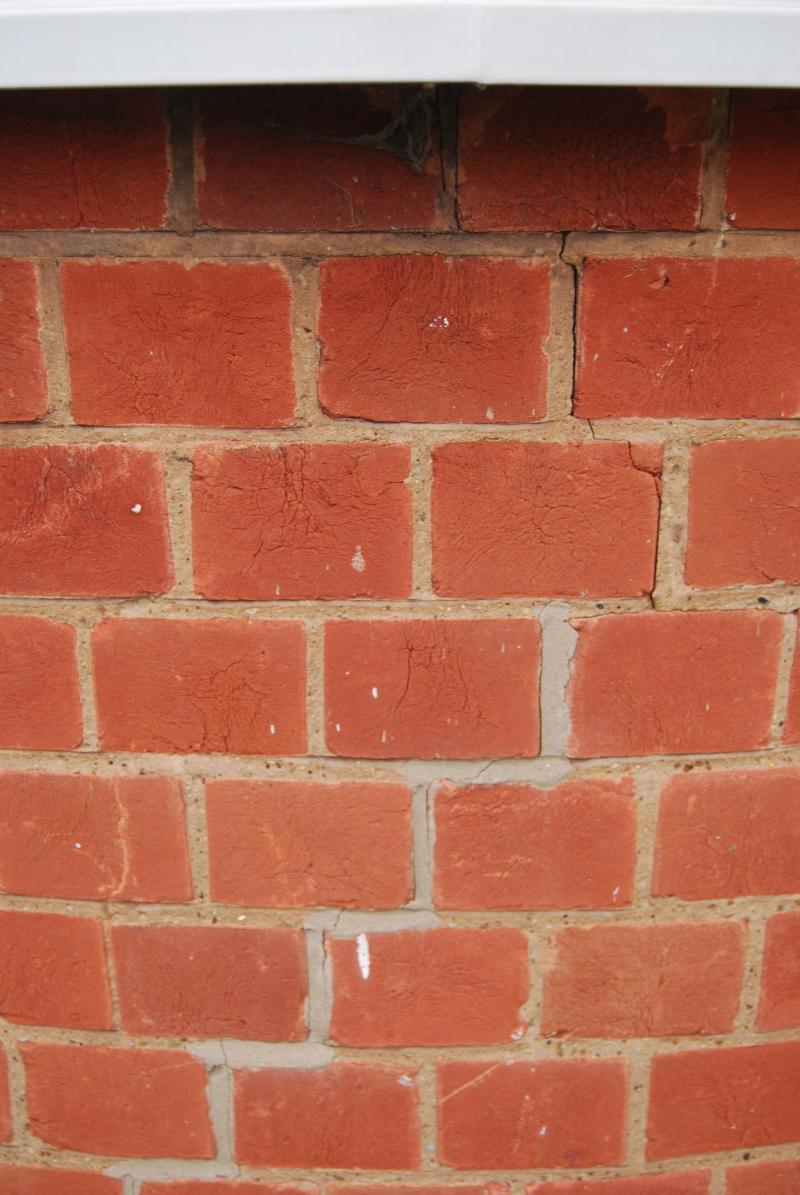

These two are of the bay window. The first is the brickwork on the ground floor and the second where the bay joins the house (sorry its the wrong way round). I think this problem is separate to the others, caused by either subsidence of the bay or faulty installation causing the bay to detach from the property.

Quite often the bay pulls away from the main wall slightly because the foundations are usually not as substantial as the main house foundation.
The horizontal cracks above the front door suggest expansion of the bed joints in the brickwork. Is it a cavity wall? If so, the expansion could possibly be caused by corrosion of the wall ties. Less likely might be sulphate attack of the mortar, though this would have been caused by prolonged dampness, which would be unusual in that position.

(No offence intended by the sketch!).
It does seem that the render cracks are more to do with poor previous repair than anything
Once a building cracks there is always a weak point and rendering and plastering over cracks leaks to cracked render and plaster later
The horizontal render repair does seem similar to a previous brick stitching repair
The crack to the bay is a sign of movement which is common for this type of bay
