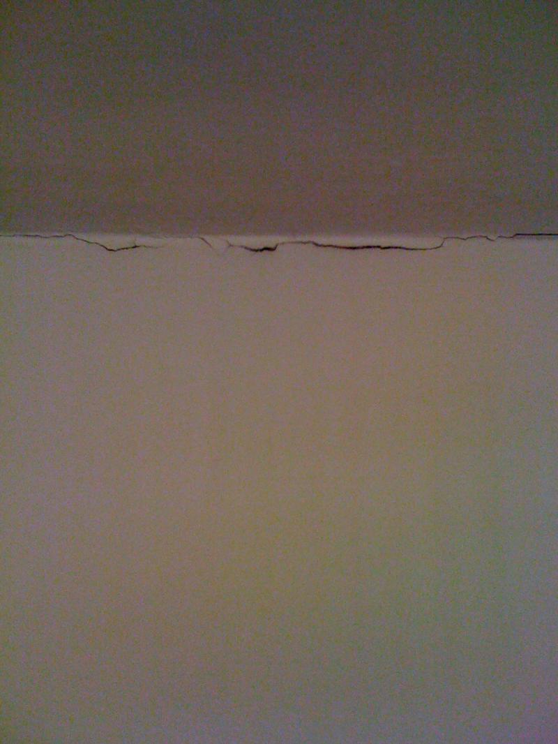

Cracks in kitchen
Flexible filler, but wont last forever.
I normally tape joint repair the cracks in wall and ceiling angles, using self adhesive jointing tape and jointing compound.
But I would rake back the joint first.
What kind of jointing tape would you go for? seems to be a few different types
