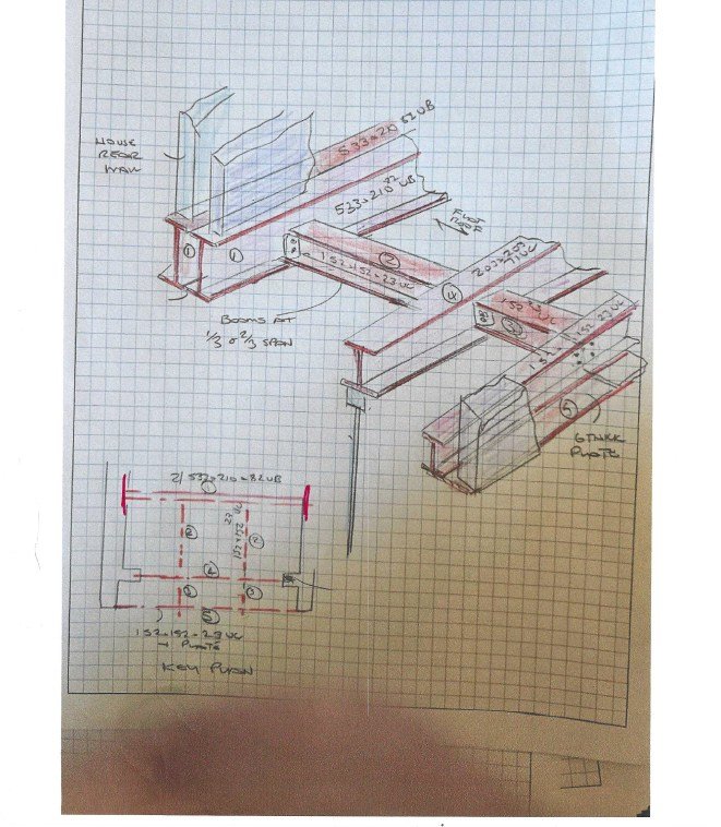

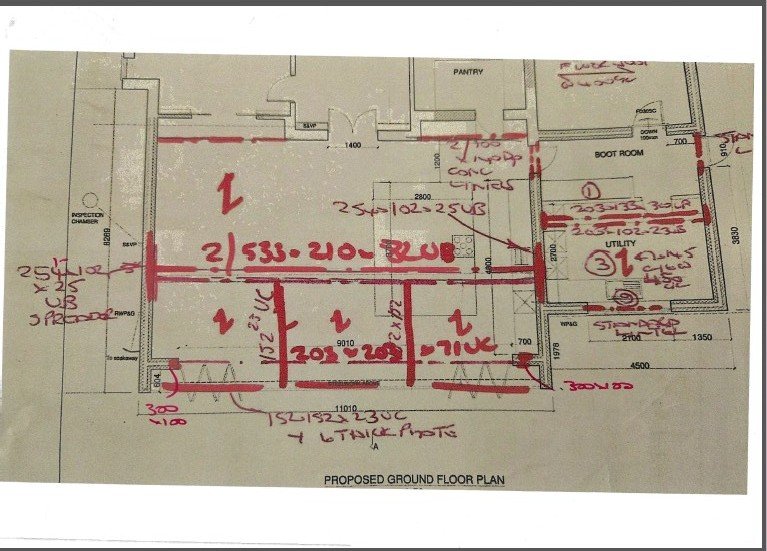

I have copies of the SE calculations but I won't post them in case this matter progresses in a more formal direction. But these images show the size of the 2 large beams in the Bifold area and the double beam holding the flat roof which you can see on earlier photos.

152mm x 152mm column spanning 10m! :oops:
Sorry, I’ve lost track. Are these from your original SE, or are they from the builder’s SE?
That drawing may be out of date as I measured that outermost beam when I was onsite as 180 x 200 and the one over the Bifolds I measured as 205 x 210 and the Double beams are 530 x 210
