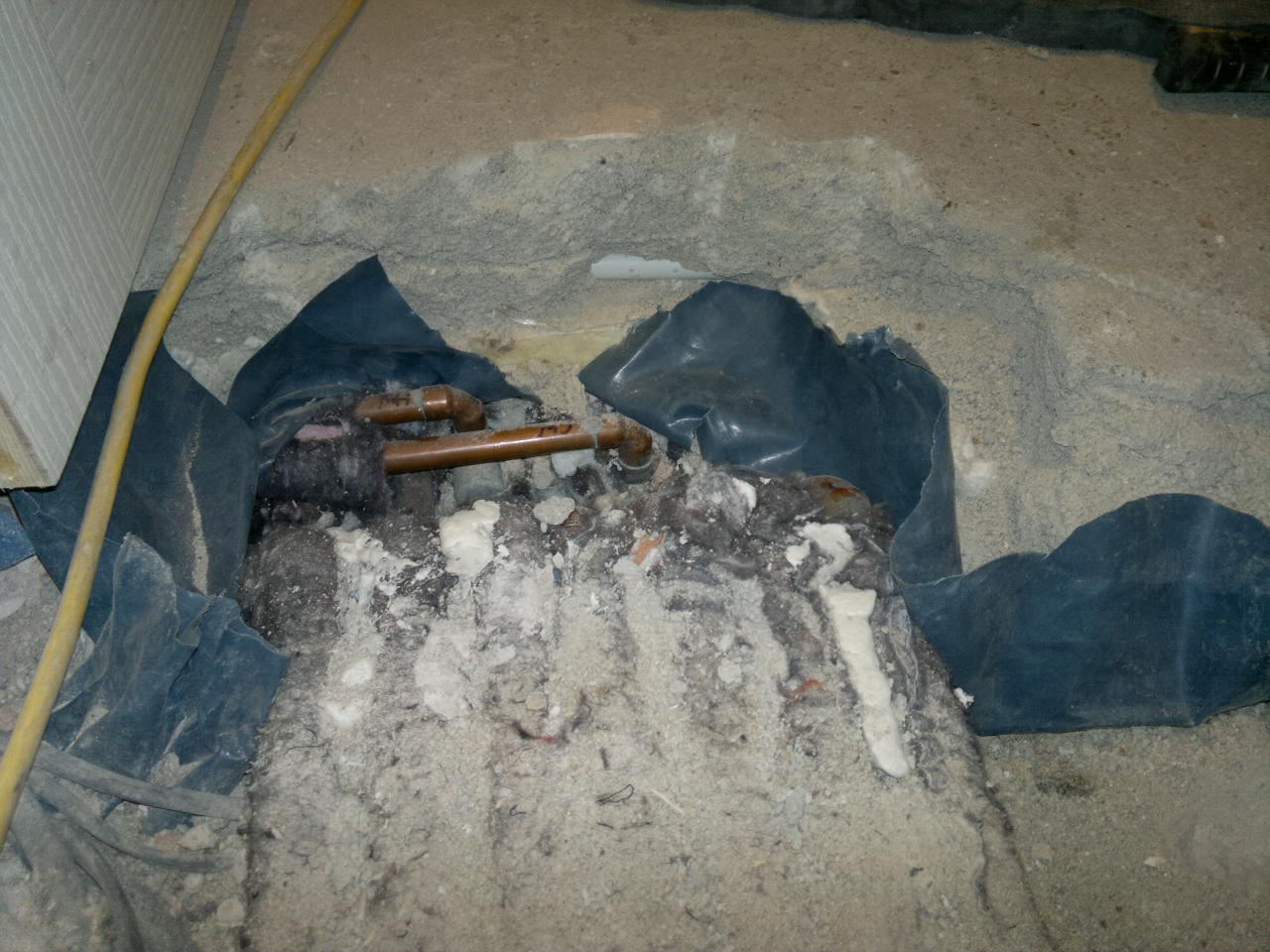

Creating access under UFH, set in screed.
I've made a start ... working in from the edge ... decided push fit's are going to be best suited to cap off the 3 pipes, will foam over and cap with 18mm ply, in case access is ever needed. Have one pipe in middle of screed to cap off, will use thermal imager once heat is running through the PEX. Will post up more picx as and when.
