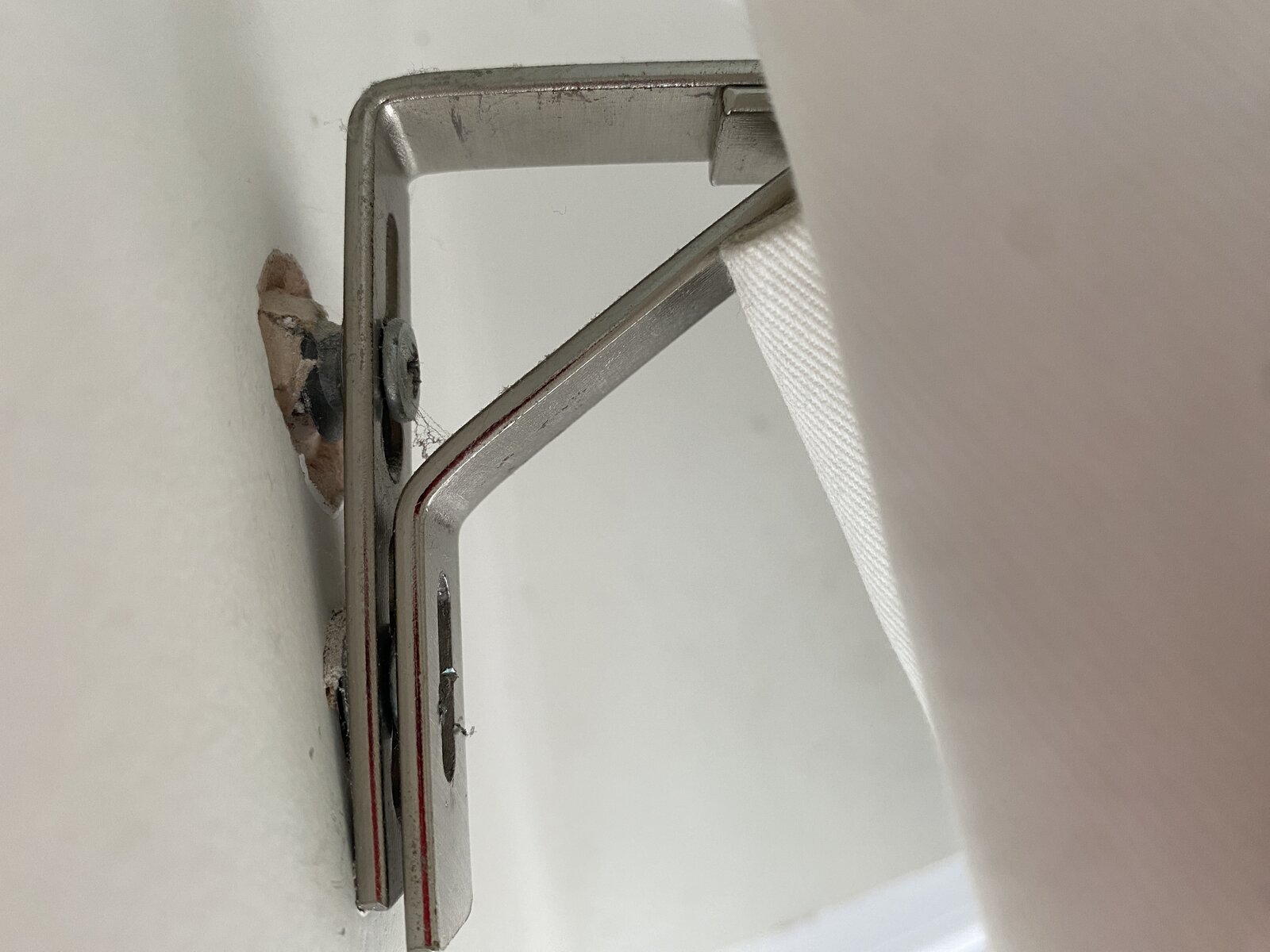

Okay, here is a question with a view to being lazy...
I have three curtain connected rails in a Victorian terraced bay window (tall).
Installing, in 2013, was... a learning curve... hitting all sorts of hard stuff... lintel of concrete and steel, I'd say. It was like a journey to the centre of the Earth.
Fast-forward to 2022, and most plugs are coming out.
I think the options for fix are...
1. Use same holes, bigger and better plugs.
2. Drill new holes, avoid the steel bit of the lintel
3. Drill new holes, avoid the lintel altogether
4. Wooden batten for extra stability - secure to wall and the batten.
5. There's this weird online article where she glues a batten to the wall (!) - but I expect it is a lightweight rail and lightweight curtains.
Anyway, in my four walls, someone raised a lazy option of which I'm dubious...
6. Re-establish the rawl plugs in-situ by caking the hole with something like GripFill Xtra (I mean, if it will stick a brick to a wall!).
Personally, I'm suspicious this could work to provide the stability necessary.
Any thoughts?
Thanks.

You have used "easy drive" fittings. they are designed for plaster board, that said, image number 1 looks like plasterboard (I can see the paper).
I suspect that you have dot and dab plasterboard. You need fittings that have a sleeve that will go through the dot and dab and support the fitting through the void. CoreFix is good but expensive.

You did not mention plasterboard if that’s the case you used wrong wall plugs and will need to replace all .
How deep did you drill? How long are the fixings?
(I can see that in both cases the short answer is "not enough" but what is the measurement?)

Thanks, all, for the replies. I had no memory of them being plasterboard fittings. I'd tried to wipe the install from my memory, actually.
I think maybe using plugs that are a) fatter and b) appropriate would probably be the least-intensive option.

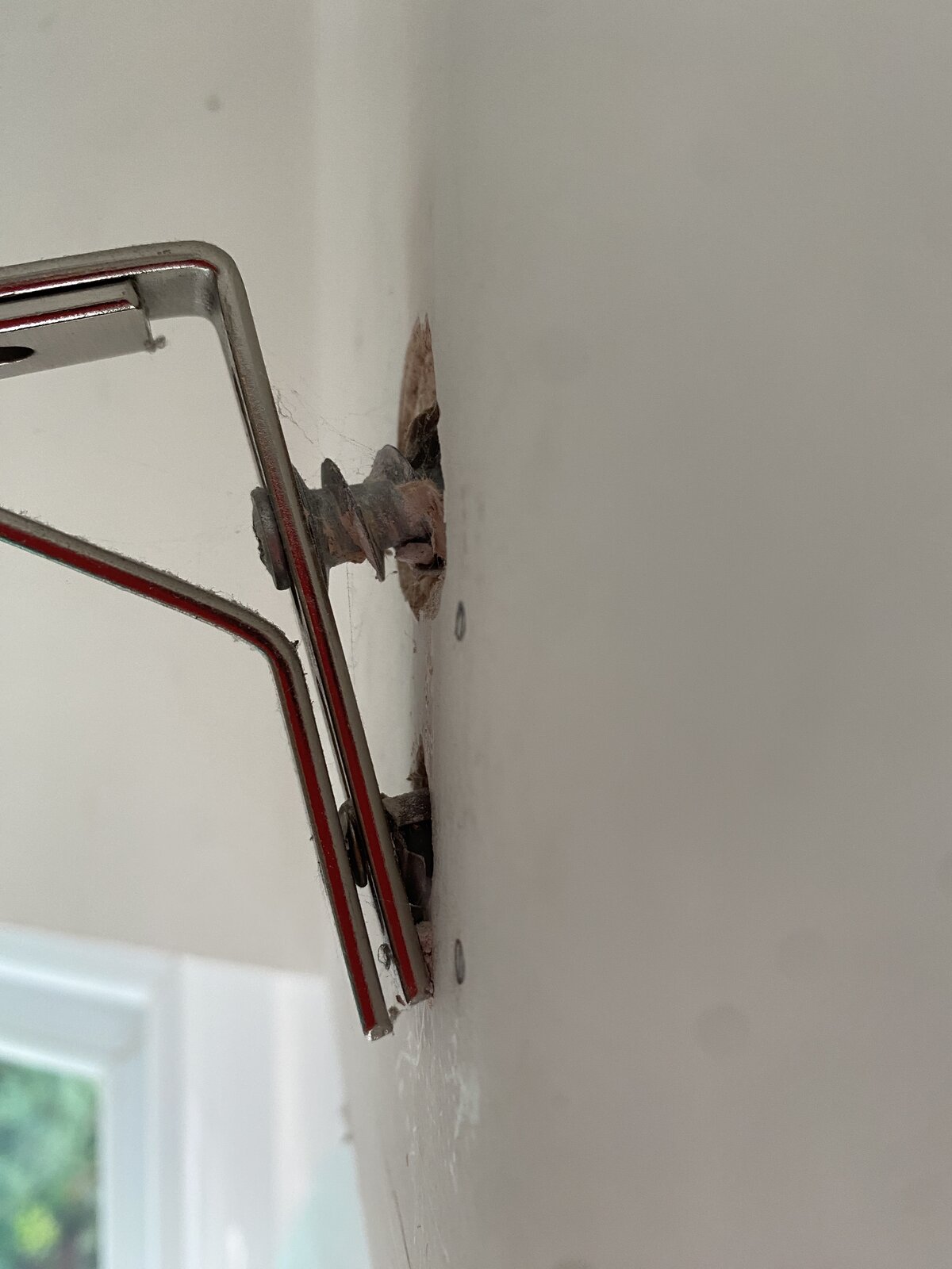

There may have been some method in my madness using a plasterboard plug those years ago...
- The top surface is some kind of board, depth of maybe 2cm.
- Behind that is a space.
- Behind that is some bona fide kind of more solid surface, which the screw never went into.
So my wall plug was only ever held in through the depth of that board, and not the maybe-3cm behind it before the real wall. Otherwise, it's a bit cavernous. Probably the board is propped out from the real wall surface behind by some struts at either end.
For some of these holes, the diameter of the holw we drilled is pretty wide, about 1.5cm.
What should I do? I'm thinking...
- Some kind of piped/aersol fillter on a nosel/tube, filling the hole and a bit of the surrounding area? Then get a new plasterboard fixing into the dried filler?
- Some kind of winged plasterboard plug contraption that would pull back against the top board? Sounds elaborate. Only about 3cm depth for it to open out in - not as if it has the depth of an actual stud wall. These come in all sorts of exotic shapes, right? I've previously used a couple o different types but which were deeper because I had more depth to play with...

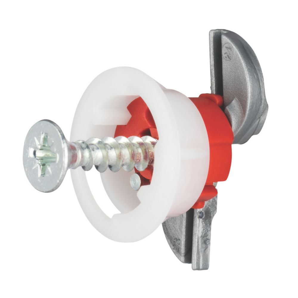

Something like...
GripIt - but in the correct dimensions
Or maybe a Rawlplug Interset type fixing? They hold better than the plastic plugs and don't require a special large drill bit like the GripIts do. If you are doing a lot they are best installed with a setting tool
I've used similar before in a proper plasterboard wall - nice and strong.
But I think the space I've got to work with is all of 3cm deep and, with what product apparently 38mm deep, I think it's probably too long.
Also, I suspect that my hole is wide enough that there'd be nothing to anchor those front-side teeth into.
