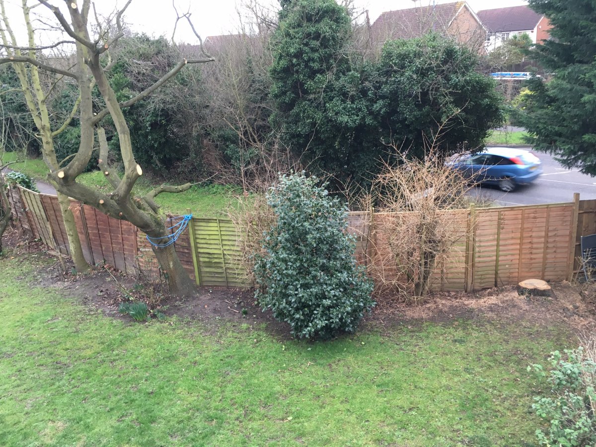

I'm looking to replace my fence with concrete posts and gravel boards. However the fence line has a slight curve due to the irregular shape of the garden plot.
I'm planning on putting the first post in, board, panel and then post however I don't know if this will hold the panel securely when it starts to curve.
Does anyone have any advice?
For a small amount of curve it won't matter as long as you align the posts well. For more of a curve you will need to chamfer the sides of the panel.
