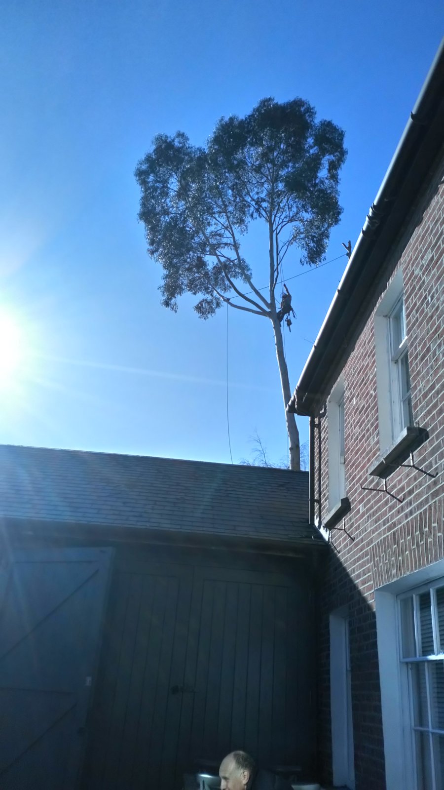

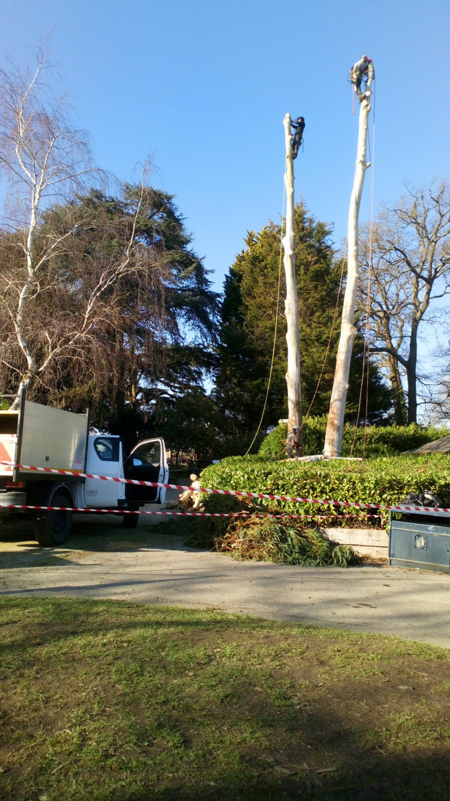

Was watching some maniacs (tree surgeons) cut down these massive trees. They trimmed the branches upwards then started cutting the trunk down in bits from the top downwards. I personally do gardening and have been asked to cut smallish trees down. Is it a similar principle

Smallish trees not the ones in the picture. Different totally. Bow saw at height and chainsaw at the bottom
You dont need to cut down in bits like the pictures, for small trees.
They are doing that so the short sections of trunk that are being cut are falling in a safe area. Esp important in public spaces.
If you look at the pics there is nowhere clear to fell those trees. If trees are felled or branches cut and they snag on other surrounding tree, apart from damage it creates problems with branches under tension and risk of unpredictable movement.
I cut down a 20 foot tree at my brother's house- trunk was maybe a couple of feet across at the widest. I am used to working at height .
Basically the same process- trimmed off lower branches and cut them up to save space, using the branches above as tie off points so they could be lowered down. Retain any branch "roots" so the V can used to run ropes. At some point, as you get higher, you need to tie off in the middle and cut higher branches, using the lower branches as pulleys.
Once you just have almost bare trunks you start to tie off higher trunk sections, small enough to handle, and lower them in sections.

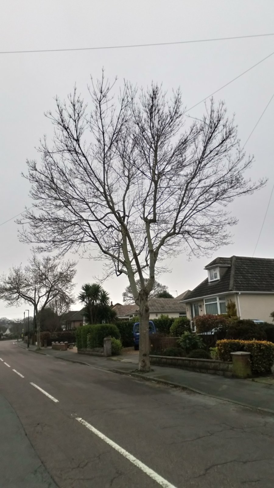

This is the size I was thinking of cutting down. Or smaller. Was going to do a chainsaw course and get all the safety equipment. Use a good bow saw for top bits. Maybe get a harness for extra safety. Chainsaw on the ground for trunk. I've heard swinging branches have swung back and broken tree surgeon's backs in past.
