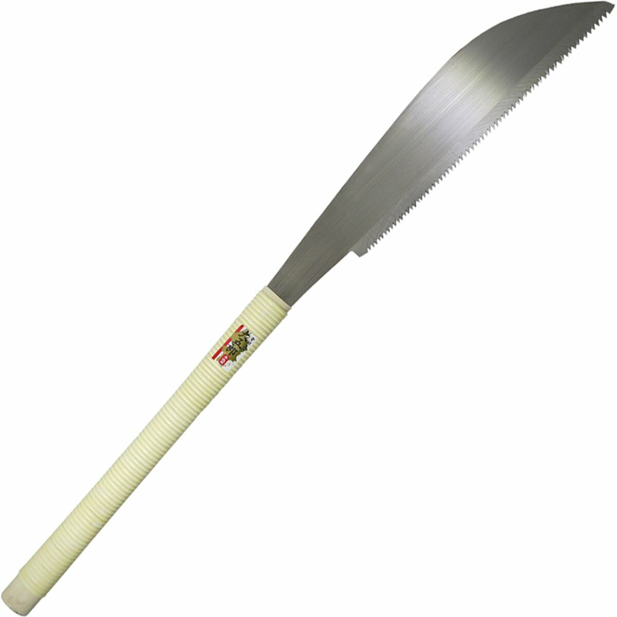

I think that saw set would be for doing a tenon joint on the sleeper and making a coffee table of it.
The teeth are too fine.
You'll need at least a Ryoba 300mm which has large teeth at 7 TPI, or for a bigger size it will be an Anahiki type which is specifically for rough timber.

Proper Jap saws have thinner blades, but they are also nickel-coated and this makes them smoother and more slippery, so less friction. Also the teeth set, size and grind is different to western patterns so this adds to less force required too.
A pull saw without these specific features is just pulling not pushing and does not have any advantage.
You need to learn learn not to push down on the back-stroke, and it takes a while to master as you tend to try and force the saw forward if you are used to western saws.

As to Japanese saws, I'd say good luck getting one which will cut medium to larger sizes at any speed. I have a few (not for site work, though), and whilst you can get quite reasonably priced bench joinery/cabinetmaking scale saws readily, just like with Western saws half decent fast cutting saws for either ripping or crosscut work seem to be pretty expensive. The biggest/coursest I have is about 300mm long and 9tpi and against a traditional western 26in 5tpi crosscut it is quite slow
