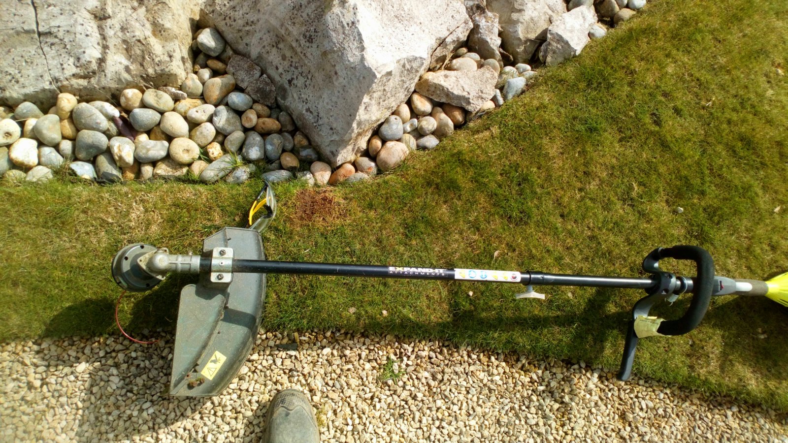

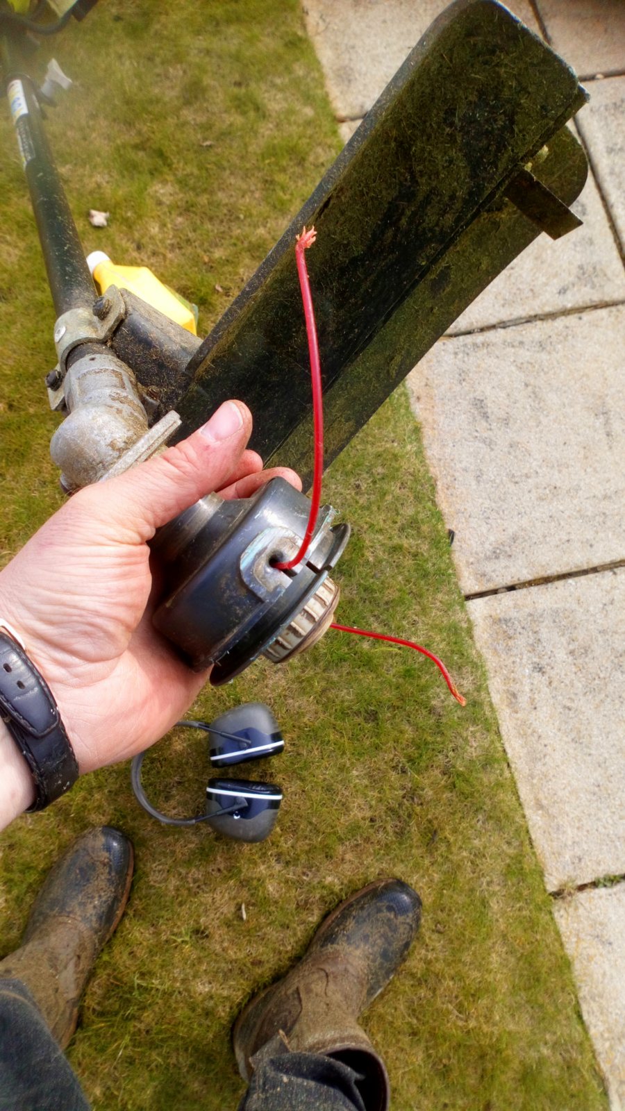

Got a Ryobi multi thingee with strimmer head but when the cord comes off a new bit doesn't come through. Can u cut edges of grass butting up to walls with shears?

Sort out the strimmer head, it's the best way to do edges believe me; but do it gently and carefully otherwise you'll go through the strimming wire like anything.
Try a nylon cable tie instead of the trimmer line- trim to length with scissors
on my ryobi strimmer you just bump on the ground whilst running to feed out the cord

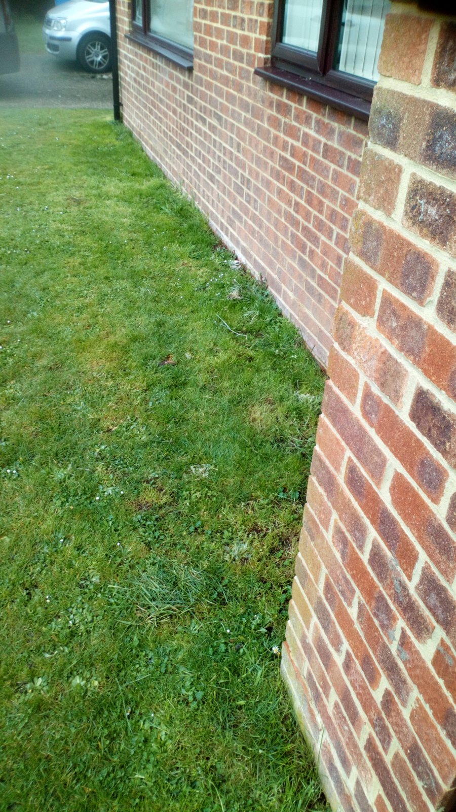

As u can see I took out a bit of the lawn. Is there a technique u can use to A) not touch wall and waste line B,) Not damage grass?

now and again, but I have used the shield as a guide against a wall to get the correct distance

In my experience the strimmer will be more gentle on the grass and will wear the line much less quickly against the wall if you don't use full throttle. It is surprising how slowly you can spin the strimmer whilst still being able to cut the grass effectively. You do need to spin it fast enough to straighten the line though. One of those things where plenty of practice is required.

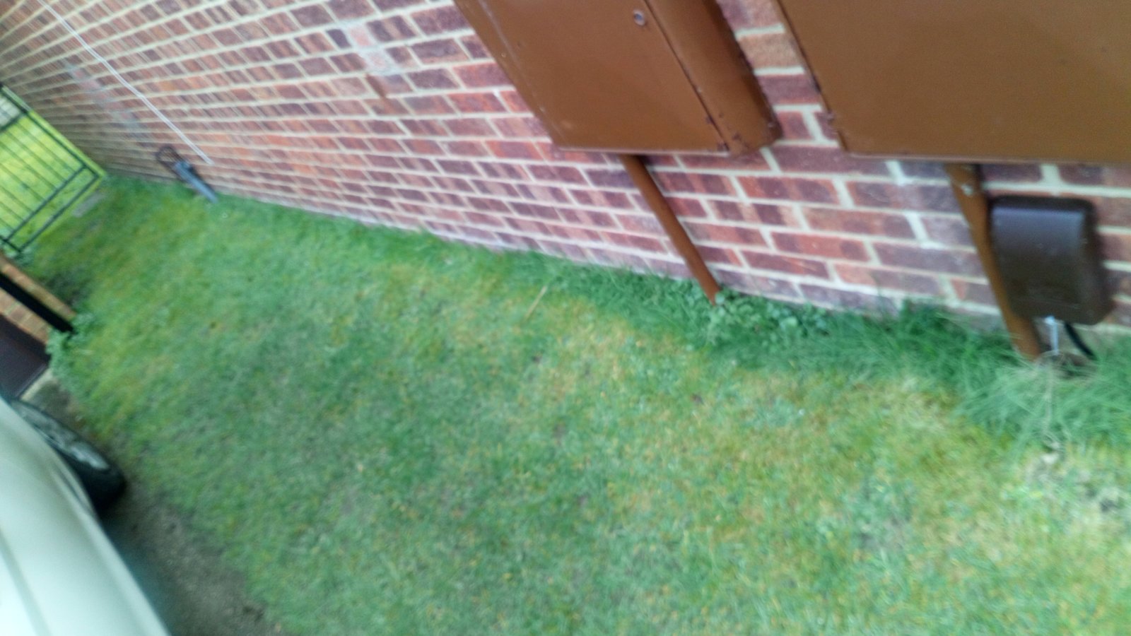

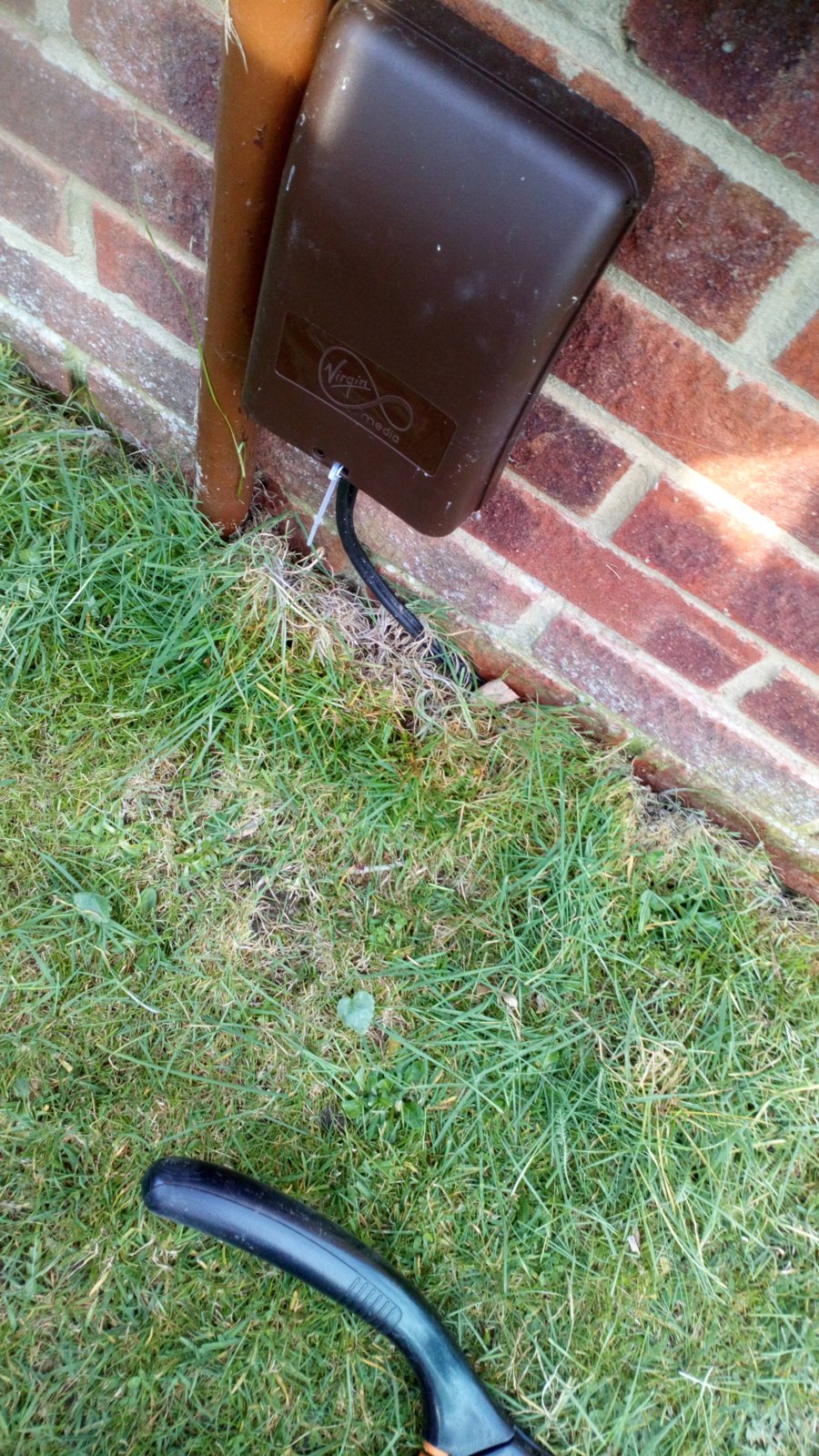

I wouldn't use anything stronger than a strimmer wire around your electrical and gas meter boxes/pipes - mixing such with that angle grinder idea could be disastrous :eek:. Practice with the strimmer is the answer, and accept the fact that strimmer wire wears down - its a pain-in-the-butt part of life I guess. Nice looking strimmer by the way - I'd happily swap it for my auto-feeding £30 Black & Decker effort ;)
Edit - I see your's is supposedly auto-feed... maybe the wire is wound the wrong way? (I did this and it didn't feed)
Not only the gas meter but there are virgin media cables which previous gardener cut. I was thinking protecting the cables with a plastic tube or something
