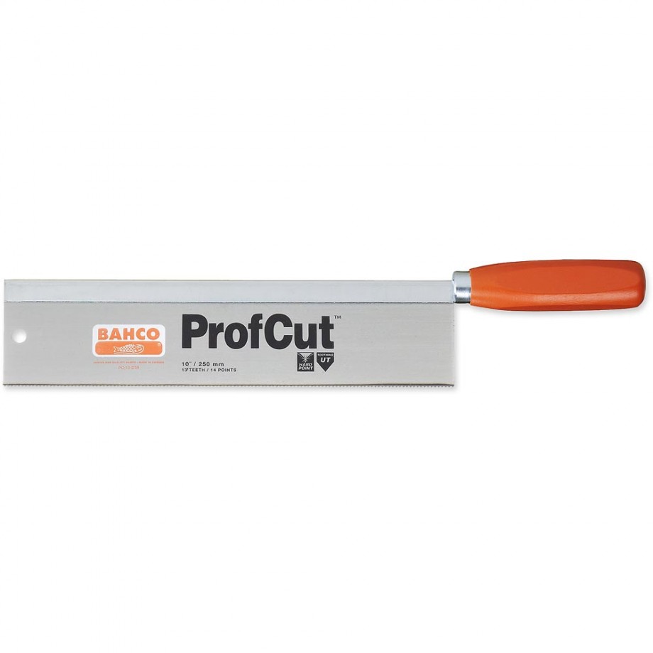

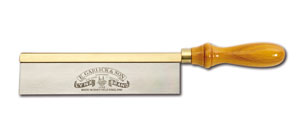

That is not a fine tooth saw. You need to use something more appropriate to the scale of the task you are undertaking like a gents or beading saw:
which will have a 6 to 8in (150 to 200mm) long blade which will have 15 to 20 tpi. Alternatively a small dovetail saw:
will work just as well, or something like the Japanese-style flush cut saw I linked to above. The teeth need to be small enough that you don't end up ripping the wood apart

Rather than that saw you will be better with a finer tooth saw. You go by the "point count" and that one is 12 points.
This one is 16 points https://www.amazon.co.uk/Bahco-PC-10-DTR-Dovetail-Right-10in/dp/B0001IX8NC/ref=sr_1_5?crid=3KOGIUWQS8V6I&keywords=tennon+saws&qid=1554283514&s=diy&sprefix=tenn,diy,171&sr=1-5 but you may not find much use for it after this job unless you do a lot if DIY.
So I would suggest a tennon saw which would be more useful for other jobs after and come in fine tooth versions. Like this 15 tooth. https://www.amazon.co.uk/Spear-Jackson-B9810-10-inch-Predator/dp/B0043YJB4K/ref=sr_1_6?crid=3KOGIUWQS8V6I&keywords=tennon+saws&qid=1554283514&s=diy&sprefix=tenn,diy,171&sr=1-6

First one is too big, too coarse a tooth - second one would be far better (much more like a gents saw). You need a very fine tooth, probably 18 to 25pt and minimal side-set of the teeth to avoid massive break-out on small timbers
