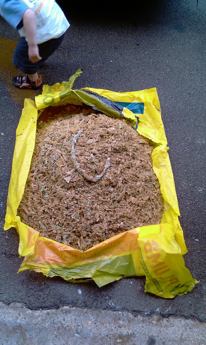

Is there really that much sediment in the bottom of a cylinder? For DHW?
:P I got softened water dude .
 8)
opps - that picture was bigger than i though :lol: :lol: :lol:
