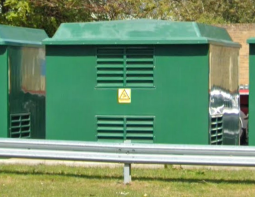

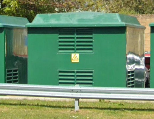

As a subby, In a workshop we fitted out a fibreglass cabin, this sort of thing:
to be sited on a roadside. The electrics as fitted by the company electrician consisted of about 32A 2p RCBO, 6KVA 55-0-55 transformer and a 'domestic CU' with single pole MCB's to feed the plant and several yellow sockets. I mentioned they should be DP and was told to mind my own business.
Not satisfied I went to the boss who also didn't understand and had to demonstrate my concerns.
I demonstrated a plug with a short length of 1.5mm² yellow flex and shorted blue and gren/yellow on the end, I stood there with the manager and the electrician watching wires overheat and smoking. In that system the potentil secondary current is more like 120A on a circuit designed for 16A before any hint of a primary overload.
Electrician was told to change the CU to accomodate 2P MCB's and repair all the damaged wiring, but worse they had to 'do a recall' job and travel round doing the same thing in previous cabins installations
