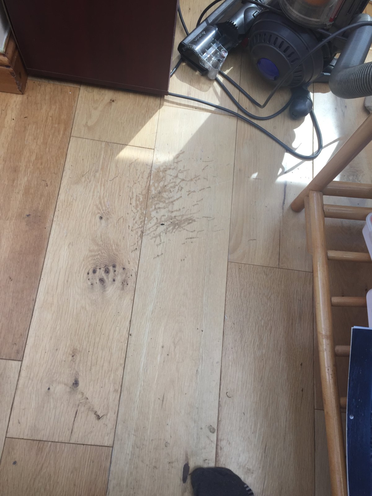

We have engineered wood floor in conservatory. Cleaning yesterday and noticed scoring where chair had been moved back and for. Is there any fix for this, short of replacement?

Place a damp/wettish cotton cloth over it and iron briefly with a hot iron, remove, reapply etc.. until the dents come out. Allow to fully dry. Use very fine glasspaper (240 grit or finer) to remove scuffs and apply the correct oil/varnish sanding between coats.

Been unwell for last few months. Now want to get floor done before in-laws come down. Floor was put down about seven years ago. How would I find the correct oil/varnish combination?
Ta
Unfortunately, that's the million dollar question. Since it's original colour, it's had 7 years of wear and UV light so finding an exact colour is by luck.
I've put many a wooden floor down but never had to varnish/oil any. Only once I found out which oil the manufacture had used and bought a tin for the customer. It was an OSMA oil. But then, you have the choice between Matt and Gloss etc.. finish.
