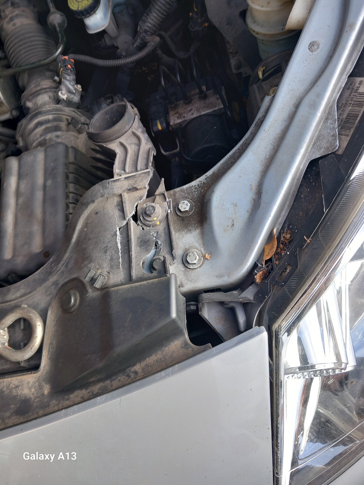

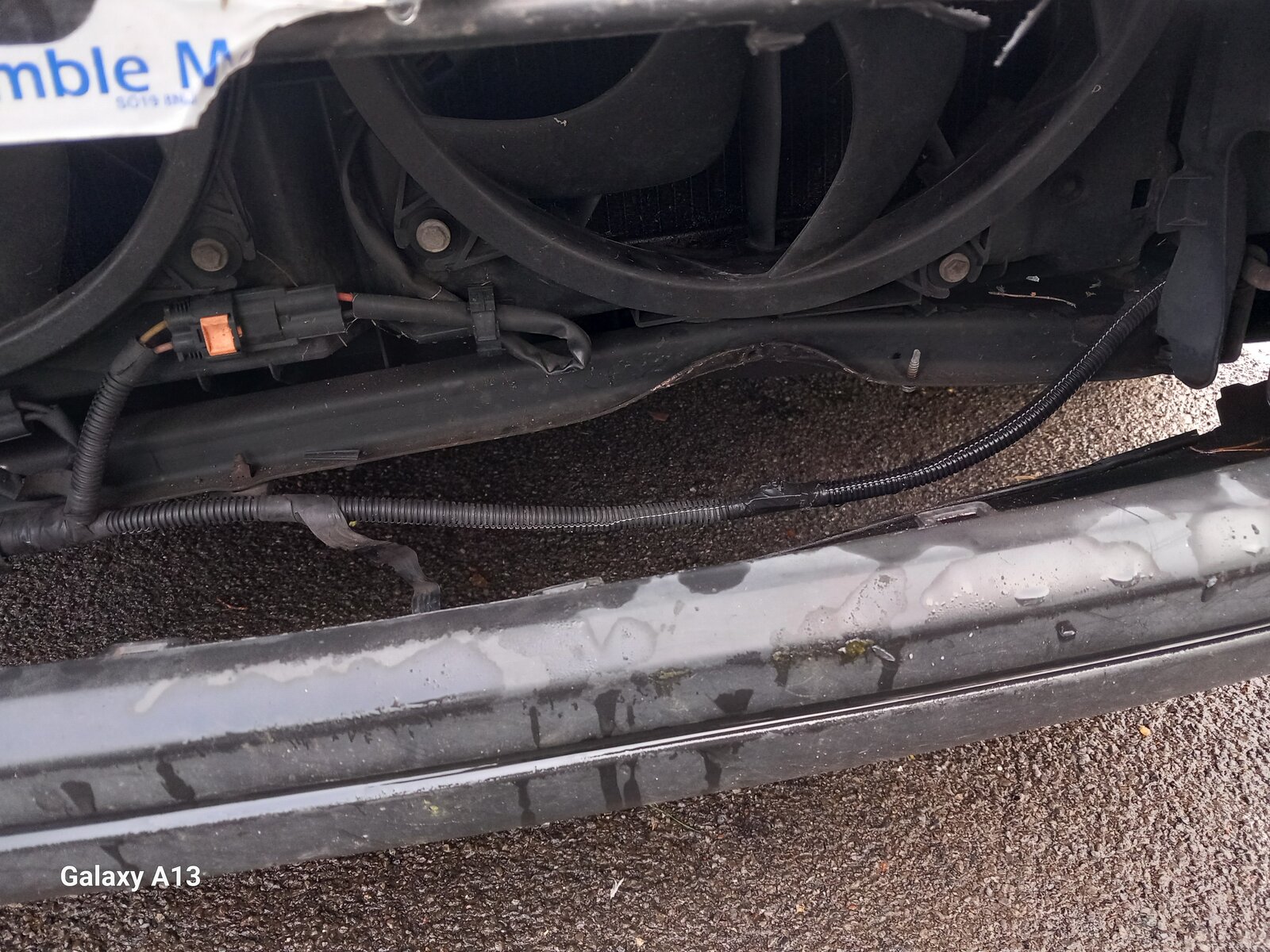

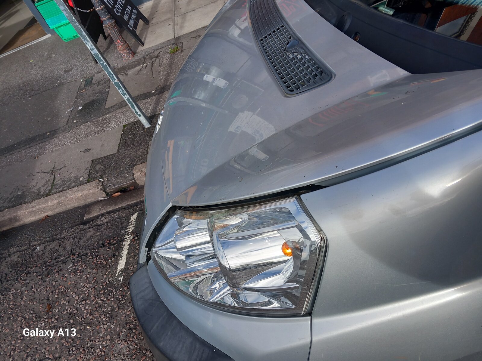

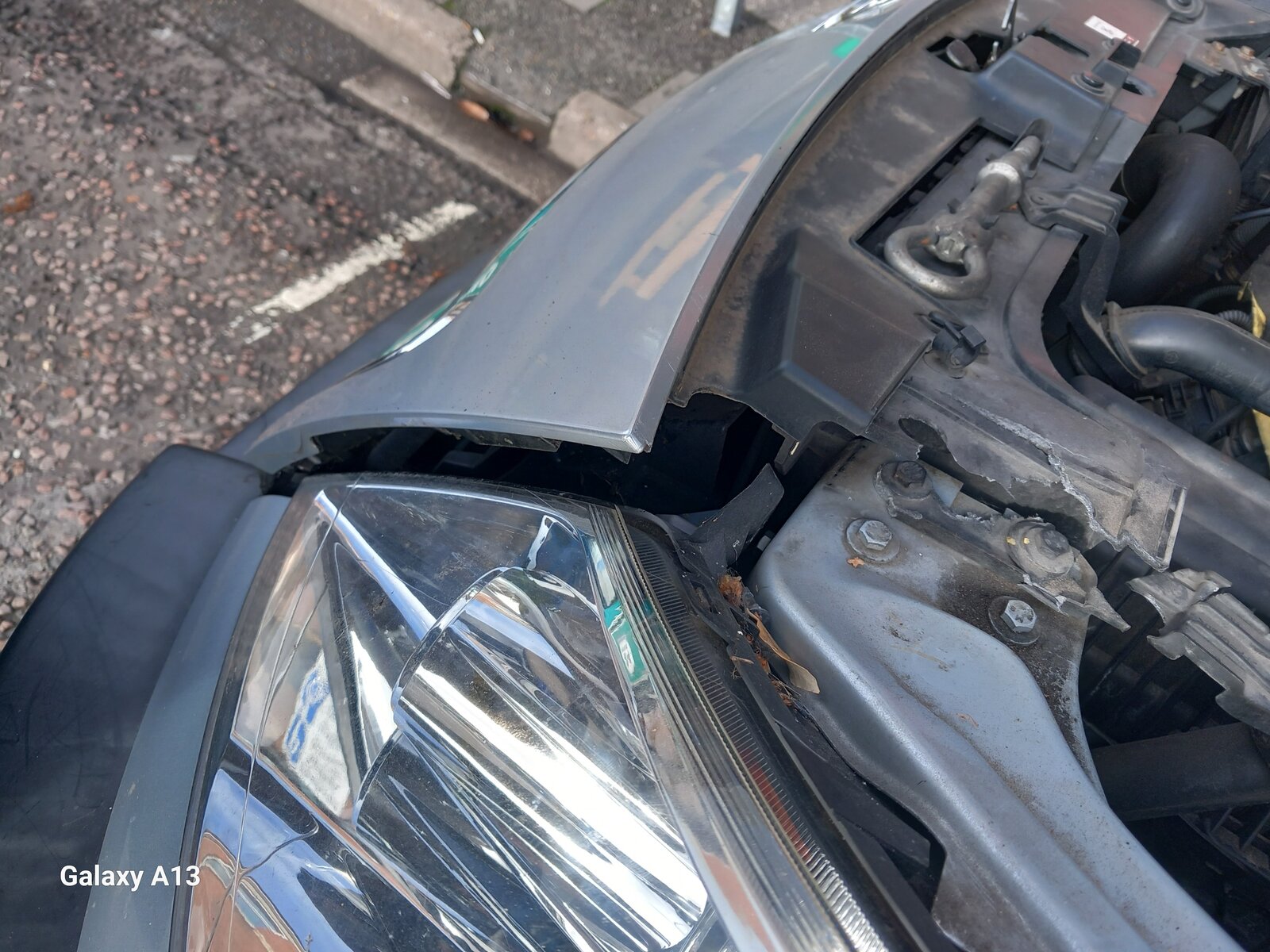

Hit a bollard. My mechanic has looked at it. Said if I went through insurance it would be a right off.
The header tank was empty! Worrying. But haven't checked it for weeks so dunno if it's a previous issue or this prang. It was leaking after they changed clutch then seemed OK (2 months ago).

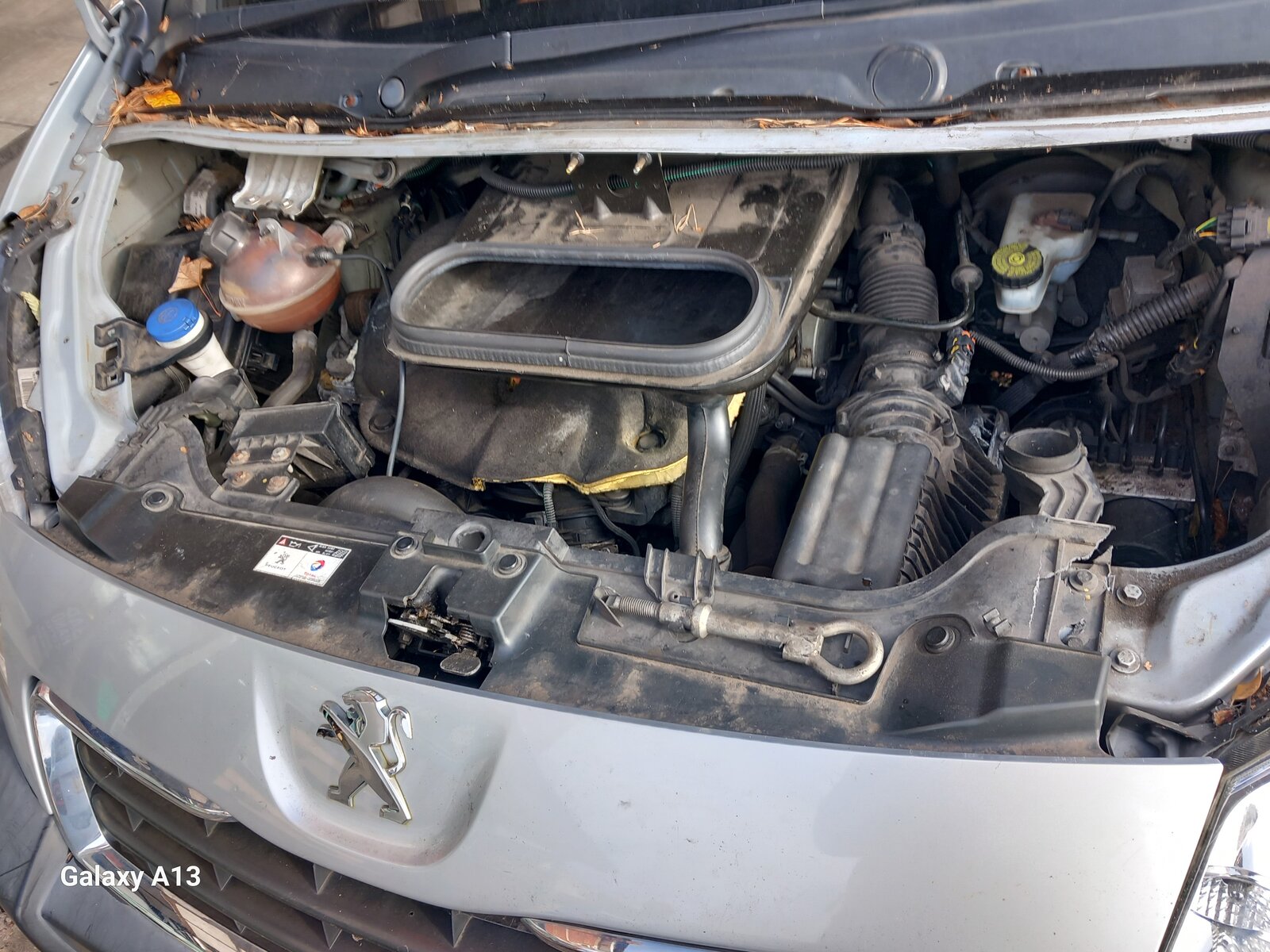

The radiator bar is massively bent. And front plastic panel has been pushed forward so it's hard to open the front bonnet and he said needs replacing but from a quick look the radiator looked ok. Filled it up header tank and radiator wasn't spraying water which is good. Got to monitor header tank though
Need to get on eBay and order a radiator bar and front panel so I can take to him to fit. He's a good guy and is trying to help me financially. Peugeot expert 2013.

Quite a biff, that!
The plastic bit looks as if it would be fine, but the bumper bar may be from a face lifted van and therefore we can't tell if it's right or not.......you'd have to get the old one off and compare it as best you can.
It does look as if the radiator and fan have got away with it though.
Consider using a local body shop and factor for your parts......it could save a load of time if you bought the wrong bits. Even a genuine Peugeot bumper bar may not prove prohibitive cost wise.....and it will fit.

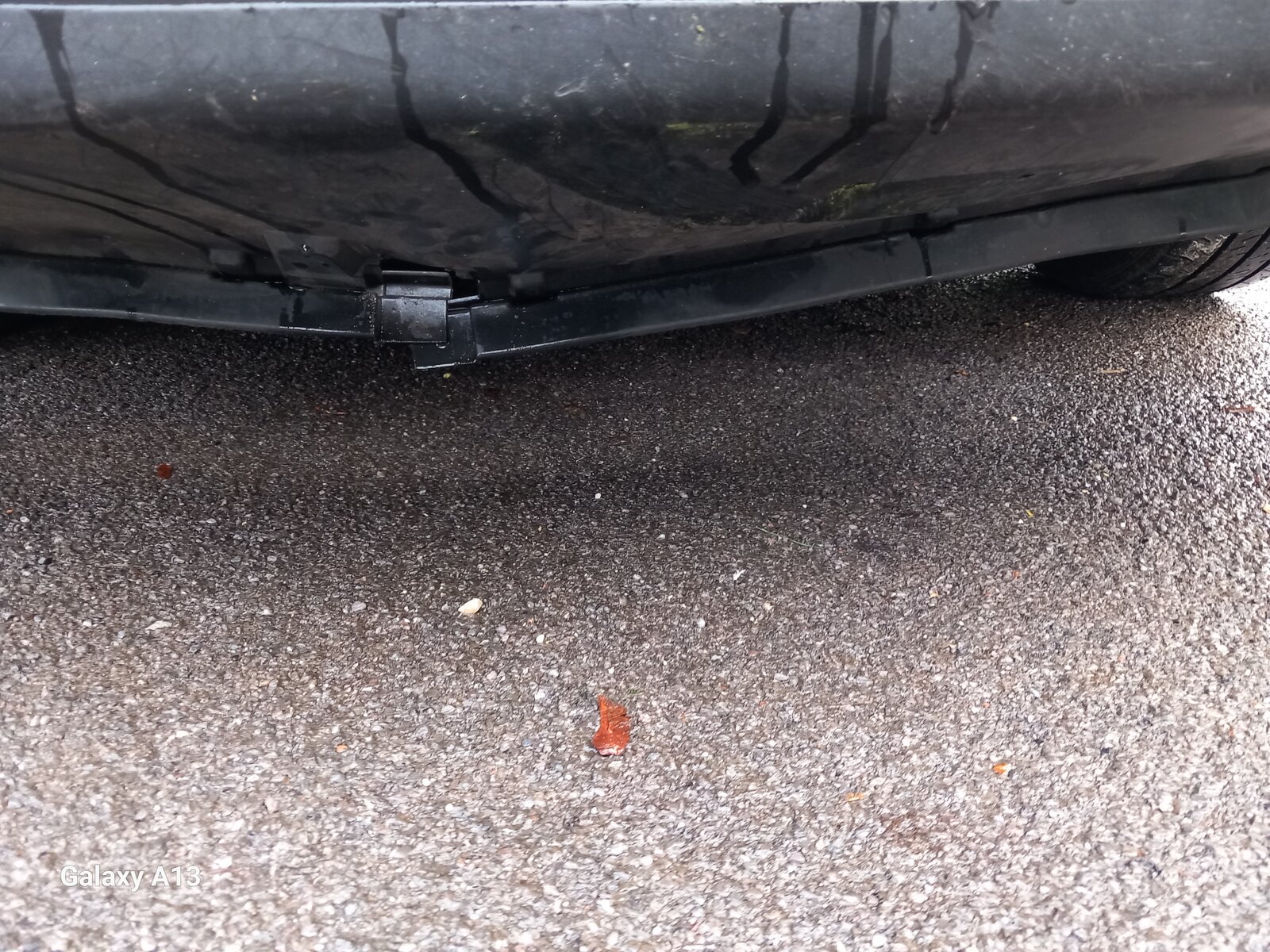

The black plastic beam running across the top, between the headlights, is often referred to as the bonnet "slam plate", I think.
The plastic trays under the car, I'd try "undertray".
The big, curved steel beam immediately behind the front bumper, maybe try "front crash bar" or "front crash can" assembly, (if it's damaged).
The frame at the bottom of the radiator - maybe try "radiator mounting subframe / frame"?
That's awesome thxs. I'm currently driving around in it. Is there any risk? Is there a risk with the undertray being damaged?
Hard to say, really. Your bonnet latches to the catch on the slam plate, which is broken, so if you go fast enough, there's a danger that the bonnet will blow up against the screen (which won't be fun)! Your radiator might be leaking, in which case, keep an eye on the coolant level or you could cook your engine. There's often an intercooler and an air conditioning condenser near the radiator - sometimes also an oil cooler, so you need to be certain they're all still secure. I would probably remove the remains of the undertray in case it comes off and is hit by a car behind you. It's really there mainly to reduce noise, but also improve airflow and keep the engine bay clean. You shouldn't come to any harm running without an undertray for a while.
