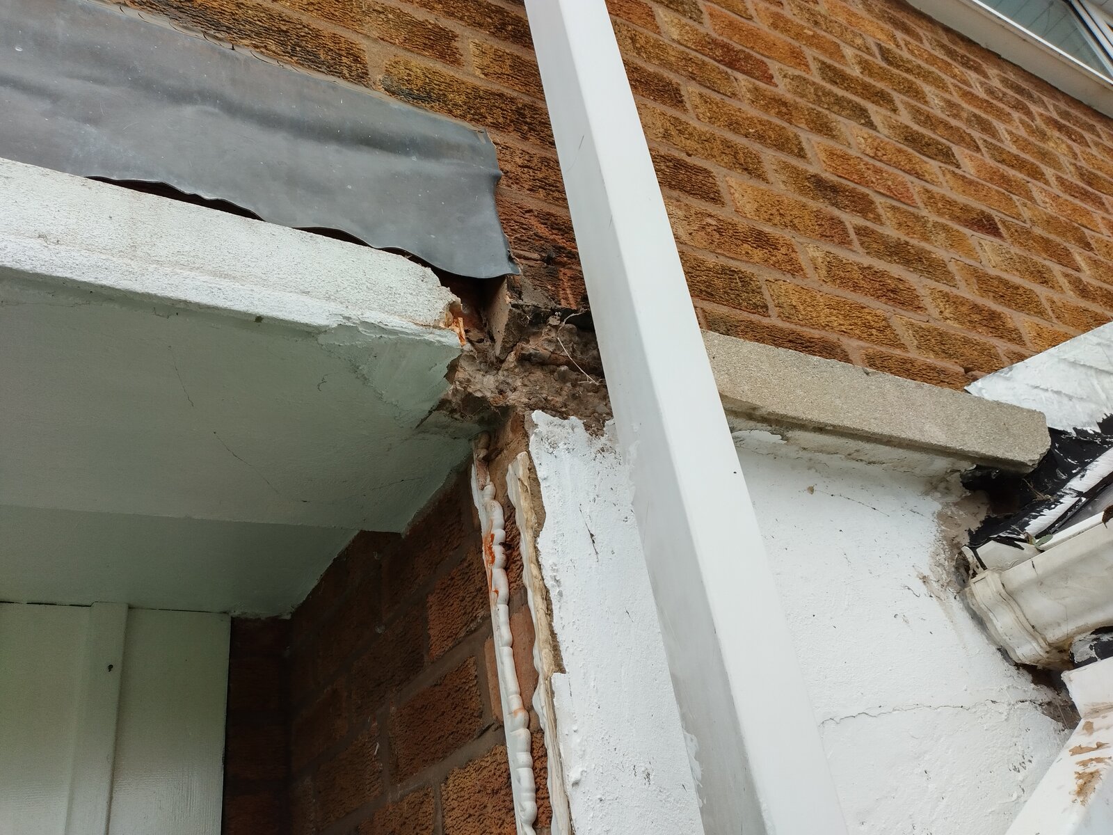

Damaged reinforced concrete lintel - what to do?
Quite agree no issue with rusty bars being surrounded in concrete as if dense/thick enough it will prevent further attack by moisture,more rust forming thus expanding thus spalling concrete with associated rust stains
Casts some question over whether it's going to be best to treat and patch with an epoxy cement product or leave rusty and surround with traditional cement?:unsure:
Whenever reinforced concrete is repaired, the steel must be cleaned, de-rusted, treated and then the concrete repaired.
Doesn't really matter as the reinforcement in that area now offers nothing towards the structural integrity of the beam its all just a cosmetic exercise but something to be done with due diligence

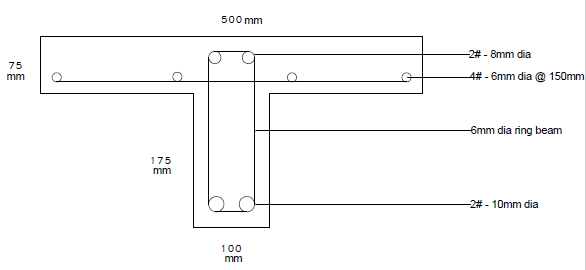

Slabs are wider
I have just invented the tee slab
*Tee-beam.
I think you're a few centuries too late for the patent though.
I totally agree with woody on all advises. And do cover the area so it doesn't get wet until you get to patch it up. It might be like this the last 30 years, but was covered by the conservatory and H2O +O2 is bad for steel. Make sure to lightly tap the area with a hammer to remove any loose concrete (if any) due to corrosion before the repair.

Thank you. So is it a case of clean with a wire brush and remove the loose rust, then Jenolite? Does anything have to be done to the steel after the rust treatment has been applied and had time?
My view is that if it was going to fall down it would have happened by now.
The ends of beams are less stressed in bending than the middle so they can sustain some damage without problems. It's difficult to see from the photos but it seems that there is quite a width that is not damaged. It seems likely that the lintel is deeper further back.
If you aren't replacing the conservatory then you have to do a good job of the repair or will be noticeable and will make resale difficult. Fix the notch at the other end too and maybe paint the whole thing with epoxy paint.
What's behind the plastic/rubber flashing? If the brickwork just continues across then no problem, otherwise I need to know.

Thank you for this. The slab runs all the way along next door's property as well (semi-detached) and I suspect it's probably one slab. So the damaged part which is close to ajoinong property may well actually be near the centre of the slab rather than the edge. Assuming it's one long slab of approx 12 metres spanning both houses which it looks like but I can't be certain of that.
The black flashing above is lead flashing with bricks beneath in the style of the rest of the house. The flashing was what was connected onto the conservatory roof prior to its removal.
On the photo below you will see that next door's part of the slab looks like it's been cut too and it's possible the steel reinforcement could be cut there too but it's hidden by flashing. Our house is on the left, the downpipe is the boundary and next door is to the right of that.
I do wonder whether a couple of helical bars fitted above within the pointing spanning over to next door might provide a long term reassurance here. Fitted by experts of course.
Whatever happens we are going to get a professional in even if it's just to repair the lintel in two places.

I should have written that beams are stressed most in bending near the centre of the unsupported span. The amount of bending where the notch is will be small. Unless the your new bar(s) are welded to the existing one there will be no increase in overall structural integrity. I wouldn't try to put in new bars because I think it will compromise the repair to the concrete.
