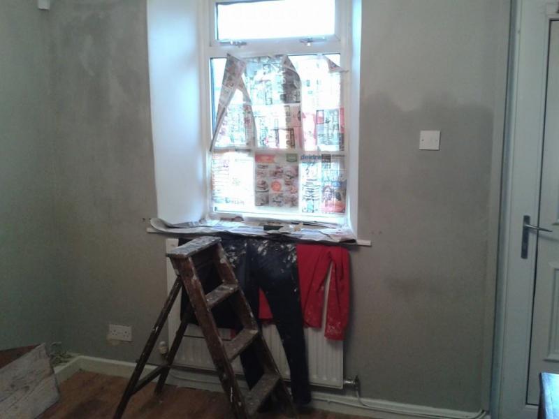

Its what the builder/plasterer told me when he came out to give me a quote for dashing. Not the best of pictures but notice the darkness around the lightswitch, and just over half way down, its cold to the touch and feels damp.
Well, I can tell you for certain that change of colour around the light switch is not rising dampness. The reason I asked is that over 15-20 years of surveying houses I have rarely come across what I could describe as rising dampness. I'm not saying it doesn't exist - as many people believe - just that it is a very rare beast. In the majority of cases (well, effectively all cases really) it is something else. Could you post a photo of the outside.
