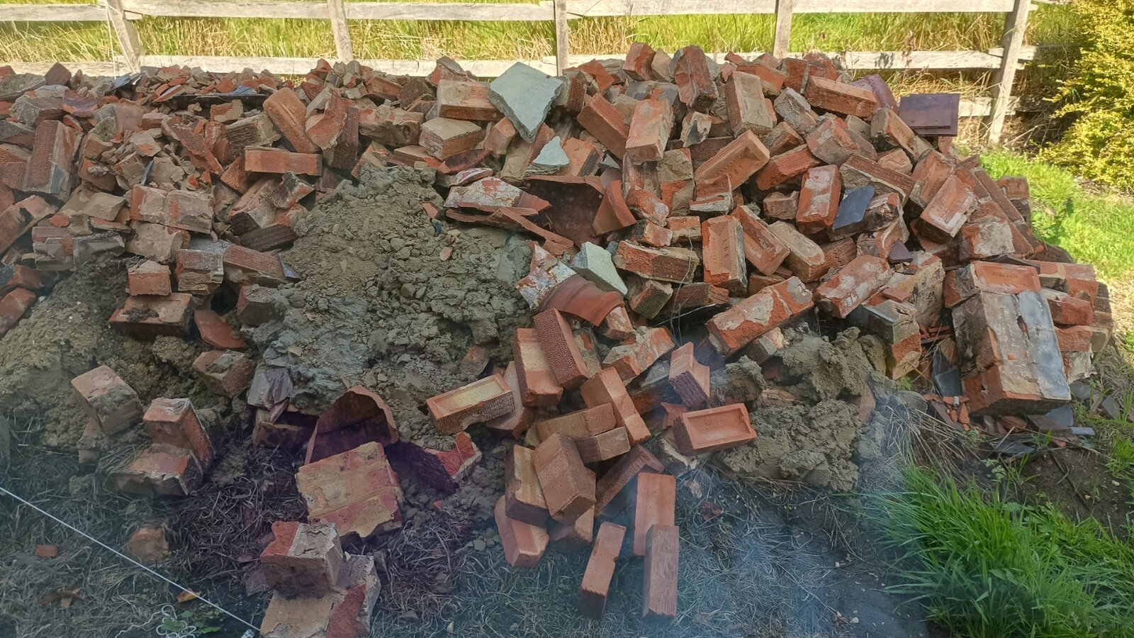

This is what I did with my two redundant very tall chimneys...
No leaks, damp patches or worries ever again.

If the chimney has an outside wall then venting to the outside at the bottom is a much better way. But getting rid of a disused chimney completely is a far better idea, otherwise they're a liability without any positive benefits.
Mr rusty is the expert but I would say yes - cap first - a cap that allows air flow. But you are on the ground floor - I would have thought that any rain ingress would of hit the sides further up stairs and show in the bedroom.Unfortunately all the chimneys are internal walls.
I'd really like to keep it simple if possible and avoid any more damp getting in to the walls. The fireplace with damp is in a hallway so I don't want to expose it either although I am impressed with the examples shown.
The house does have a void underneath but I can't see any venting into the void, or the walls apart from vents for fan extractors. There's also no vents on the double glazed windows.
I take it that the first step would be to get the chimneys capped and see if that sorts the damp out before opening up any walls, is that right?
