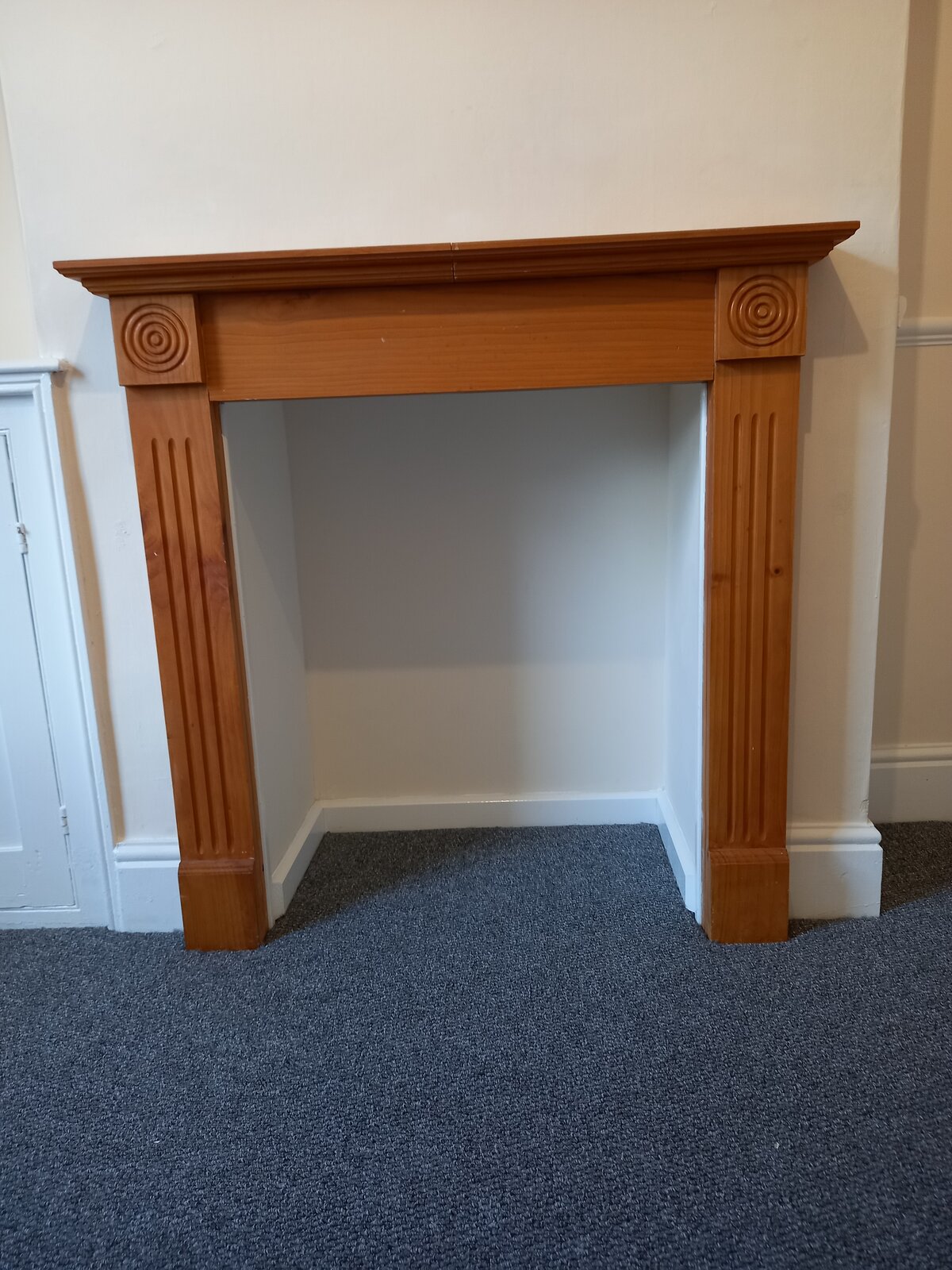

Often, the original opening is faced with plasterboard. If so you could use a pad saw to cut an opening and then fit a grill over it. Ideally, the chimney pots would have caps over the top to allow air flow but minimise rainfall downwards.
I suspect as your surveyor says re the chimney's needing capping. It's likely that rain is getting down inside. The good news is that they are open to the air. I'd cut a hole and fit a vent grill. If you're really concerned about the physical water coming down then you could get up inside the opening and fit a 'baffle' plate of some sorts. This would soak up the direct rain drips and then hopefully dry out before the next shower. Alternatively, arrange with the free-holder to have the chimneys either capped fully or have large shrouds / covers added so that the rain does not blow in.
You could fit the vent on the side of the chimney breast as then it would be out of direct sight?
I think the problem there is that he will have to go through possibly 2 thickness of bricks whereas on the front it will just be plasterboard.
Alternatively, remove the plasterboard front and see what's behind. You may find that the existing Victorian fireplaces are still there and you could make them a feature or,even if already removed, you could face the opening's sides with board (I've just used plywood in the past) and then paint, carpeting right into the fireplace. I fit a 'ceiling' to the opening and the vent goes in there, out of sight.
