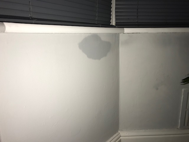

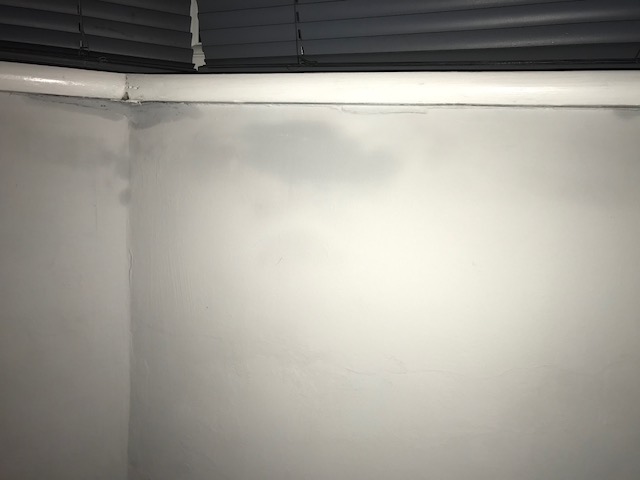

We have recently purchased (July 19’) a circa 1900 property, 3 bed semi detached. We fully painted the entire house and noticed some strange almost stain looking marks on the external front wall of the house in the front room. Some are directly under the bay window and the other, much larger, is in the corner of the room behind the TV / above the gas meter.

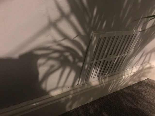

They don’t feel wet at all, no paint particularly comes off when you touch or rub them and they haven’t changed much or at all from what I can tell. We used Dulux Matt emulsion paint and we've actually got a few patches on the gable end wall upstairs in the bedroom as well. When you shine a torch on them they have a glitter effect... is this salt? Or a previously applied oil or paint of some sort applied to the wall or even a problem with our paint? They weren’t visible before we decorated but the wall was painted a darker colour and it was July! They did appear as the paint dried though so within a day or two you could clearly see them. The second patch (pic 2) on the right hand side of the bay seems to have recently appeared although I might not have noticed it before now. We live in Manchester and it has rained a lot recently!!
There is a vent bang in the middle under our bay window which is always open and not blocked. We have a plant in the window and thats it, we never close the curtains. Not noticed condensation on the windows. External to the wall is a flagged drive and directly under the wall vent is an air brick for under the floor. I did place a standard Aero360 dehumidifier in the corner of the room a few months back and its filled up a few times but only three times in three months. I'd have thought it would have filled up more if we had a big damp problem.

the small mark under the windowsill looks like rain penetration, but the large mark looks like severe long term damp.

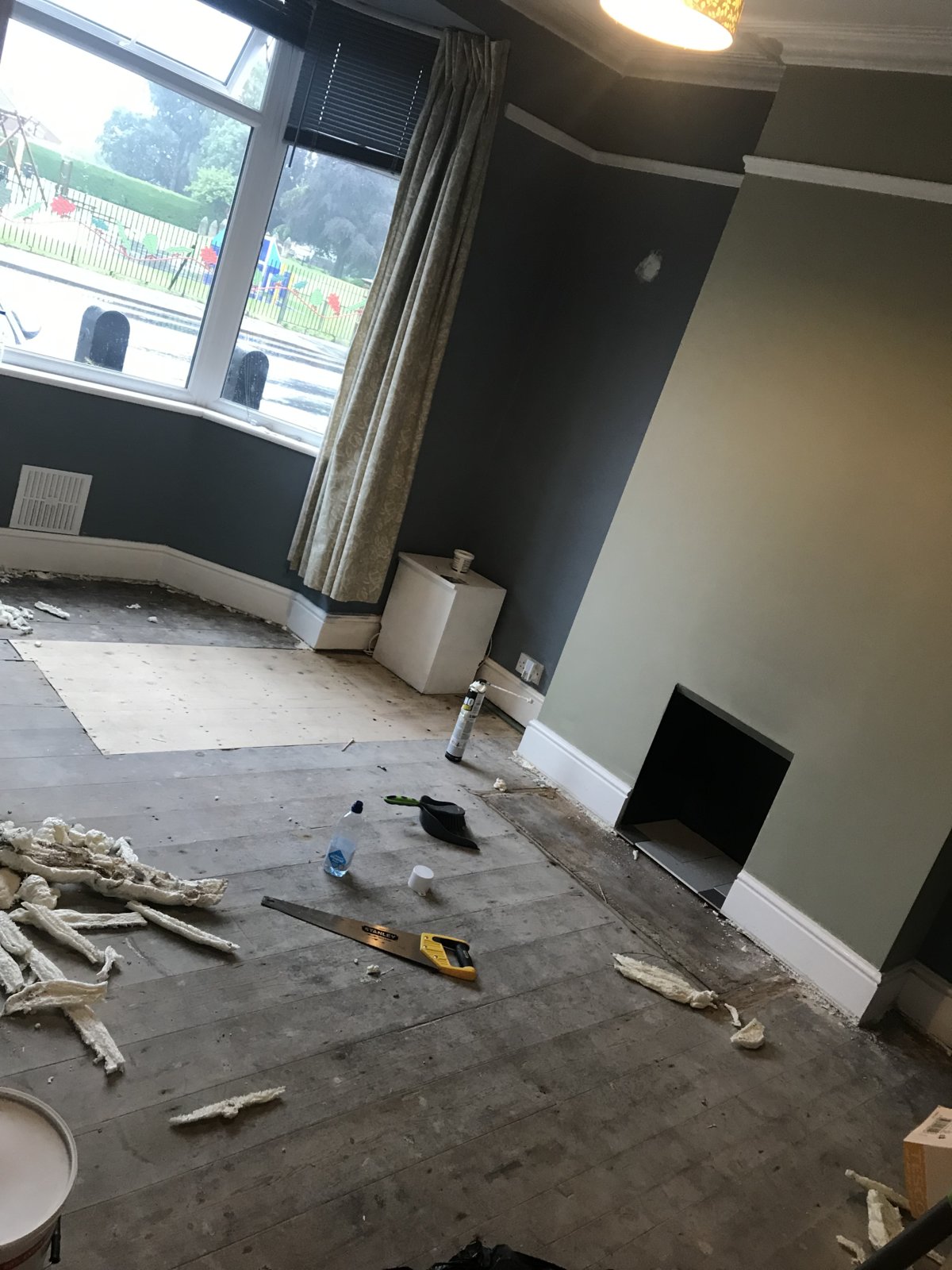

My girlfriend just pulled up a picture of before we decorated... you can see replacement boards.. can’t be a coincidence??

the floorboards in front of the fireplace look "cupped" to me. This is a form of warping when they come up at the edges (they can also come up in the middle) and the patch of ply over the hearth looks water damaged. Possibly the chimney is relevant.
Those old terraced houses often have very poor brickwork which allows penetrating damp especially around and near windows .

I think the bay could do with being repointed to be honest. The mortar is pretty old and it’s that thin red type if you know what I mean. Not sure if this is the cause of the damp there or possibly the window (or combination of both). It’s the corner I’m concerned about.
