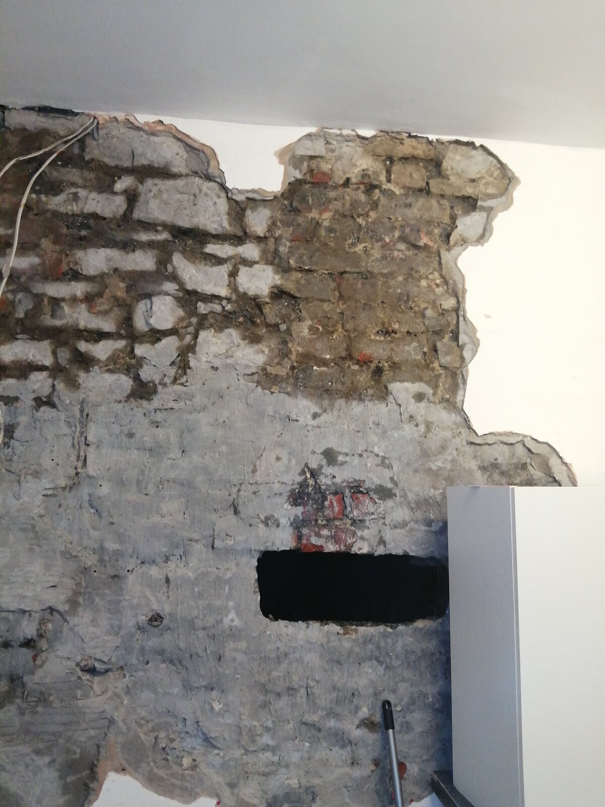

So, we decided to hack the wall back to the brick to see what was going on, what we discovered was a very old stone wall with a brick built fireplace, this wall is damp, you can feel the walls at the back of the fireplace which would be the outside walls, they are dry, the dampness is from the wall that has been built either side of the fireplace to make the wall flat essentially, I know it's not coming from the roof because we have had all the roof done, however, it could have been getting wet before we had the roof done and that damp has stayed?
The whole wall is going to be knocked down now, covered with special plasterboards? Insulated I believe they said! Skimmed and then painted with anti condensation paint.
My question is, do you think that was what is causing the high humidity?
We do not have cavity walls I have since found out.
I have that crap insulated stuff as Ericmark has mentioned above, it has been put over the outside of the house (we didn't have this done, it was done already) it's really thick, around 6 inches, looks a bit like polystyrene stuff.
I've managed to get the humidity down to around 64 (average) sometimes goes down to 58 but when cooking even with doors and windows open it goes to 75+
My kitchen units that are now off the wall and have been for a few weeks now, started to go mouldy again, these are sat in the middle of my dining room, nowhere near any walls so I am guessing that it is definately condensation?
Many thanks

I wonder if the render is causing some issues? I thought older houses (any houses) that don't have a cavity were best rendered with breathable render, ie lime containing, but I'm no expert.

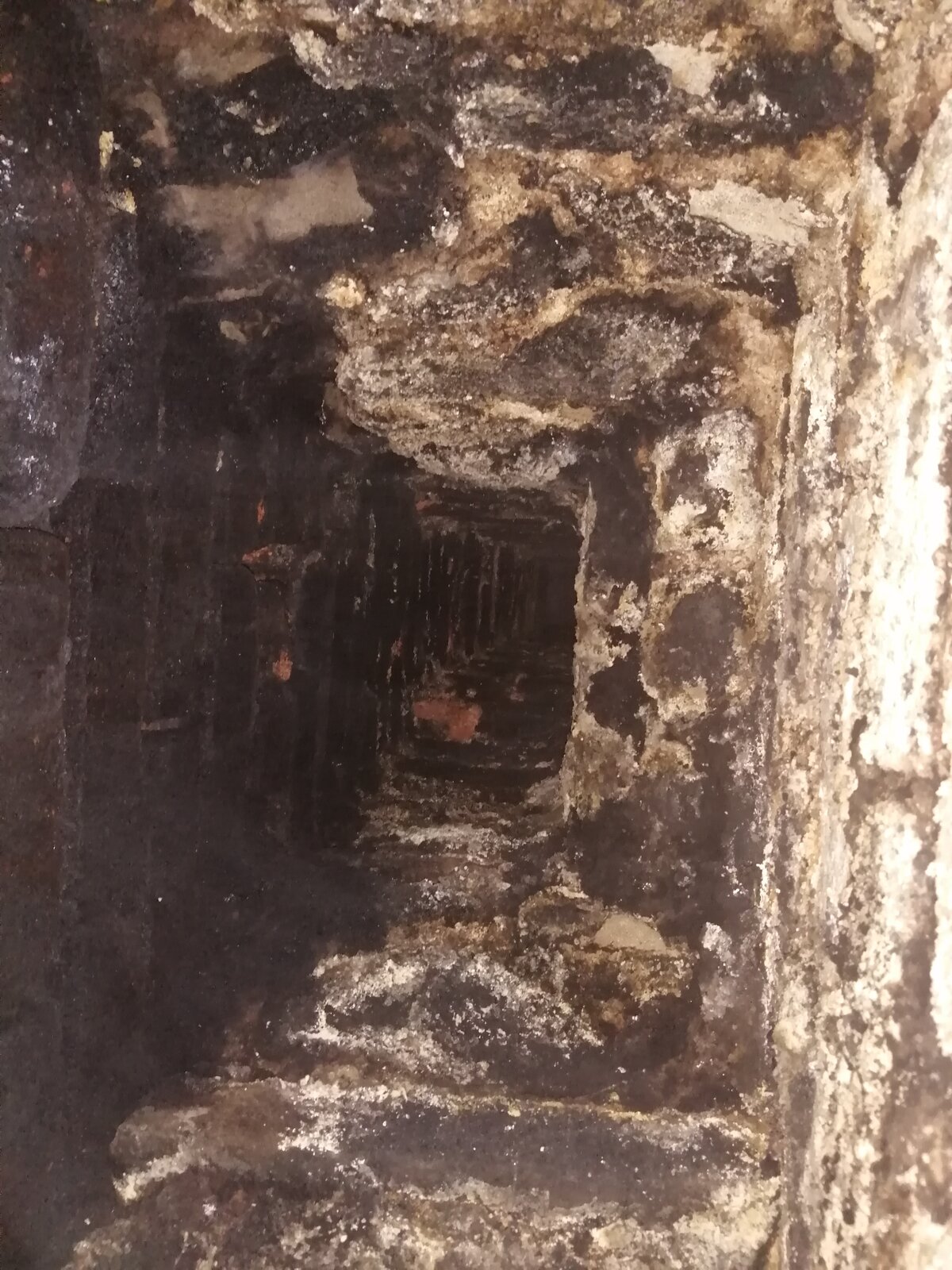

Is there a chimney above said old fireplace?
Careful putting internal insulation in. With non-cavity walls, depending on the depth of the brick/stone, it's advised to leave an air gap to stop any moisture from the outside wall getting through onto the insulation. Also, especially in a kitchen and with your levels of humidity, everything needs to be sealed and taped and probably covered with a vapour barrier to stop any warm humid air getting through to the cold side of the insulation and condensing in the wall. Wouldn't want to end up with more problems than you have already.
Hi there, the is a chimney above ( picture below taken looking upwards)
I will explain to builder what you have just pointed out as well, I'd rather get it done properly now! Rather than have issues later on.
