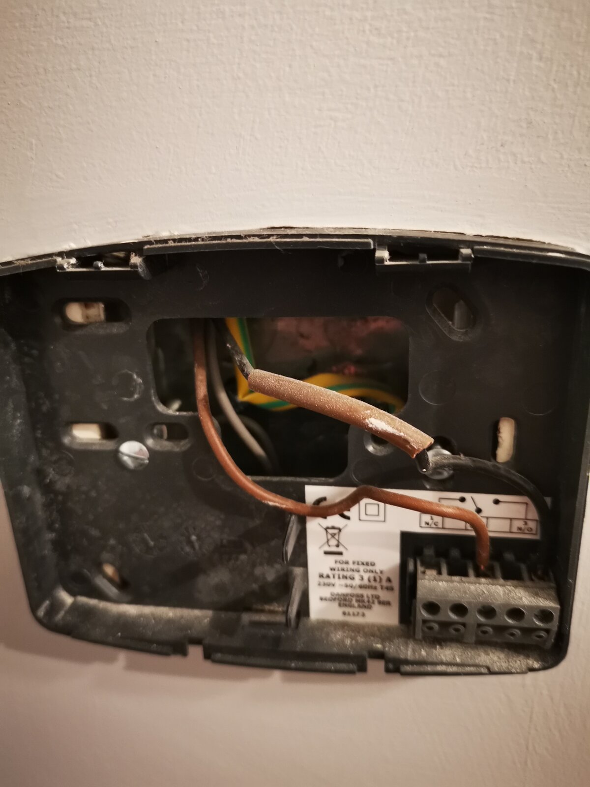

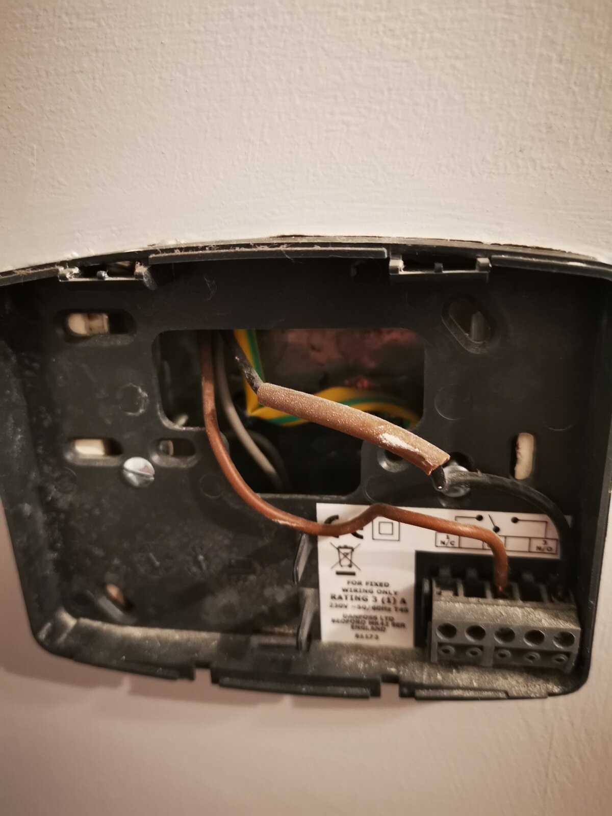

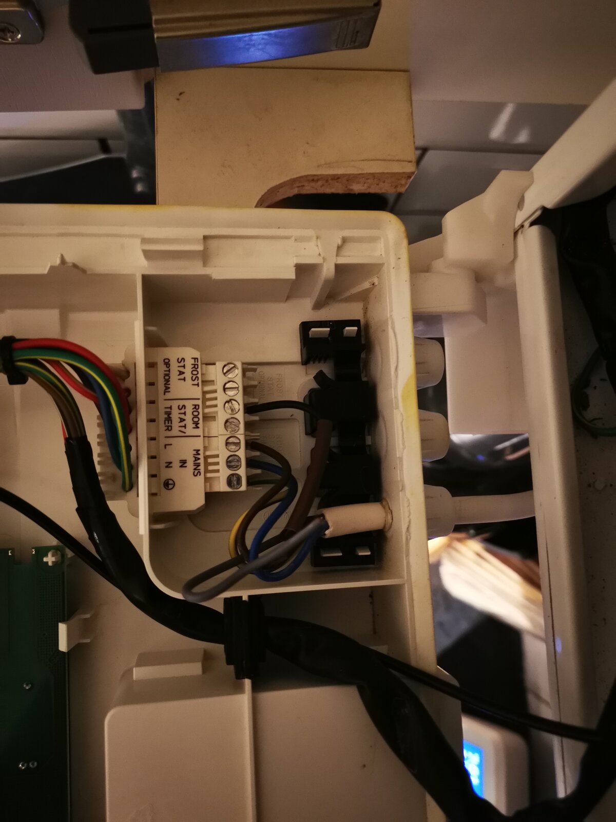

Hi,
Hopefully you can help. I am looking to change 2x Danfoss 5000si to Hive active heating. I bought 2x as I have a downstairs one that control.the entire floor and one in the master bedroom to control the 1st floor.
When looking at the boiler and the danfoss I can see I only have 2x wires connected with a grey one left dangling. Boiler Ideal Logic 35 combi espi boiler.
Can you recommend how to connect these cables? I am guessing it should be like for like swap but I can't see any blue (N) cable at danfoss. Attached pictures from boiler and from Danfoss.
Thank you in advance!
Stefan

I think you mean neutral wires as opposed to blue, as they can be grey, but colours in a heating system mean diddly swat. You need to wire the receivers near the wiring center, not the boiler. Another diyer who thinks they can just remove the boiler cover without checking for safety afterwards.
Yes, that is neutral. I do have my annual boiler maintenance and gas safety annual check scheduled in but wanted to understand what/how to mount it and if I need to quote that in or do it myself. Thanks for your reply, but it's more critic than to offer guidance. If you have anything more specific, I'd be glad to hear it.

Thanks, OT is new to me but you actually made me re-think my decision to look for a Nest instead of Hive. My question is, does OT require new wiring or can it use the existing? that's going to weigh into the decision as I am not going to start running new cables.
I would say it will need new cables, but very short from hub to boiler. However as to if OpenTherm really helps depends on the set up and boiler.

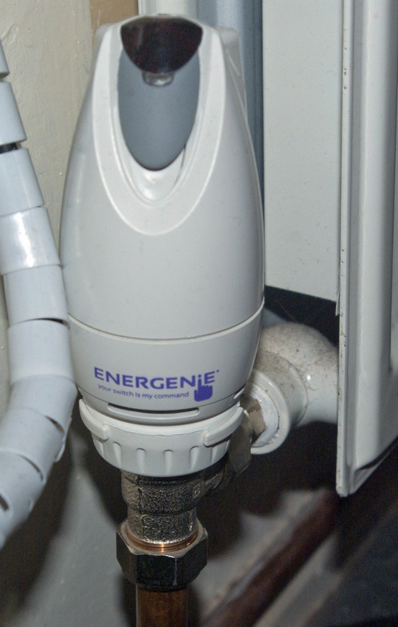

I used these IMGP8035.jpg in mothers house, they worked well, but the anti-hysteresis software was OTT, so set to 22ºC at 7 am and 20ºC at 8 am or it would have been 10 am before room at 20ºC.
This house I have also used these EQ-3 Bluetooth Smart Radiator Thermostat.jpgwhich were far cheaper I paid £15 each in 2019, so have 4 of the Energenie and 5 of the eQ-3 the latter seem to work better than the more expensive wifi versions, non link to wall thermostat.
I think I may have been better with Drayton Wiser, the TRV algorithms are better, designed to work out how long it takes to heat the room, but I wanted CH and DHW control in main house hard wired, and Nest Gen 3 did this with the two existing wires, and I thought when I fitted it that it would work with Energenie, seems Nest withdrew support.
