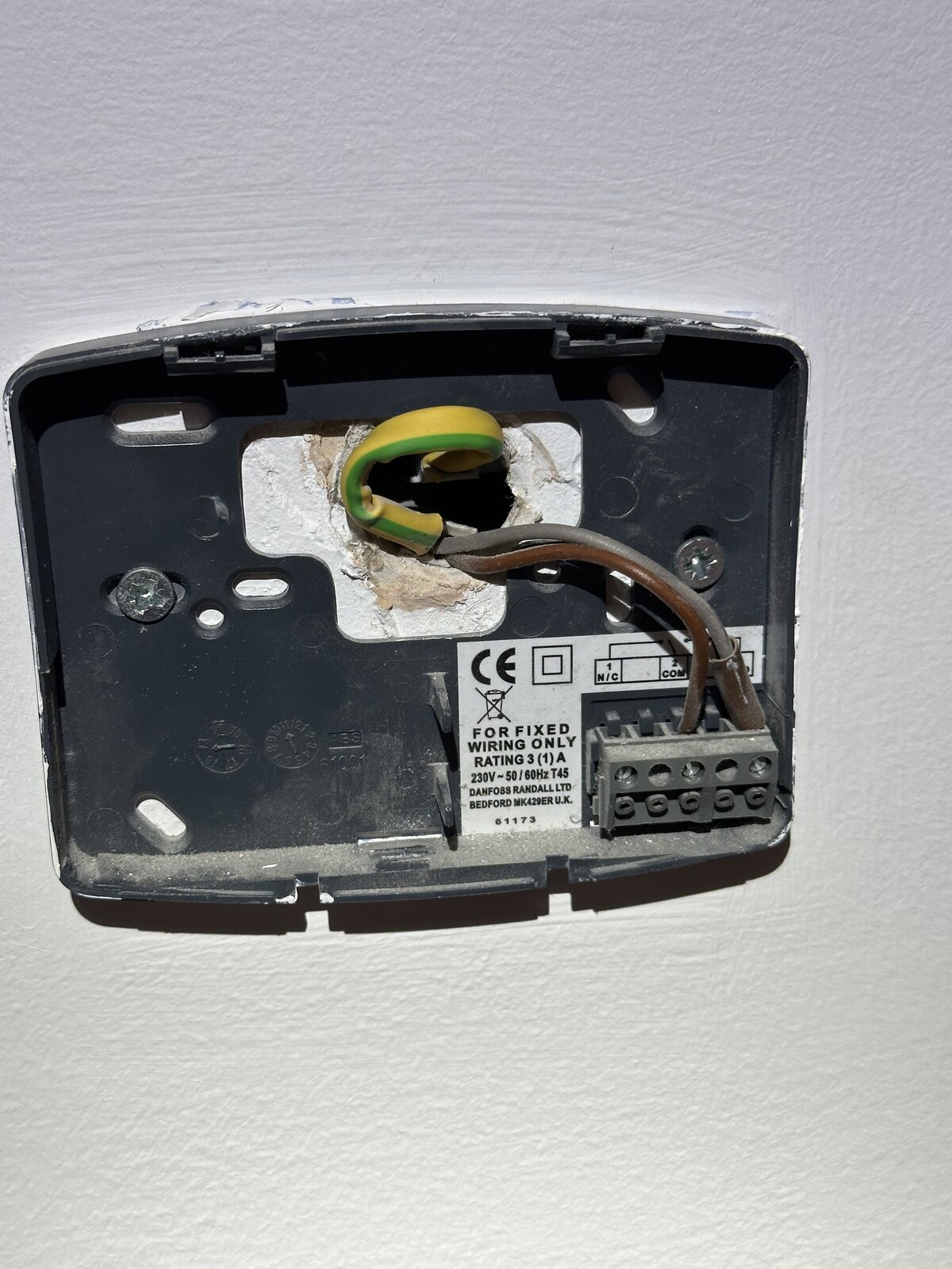

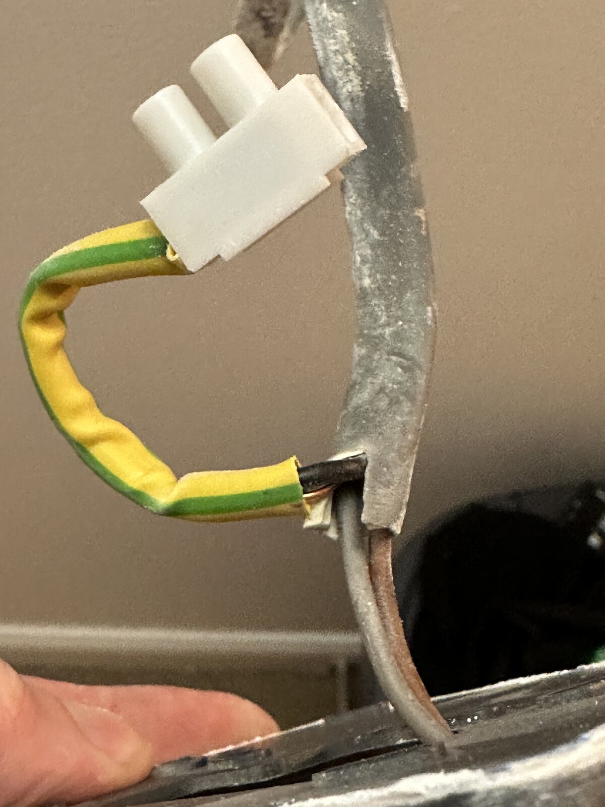

Hi thanks for the reply, looks like it’s a 4 core, earth black brown grey. Pics attached
Great, so the Hive can be installed there, without having to run a new cable.
However, we still need to find the other end of that 3 core and earth cable in the wiring centre - the black wire can then be connected to a neutral terminal.

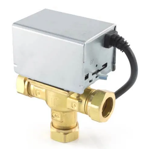

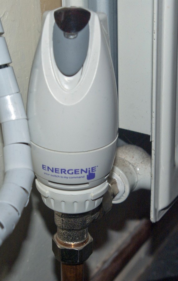

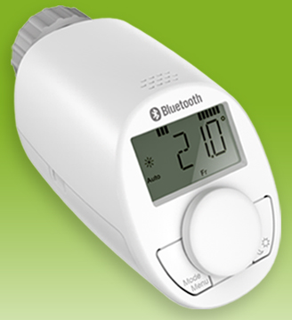

Maybe I am missing some thing? But why does it need two thermostats/hubs? There are two basic methods to split a home into zones, one is hard wired zone valves, 1710836385613.pngthe other is the thermostatic radiator valve (TRV) IMGP8035.jpg with a motorised head, both are motorised valves, but the TRV type is analogue so best suited for a modulating boiler, where the hard wired is simple on or off.
There are cases to have both, I have a hard wired zone valve to turn off the granny flat under the main house, but in the main once the TRV is motorised there is no point in zone valves.
The whole idea of Hive, EvoHome, Wiser, etc, is the motorised TRV sends a signal to the thermostat/hub to tell it when the boiler needs to run, so there is no need to have any hard wired zone valves, the battery powered TRV's mean each room is it's own zone.
I have used cheap TRV heads, 61dmtMm13BL.jpg in most rooms, one shown only cost me £15 each in 2019 when I got them, and the idea of only fitting linked TRV heads in key rooms does save a lot of money. But in the main both hard wired zone valves can be linked together so one thermostat/hub works whole house. This then allows things like using a bedroom as an office, or sending kids to a bedroom to do home work, and having just one upstairs room turned on.
Also allows a sequential start, so for example first kitchen, then dinning room, then living room, finally bedrooms so the rooms required heat up faster i.e. have a shorter recovery time.
I will admit this TRV IMGP8035.jpg has the option of geofencing, however it has not been very good, I have three makes of motorised TRV heads, and they are different in the way they work, the Kasa is the best one that I have, not tried using that one with geofencing, but the Energenie one has anti-hysteresis software which is really OTT, so set to 20ºC at 7 am and it was 11 am before it got there, so at 7 am set to 22ºC then at 8 am back to 20ºC and room at 20ºC at 8 am, this means geofencing does not really work with them.
Not used Hive TRV heads, I have seen how the Hive wall thermostat/hub has a problem in that it will not accept a 'demand for heat' once it reaches 22ºC, so needs to be in a room normally kept cool. I note you can get a Wiser thermostat/hub designed to work two zones and DHW plus using TRV heads, and can connect to boiler using OpenTherm, so you can get thermostat/hubs designed for two zones, but still the question is why have two zones which are then sub divided into more zones, it does not make sense in most cases.

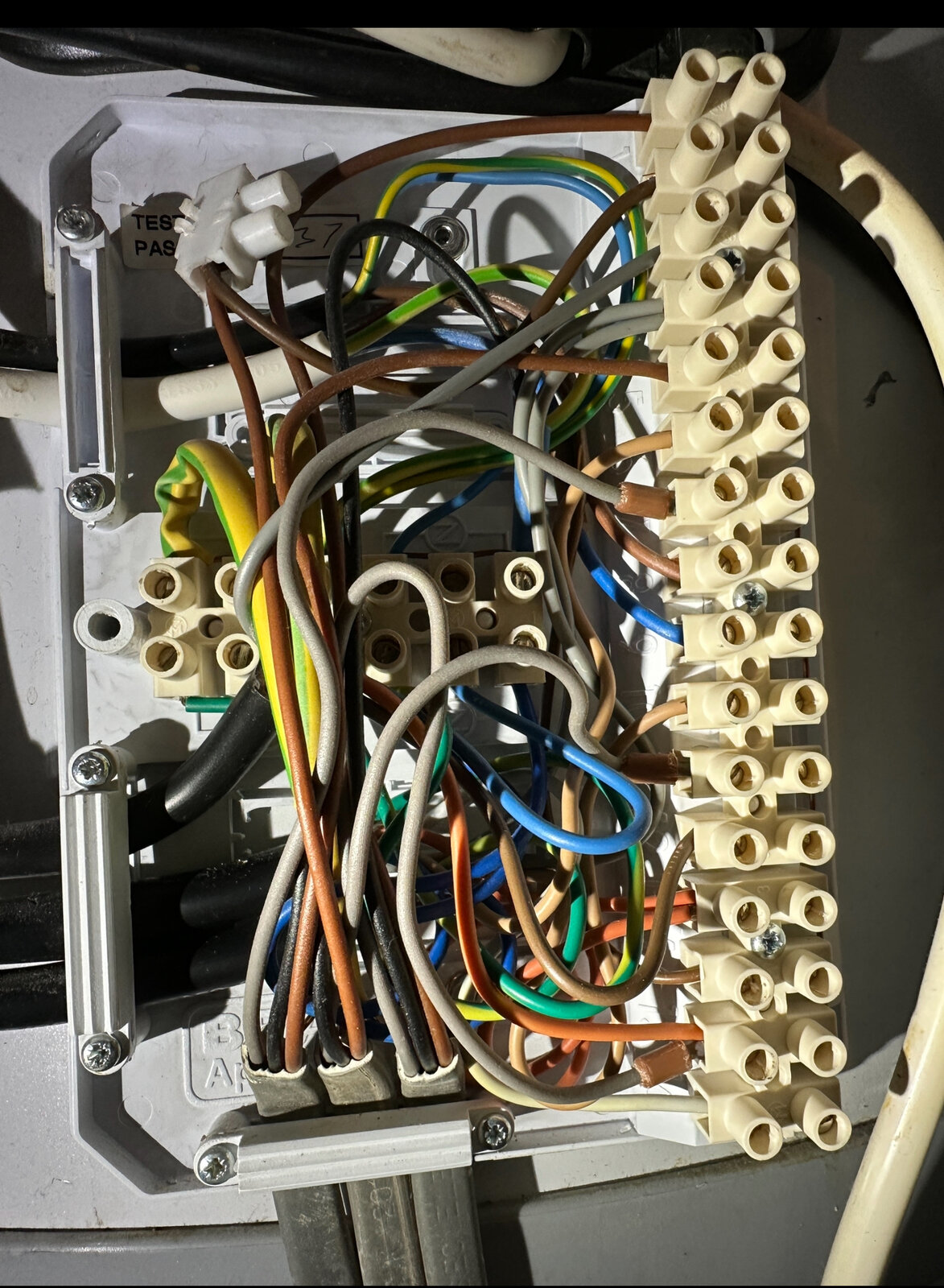

Ah thank you. See attached

Thought u sent this yesterday but it didn’t post
Maybe I am missing some thing? But why does it need two thermostats/hubs? There are two basic methods to split a home into zones, one is hard wired zone valves, View attachment 337148the other is the thermostatic radiator valve (TRV) View attachment 337149 with a motorised head, both are motorised valves, but the TRV type is analogue so best suited for a modulating boiler, where the hard wired is simple on or off.
I have used cheap TRV heads, View attachment 337150 in most rooms, one shown only cost me £15 each in 2019 when I got them, and the idea of only fitting linked TRV heads in key rooms does save a lot of money. But in the main both hard wired zone valves can be linked together so one thermostat/hub works whole house. This then allows things like using a bedroom as an office, or sending kids to a bedroom to do home work, and having just one upstairs room turned on.
I will admit this TRV View attachment 337149 has the option of geofencing, however it has not been very good, I have three makes of motorised TRV heads, and they are different in the way they work, the Kasa is the best one that I have, not tried using that one with geofencing, but the Energenie one has anti-hysteresis software which is really OTT, so set to 20ºC at 7 am and it was 11 am before it got there, so at 7 am set to 22ºC then at 8 am back to 20ºC and room at 20ºC at 8 am, this means geofencing does not really work with them.
