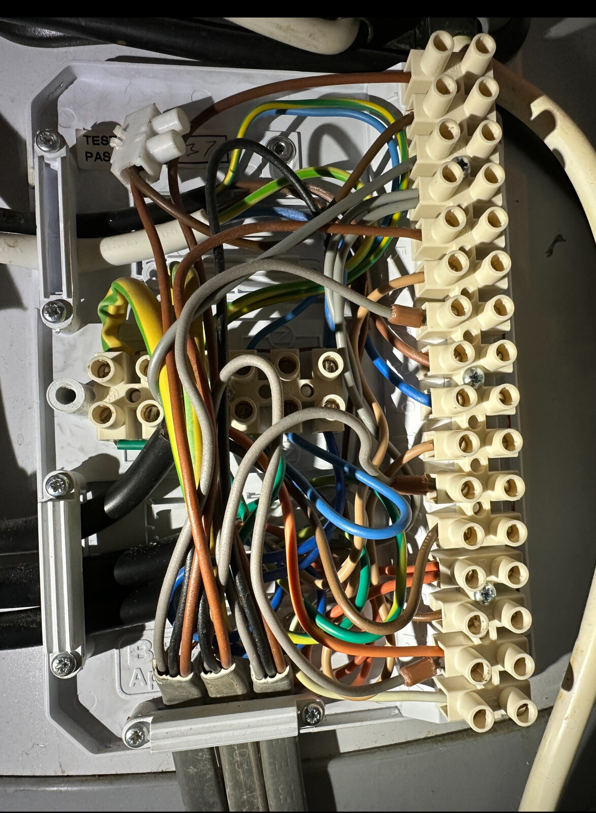

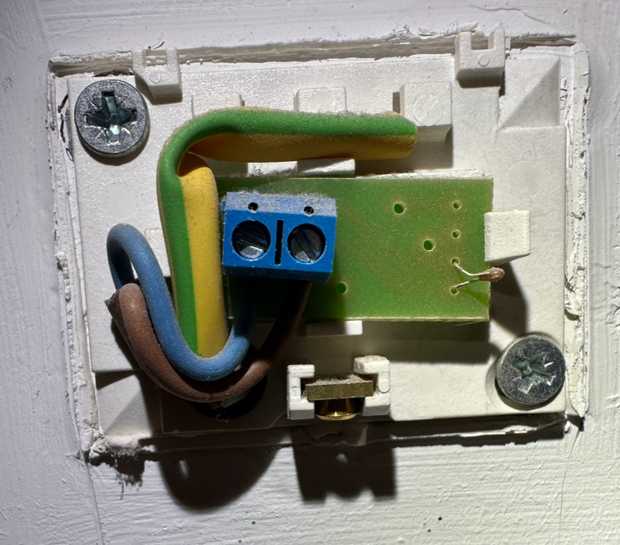

I have a traditional boiler with hot water tank in a cupboard downstairs
And the following
Porrerton promax 15 SL

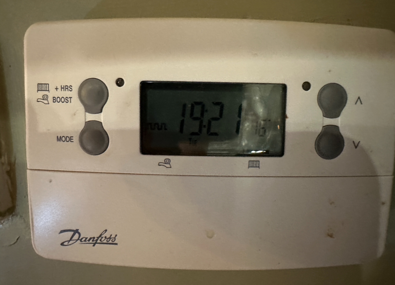

Danfoss TP9000 Programmer

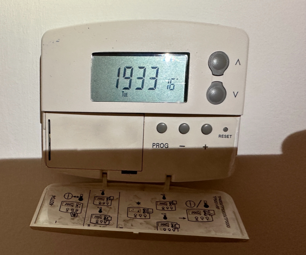

Danfoss TP5000SI

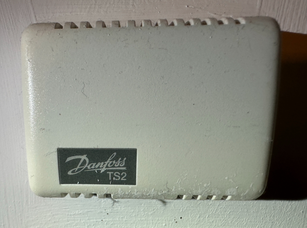

Danfoss TS2 Sensor
The above are awful, screen is too small, not backlit and it’s a pain to program and whenever I want to look at it I have to find a torch

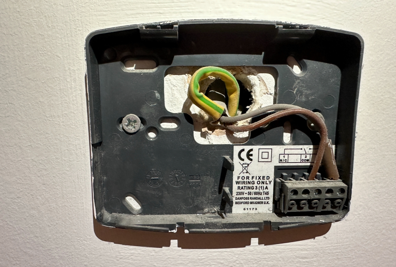

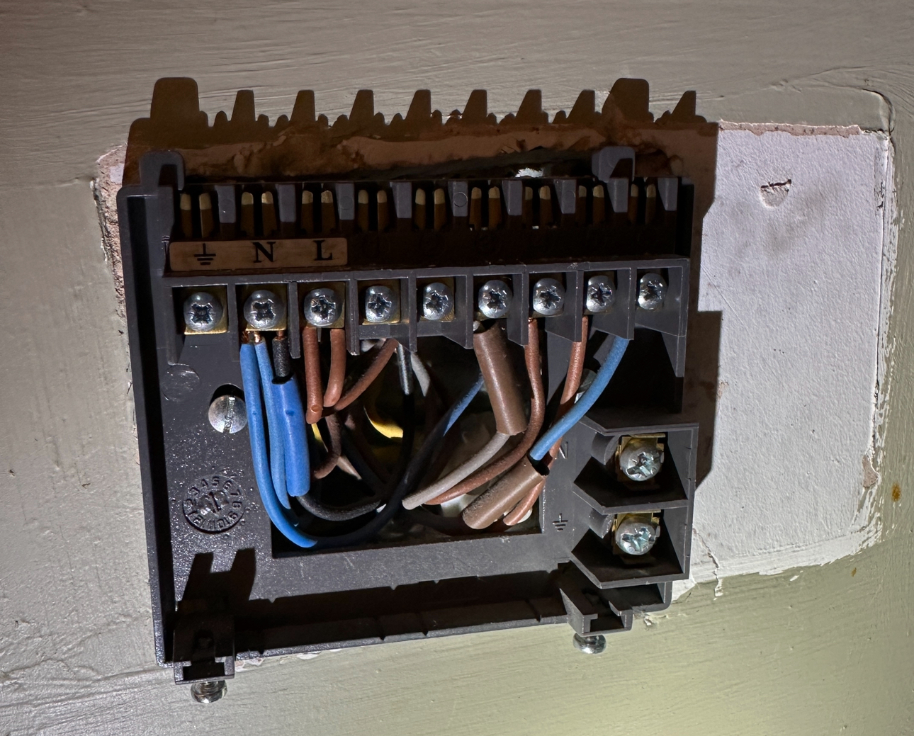

I’m looking to upgrade, possibly a hive but getting information off hive support on how to wire everything up is hard work
Does anyone have any guidance on what to do with each wire for the hive system
Or does anyone recommend replacement controllers, looking for a decent backlit display on both controllers at a minimum, but hive would be ideal as can control from my phone
Pics attached for reference
Thanks in advance

L,N,E are pretty self explanatory. The heating on, hot water on would go to the NO. You don’t do away with the sensor, and link the 2 wires for the thermostat at the thermostat end or in the wiring center. You would need to purchase a dual channel, whichever you decide to install.
