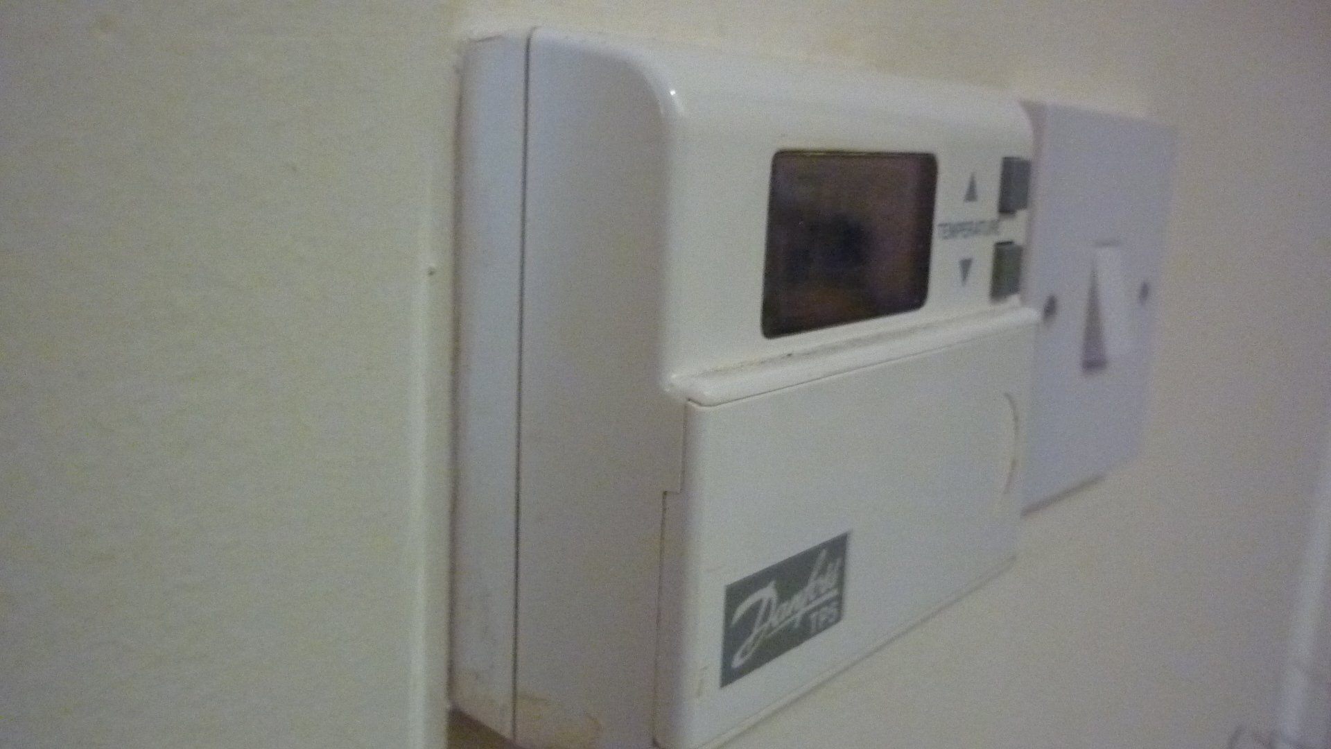

My Danfoss TP5 is about 18 years old and controls a combi boiler, which is delivering H/W OK.
When trying to programme it, the display is incomplete: the screen displays either the upper half, the lower half or nothing.
I have replaced the batteries with new batteries but there is no improvement.
Is there anything else that I can try?
Is it 'scrap'?
All advice welcome, please, as a new one is quite expensive.
Thank you.
If the batteries are decent quality and contacts in the stat are clean then it’s likely goosed. You can replace with whatever you like really, as long as the voltages are compatible (most are).
It may be that you can carefully dismantle it, clean the contacts between the LCD and the circuit board, re-assemnle and it will work. I’ve done this with a number of gadgets with LCD screens over the years where part of the screen has stopped working. Mainly these have been kitchen gadgets where grease or similar can get in.
Or just replace it.
Thank you for the replies.
I cleaned the battery contacts to a bright finish and fitted two new Dxxxcell batteries. There was no change. The LCD display changes at random between a complete display and various partial displays.
There are two slotted screws in the front part of the thermostat and I removed these but the front part will not move. Before I use some force, does anyone know how the front part separates from what appears to be the back part of the thermostat? The installation manual doesn't help.
AI says plastic clips hold the PCB in place within the front housing... Pictures may help confirm. The PCB<->clip interfaces need careful/gentle separating with a plastic lever or screwdriver.
FWIW , my experience of attempting a cleanup of LCD screen connections via rubberised conductive strips = certainty of a recurrence. An 18 year old thermostat-programmer owes you nothing and a new replacement may be best course of action. Albeit a fair lot of cash ca £80-100 for a wired battery operated replacement.

For information, here is a picture of the side of the TP5 showing that it appears to be in 2 parts, with the front part firmly in place. Some careful effort is required to separate them, I suspect.

https://www.manuals.co.uk/danfoss/tp5/manual shows a fixing screw behind the battery compartment cover.
I assumed you'd already got the bit off the wall and in your hands..
This thread:
shows the back of the unit... So ensure you have isolated the mains supply to the boiler and controls system when doing this!
Thank you Rodders53 and DP.
I had removed the two slotted screws from the TP5 but the front part would not move; there are no screws visible underneath (the TP5000i has a retaining screw underneath and then hinges up). Looking at the photos, I suspect that, after 18 years, the front part needs some extra force to dislodge it. I will try this after switching off the incoming supply at the consumer unit and taking all necessary precautions.
