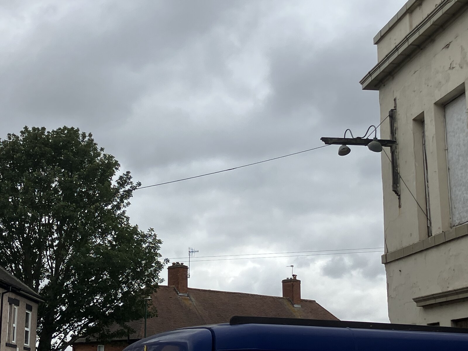

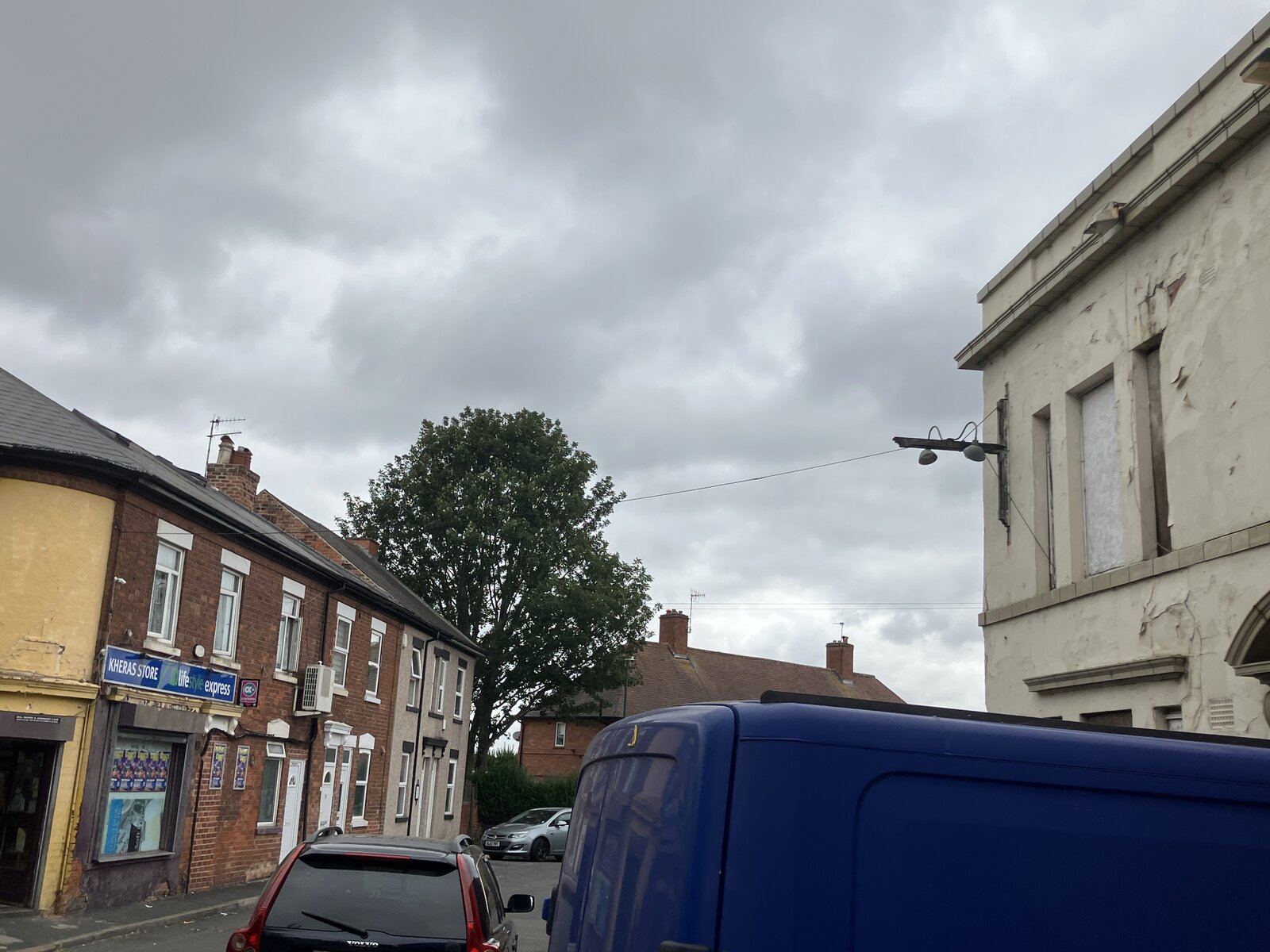

Hi,
A derelict pub is being done up by the shop on the opposite side of the road. Last week they installed an electric cable that runs from the front of the shop across the road and into the upper floor of the pub. Is this safe? Presumably this is so that power tools can be used without a generator.

Thanks for the replies so far. Here’s some photos

Looks no different to telephone or broadband cables that are also strung across the road.
It's likely very temporary.

If over 5.8 meters, there is no real problem.
looks a bit under 5m

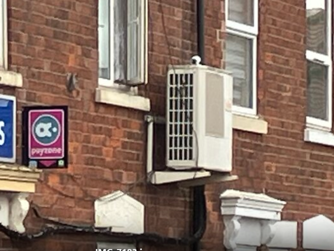

and what is this - an air con or heat pump thing - what a mess
or could it be a fridge unit for the shop?
or could

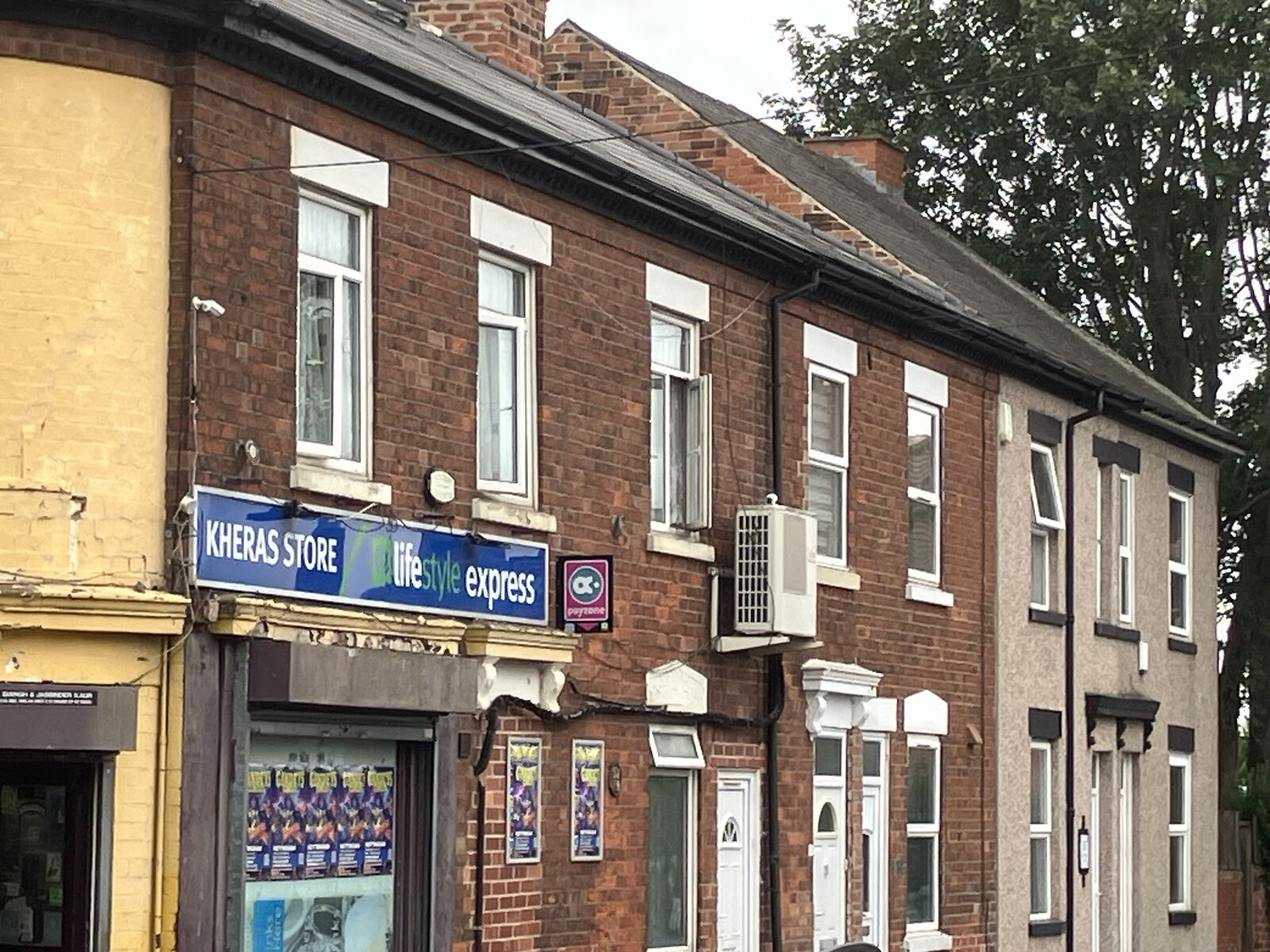

The entire front of the shop looks like an unsafe lash-up. I wonder what the DNO would have to say, about them exporting a supply to another building, across a public road?
