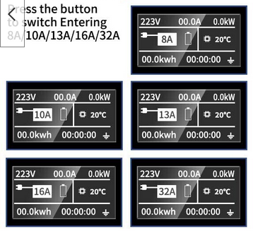

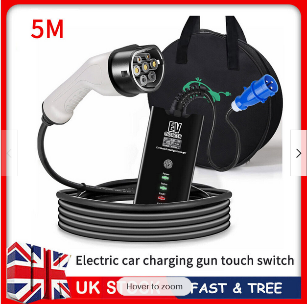

I must admit EV charging point worry me. I see items like this 1706875609937.png for sale, and inside a garage or other commercial building why not? If the car is charged within the bonded area there is no real problem, however the same item used outside with a domestic premises is a very different thing. It shows how 1706875940238.png 8, 10, 13, 16 and 32 amp charging can be selected, and state
Many kinds of intelligent protection measures: over-current protection, over-voltage protection, under-voltage protection, leakage protection, overheating protection,
I note nothing about 6 mA DC detection or RCD protection and these to be frank worry me as so easy for them to be used in inappropriate places.
My own son set up a caravan hook up in his garden, it was connected to the house TT supply, which was latter upgraded if that's the right word to a TN-C-S supply, so it complied when installed, it does not comply now as a caravan supply, he only uses now for garden tools, caravan long gone. But it would be so easy to use it to charge an EV. Why the EV is not class II I have no idea, it would be far safer, however we have now the potential to create some potentially dangerous installations and the home owners have no idea how dangerous they can be.
I think PME and TN-C-S should never have been allowed, but unlikely to see that change now. As to trip hazards, that's also becoming a problem. The caravan lead was bad enough, but the EV lead is so stiff, and so easy to leave in loops, however that's nothing to do with this case. At least where I live (Wales) supplies to garden are still notifiable, so one hopes that members of a scheme will not install anything dangerous.
