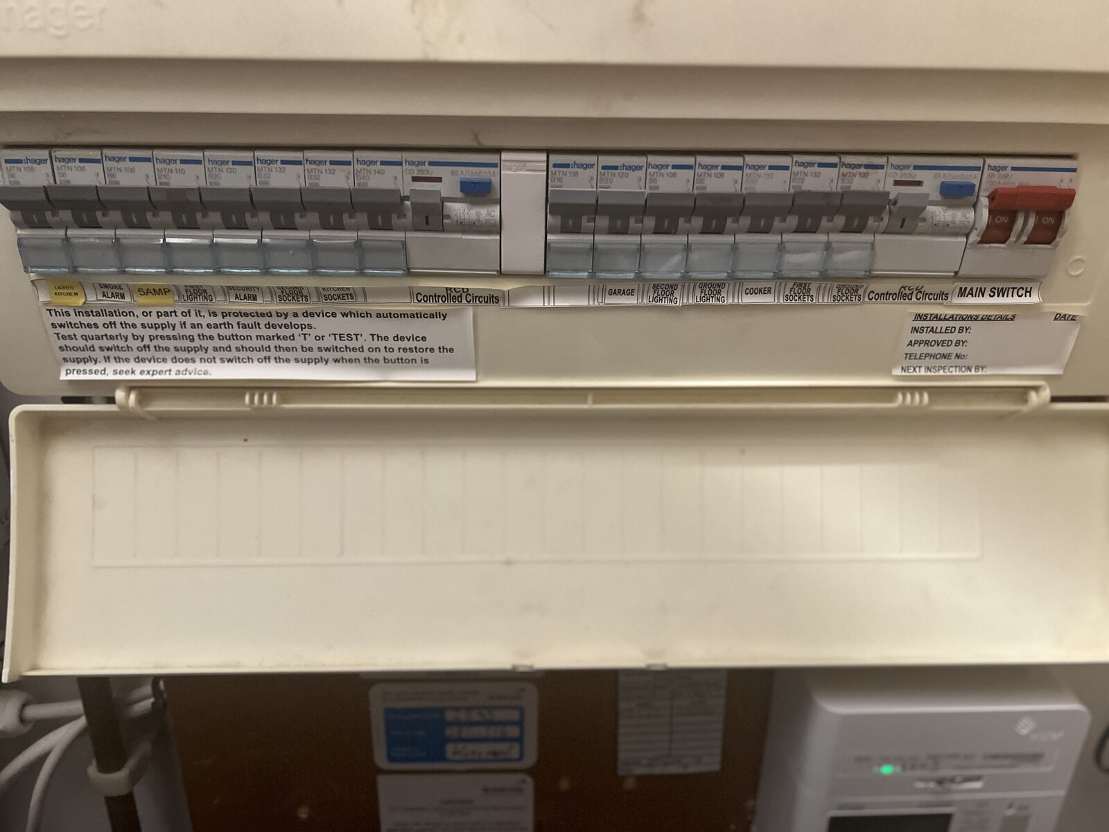

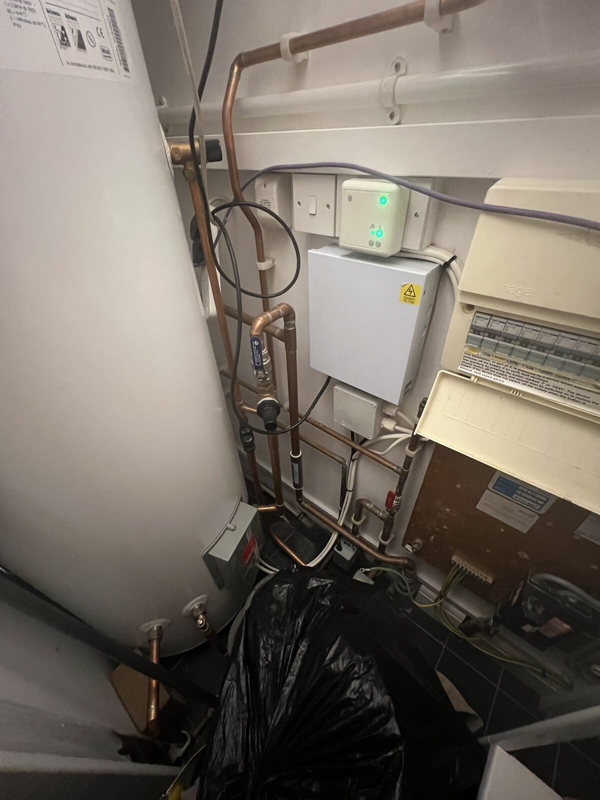

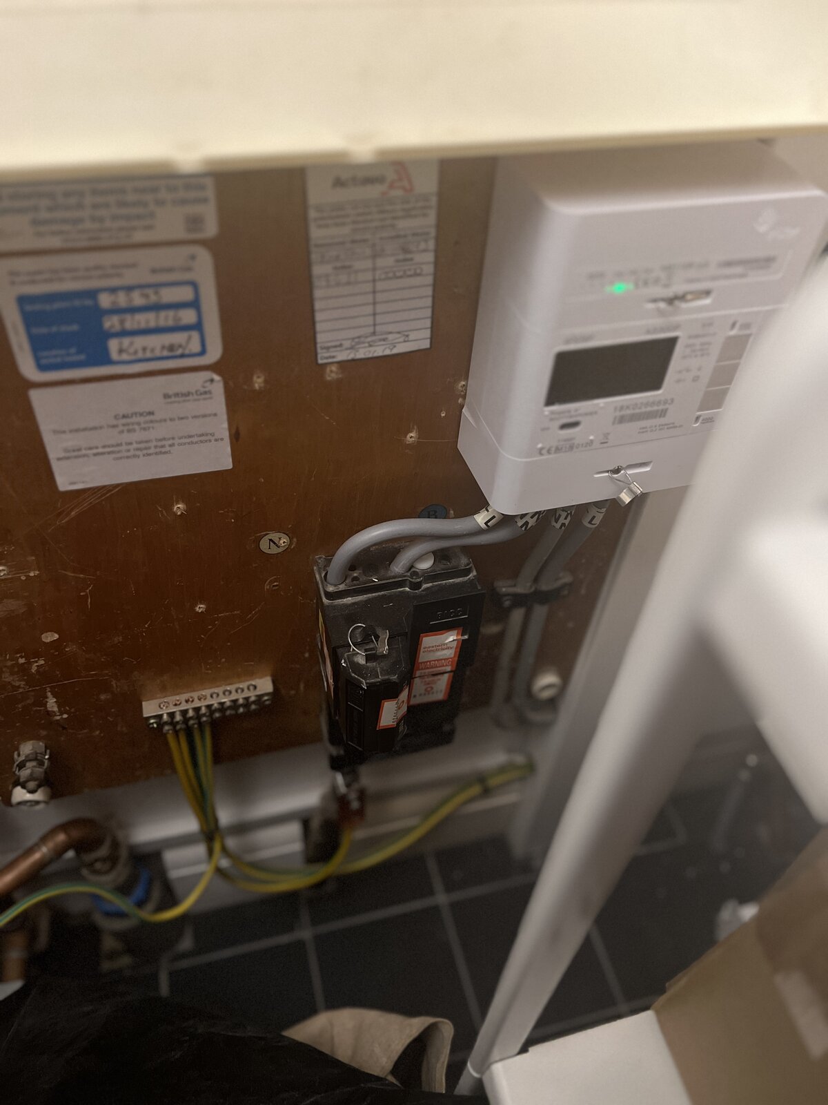

I agree Eric, i will get a specialist ev electrician to come and see what needs doing. The whole house was rewired about 10 years ago.
I am attaching some pictures of the fuse box and also on the last picture where the water tank ism is in the direction of the garage.
Any further insight is much appreciated.

To be honest you are wasting your time.
ANY decent spark will have to visit you to determine what’s what, and yes you may have thoughts but they may be well off the mark.
Garage is a 20A circuit, so not suitable for EV charging.
RCDs are the wrong type as well, and although there is a spare way it can't be used for EV charging in it's current location.
Those RCDs are not the “wrong type”
If inspected would get a C3
Your post suggested they were wrong full stop
Everyone else read the post in the context of the whole thread.
Sure, flameport could have written paragraphs and paragraphs with context and caveats, but if we all did that then we'd all end up like JohnW2, wouldn't we?
Before we all alienate @Dazio eith bickering....
The answer is, yes, whatever happens you'll need to get a cable back to that mains position, whether that be a direct feed to the EVSE, or an uprated garage supply from which it can be supplied. You will also need a separate unit there (either a small board which can accomdate the right type of RCBO*) or a switchfuse to supply an uprated garage supply. The alternative to that would be to upgrade the existing board, but that would be significant extra expense
