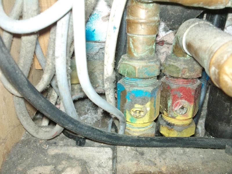

Can anyone recommend some decent quality isolation valves to replace existing to some hot water fan coils. recent repairs has shown several are leaking so the client wants them all replaced to prevent future issues
most are 15mm with a few 22mm one
Decent makes which will fit in place of originals as there isn't any room or much movement of the pipework to accomodate larger ones etc
Are 'gas' spec valves generally better than std water ones for example?
Genuine branded Ballofix valves. They have an Allen key socket as well as a screwdriver slot. Or Water Oil Gas lever valves.
I wouldn't have thought any local isolating valve would be fit for purpose. But no doubt they have worked ok for years so get the genuine "Ballofix" brand, as suggested above and in your first pic.
Are the valves in the first picture not the Ballofix?
The orginals have been there since 1988.

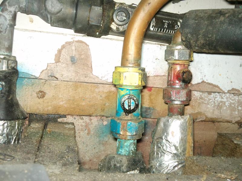

The 22mm pair on the left, which are not leaking at the glands, are Ballofix. The 15mm pair, which are leaking, are not Ballofix.
Granted they may not be leaking MM, but they're in no better nick than the cheapies on the right!! And it's a brave man that would put his Allan key anywhere near them, here's one that wouldn't.........Spent far too many Friday nights, draining down, repairing things like that & going home to find my Dinner in the Dog!!!............ :cry:

Valid question but as the system is quite old we now have to change 6 of the 4 port valves. I tied to isolate them and tbh all did but one of the valves started leaking. (then stopped again). Quite probably the first time it's been turned shut in it's 24 year life!
So we have 37 FCU that if one needs a new 4 port valve- 7 currently do btw- then it's a full drain down (no zone isolation) so it made sense to ask the landlord if he wanted all new valves on the hot side.
He asked me for an 'on the spot' quote so he could progress it. So I went with 3 quid a valve and labour. However when I got the quote back them there Ballofix bad boys are 7+ ea :oops:
Now if I can get nearer the 3 quid mark I went with I would take the hit but more than double is painful so I guess I need to ask Cottam & Preedy
