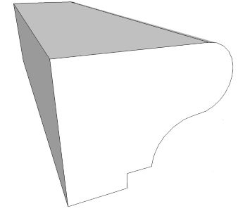

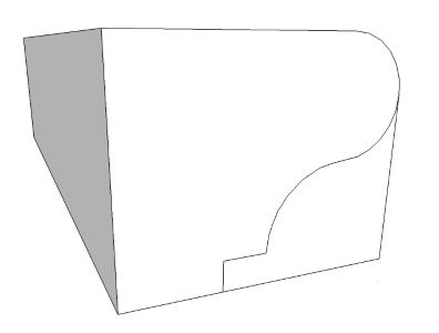

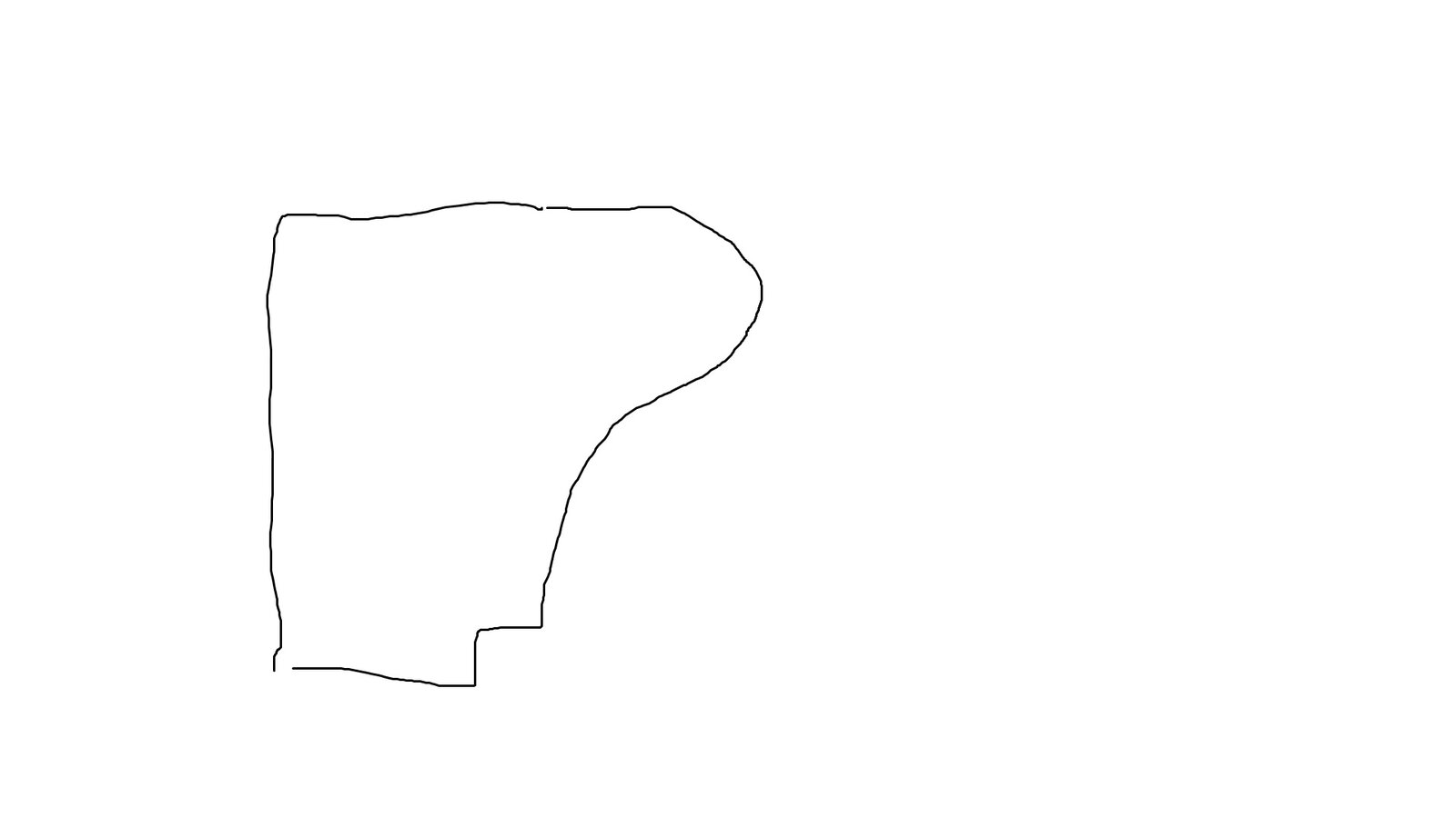

Today I was trying to thrupenny bit a profile on the end of a replacement timber window sill. The front face is 50mm tall. I was working from the underside of the sill with a fluted bit.
Apologies for the rubbish drawing.
I soon noticed that the fence for my Dewalt 625EK router isn't quite deep enough. After routing down by about 30mm. the fence would no longer have a proper face to run against. Can you get deeper shoes/plates for them?

(i) You need to set-up a sticking board to hold your material firmly and provide enough support surface for the base of a router whilst making the cuts (more about this later)

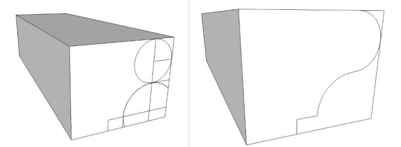

(ii) Make a physical template on a piece of cardboard (used cornflake packets are ideal!) and mark the profile on the ends of the timbers being profiled:
Also make up a counter profile (mirror image) template. This will be used later on to check against the completed profile. Note that this isn't meant to be any profile in particular, just one which is something like your sketch above so i can demonstrate the principles (so my crummy SketchUp version... :))
(iii) Work the round-over at the top first with a round-over cutter:

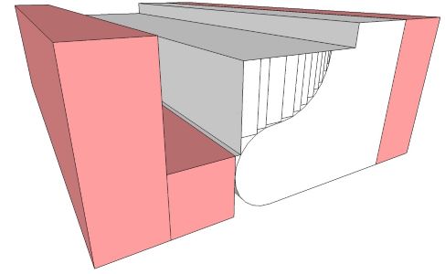

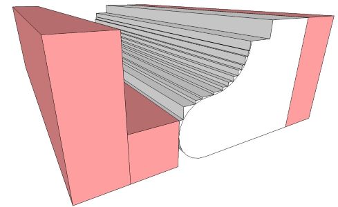

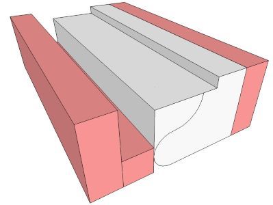

(iii) Then turn the piece over and fix it between several scrap pieces of the same height - these will form your sticking board (highlighted in pink). Now work the big rebate at the bottom - several passes with a decent deep fence and a straight cutter will suffice (try getting a big straight cutter, something like a 20mm diameter if you intend to do a lot of these as it is (a) faster and (b) smoother because it takes less passes):

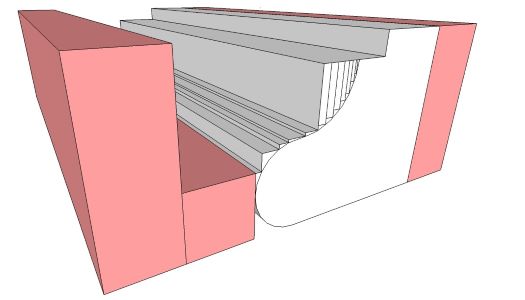

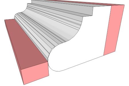

(iv) Rough out the bottom of the cove (underside) cut with the straight cutter to somewhere near by making multiple close passes:
If the router base isn't fully supported you may need to make-up an elongated sub-base which replaced the standard sub-base, to support the router on the sticking board (see next post for details - I've run out of photos on this one)

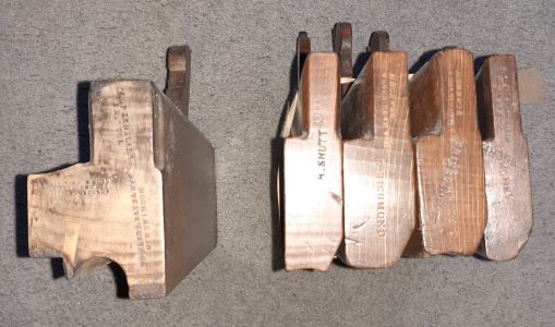

OK, so being an old hand I'd maybe have used a more traditional way for part of the time by using a half set of rounds and hollow planes (18 planes in total) to form hollowed and radiused edges and maybe side bead planes to make the bull nose sections:
Above: (Left) a boxed side beading plane, (right) two "pairs" of rounds and hollows. The biggest generally available planes cut a radius of 1-1/2 to 1-3/4in. Note - no metric, these are Imperial only
but the sticking board still gets used and I still rough away a lot of the waste using a router, straight cutter and fence or just a rebate plane before the moulding planes go anywhere near the work (they take so long to resharpen that you always try do the maximum amount of work with rebate planes or badger planes, and the bare minimum of work with moulding planes - AFAIK this was always the case).
For anyone interested moulding planes are the traditional approach, but do bear in mind if you want to buy some of these, that the majority most of them will be more than 100 years old and they have probably not been well looked after or properly stored since maybe WWII or even earlier when the original owner(s) died; manufacturing of wooden moulding planes ceased in the mid-1960s, but they really went out of favour in a big way in the 1920s and 30s with only a hand full of firms left making them by the beginning of WWII (1939). Quite apart from dealing with woodworm, which is not unknown in old wooden planes, it can take quite a bit of fettling to get them working again (reprofiling and resharpening the cutters, possibly dealing with wedges which are missing, the wrong one or have shrunk over time), with some plane bodies so warped or twisted that they will never work again. They don't need to be far out of whack to make them into nothing more than wall ornamants - and believe me, I've bought my fair share of those over the years!. But seriously, unless you are already into hand planes in a big way and can sharpen a block plane so that it will take an almost transparent gosammer-thin shaving off a piece of wood - I really wouldn't bother with moulding planes because without the basic skills, only frustration awaits :eek:

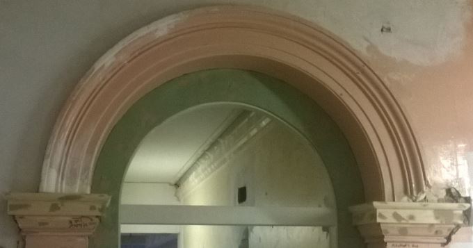

Above: Not a brilliant photo, but an example of replacement moulding repairs done in the field. The mouldings at the tops of the pillasters to the left and right of the opening needed to be remade, using a piece of moulding from elsewhere in the building as a template. In fact this repair required a quarter round, a square piece, an ogee with a quirk and a beaded piece to be produced - the corridor opening was blocked off with a hardwood frame glazed with 15mm pyro (fire-proof) glass - this meant that the mouldings around the tops of the pillasters needed to be removed and cut to accommodate the glazed light frame, then reinstalled either side of the frame. Quite a bit of the original mouldings had simply disappeared over the years, or was damaged (split, etc), hence the need to make about 4 or 5 feet of a built-up moulding. Note the copious quantities of pins and fillers! You can also see a plaster moulding repair where the left side has been repaired, but the right side isn't yet done (using a zinc plate template to run the plaster in situ)

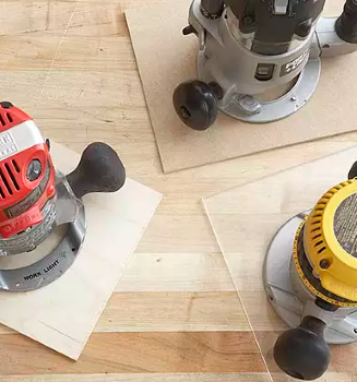

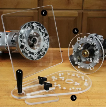

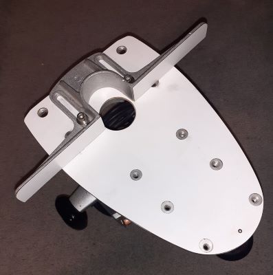

Elongated sub-bases to support routers on two rails such as the "sticking board" in the previous post can be made up from a scrap of 6mm plywood, or better a piece of 6mm Tufnol or acrylic plastic.
Obviously there is a limit on how wide you can go with a heavy router such as a DW625, but a sub base of up to an extra 5 or 6in (125 to 150mm) width over the original is feasible in 6 to 8mm thick material. There is a short article on how to make such a base here and this guy on YouTube shows some interesting sub-bases, although I had to turn the sound off and just fast forward to see what I wanted to...

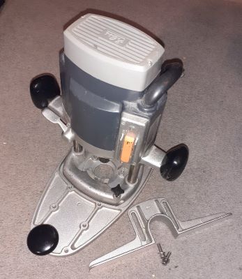

At one time some of the better router manufacturers (German in the main) offered factory-made over-sized sub-bases, such as this rather nice 50 year old sand-cast aluminium Elu model which was designed to fit all their larger plunge routers, including the later MOF177 (the original DW625) as well as the earlier MOF11, MOF31, MOF77 and MOF98 models:
Unfortunately it is still incomplete, as it is still missing the large loop handle it would have had at the front together with the cast ally lipping sub-base that would have attached via the six screw hole on the underside (used to flush trim hardwood lippings on furniture), but it does extend the base of the router to give a large support surface, allowing the router to be supported by two pieces of fence, as above, a bit like a girder bridge. It comes with a rather handy (manual) side fence, too
BTW, the "collet extender" in the first photo isn't actually a collet extender - it is an Elu OEM collet converter which converts the router from using a peculiar German-type M12 x 1mm threaded bits to the later standard Elu/deWalt large collets (as used in the DW625 et al). The converters are rated at 25,000 rpm which isn't a problem for this router as it only manages 18,000 rpm max ('coz it's old school technology designed in the 1960s)

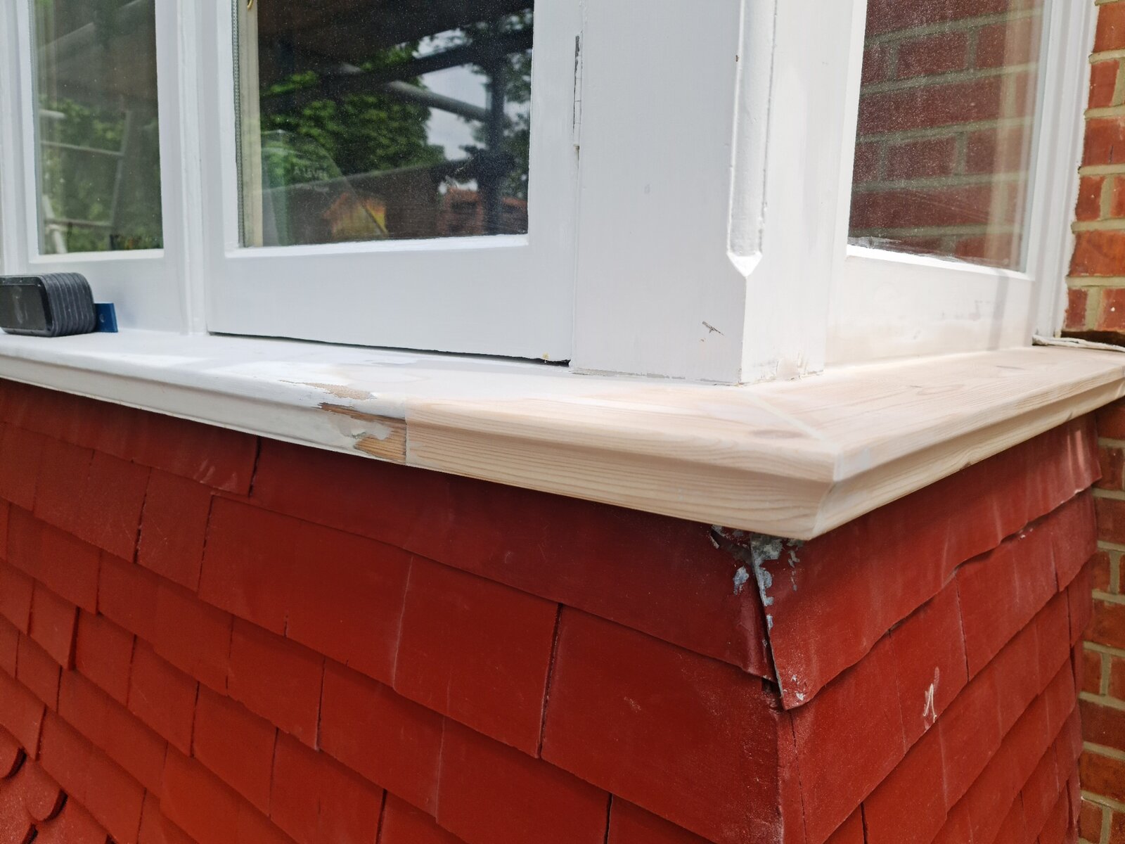

Thanks to your advice, I managed to fudge a "secondary fence" on the other side of my 1/4" Makita palm router (out of scraps of timber) which allowed me to route from the front face of the sill (which I had already epoxy'd in place). Unlike the Dewalt, the cheap Makita fence has a height setting.
It is far from perfect but it is high enough to "get away" with it.
The bottom rebate is a tad smaller than it should be. I think that is because I used a Vitrex profiler to copy the profile. I didn't have access to a section of time where I could copy the profile on to card at right angles.
I may sand in a more pronounced rebate, or I may not... I under quoted on the whole exterior. I have primed and undercoated it, there is no "visible" join (aside from the rebate tapering off).

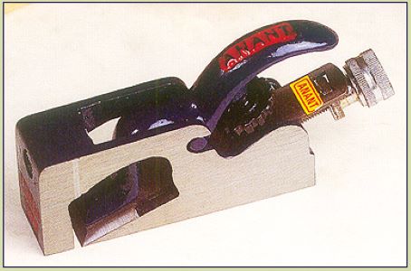

Rather than sanding, which can give a "soft" edge, I find a shoulder rebate or bull nose rebate plane is a better bet (even a cheap one):

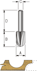

Thank you. Hopefully it will help you estimate a bit better next time. TBH with a selection of half a dozen or more core box cutters:
you can do the majority of concave mouldings you come across (and the little tilting base that you can get for the Makita/Katsu routers makes it even more possible). The rest is a block plane or a shoulder rebate plane, shaped bits of wood, sandpaper - and quite a bit of sweat equity!
