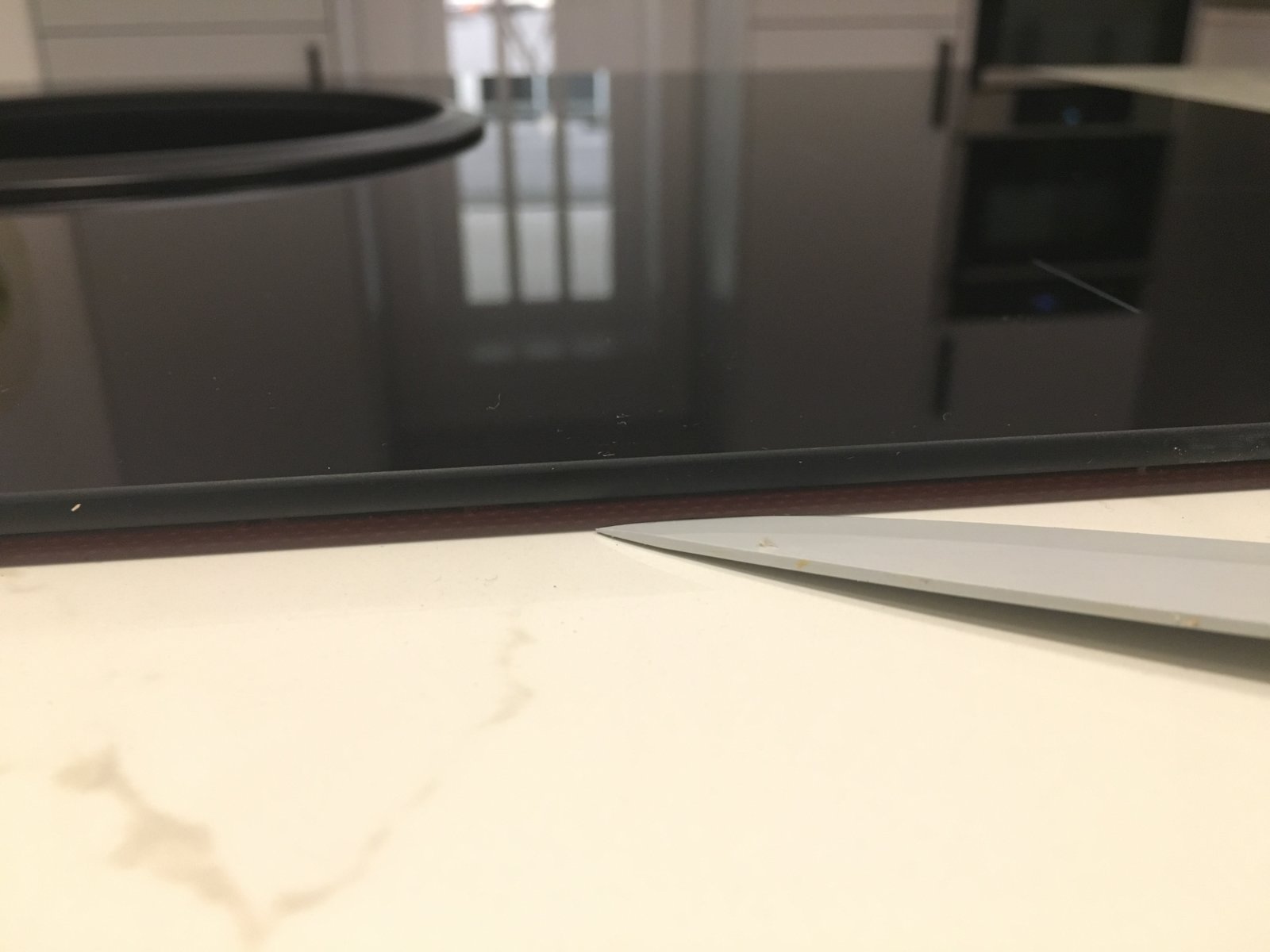

For the top fit of the hob the kitchen fitter has said we can remove the seal tape so that it fits flusher than the 2mm gap we have . There is tons of clearance as it is needed for the extraction unit and goes into a large drawer.

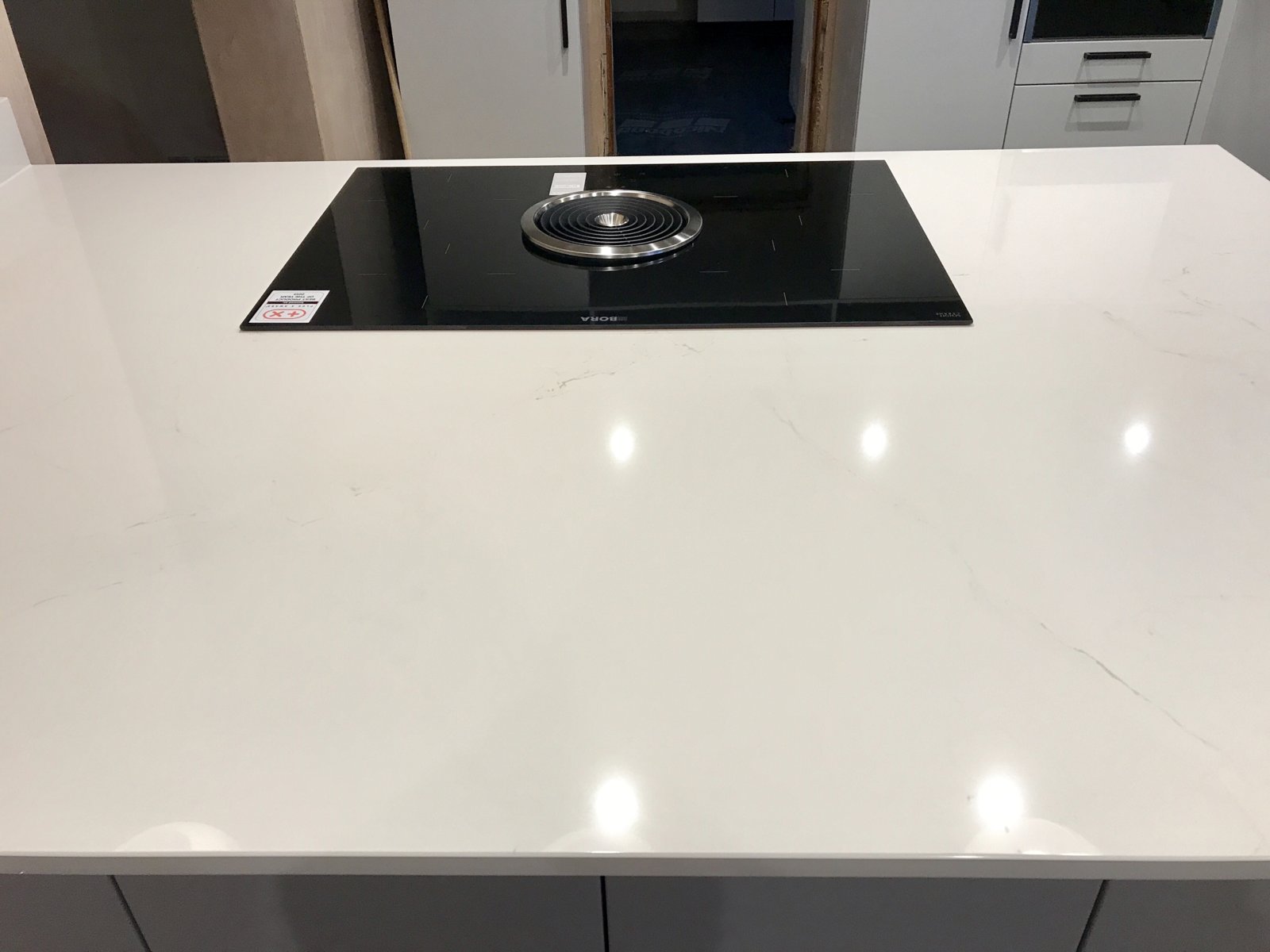

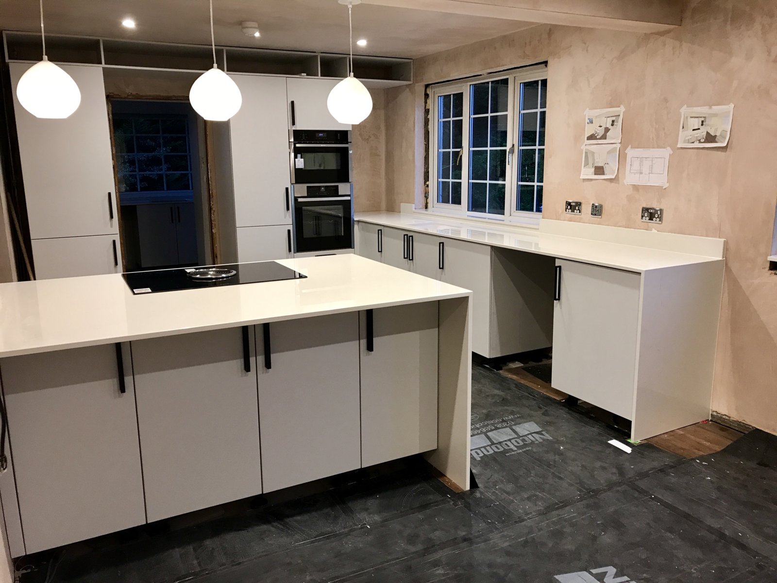

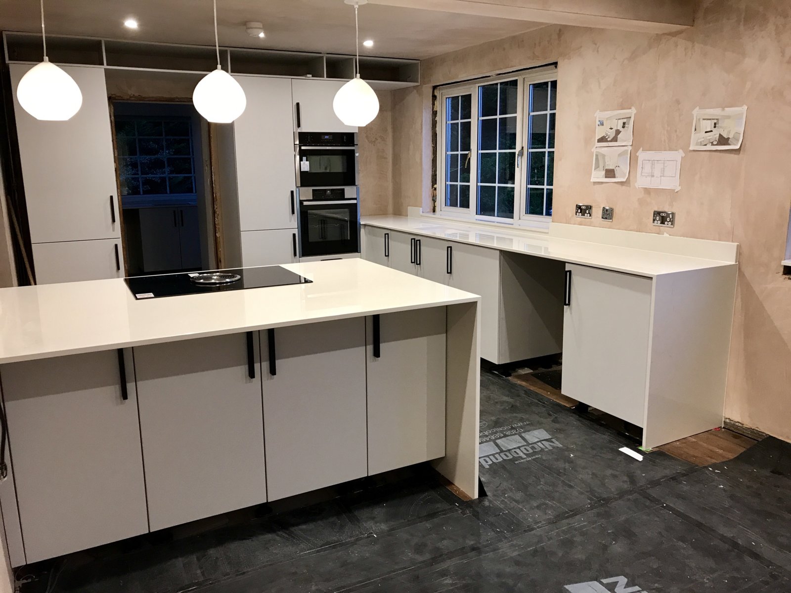

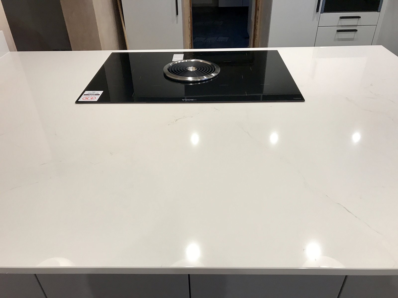

The photo is the way it should look (as it was when the worktop guys finished) but after hook up and install it is sitting 2mm higher (not got a photo of that until later tonight).
Issue now is the 2mm gap . Not convinced the kitchen fitter solution will be any good as the tape was there for a reason .

Whatever happens, there shouldn't be a gap between the hob and the work top, it should be as per those photos.
Great idea, the extraction being combined with the hob.....hardly a retro fit but it works very well.

Bora have said silicone is required but I think the insulation tape is too thick .

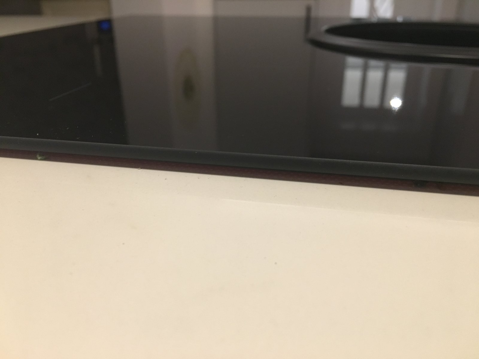

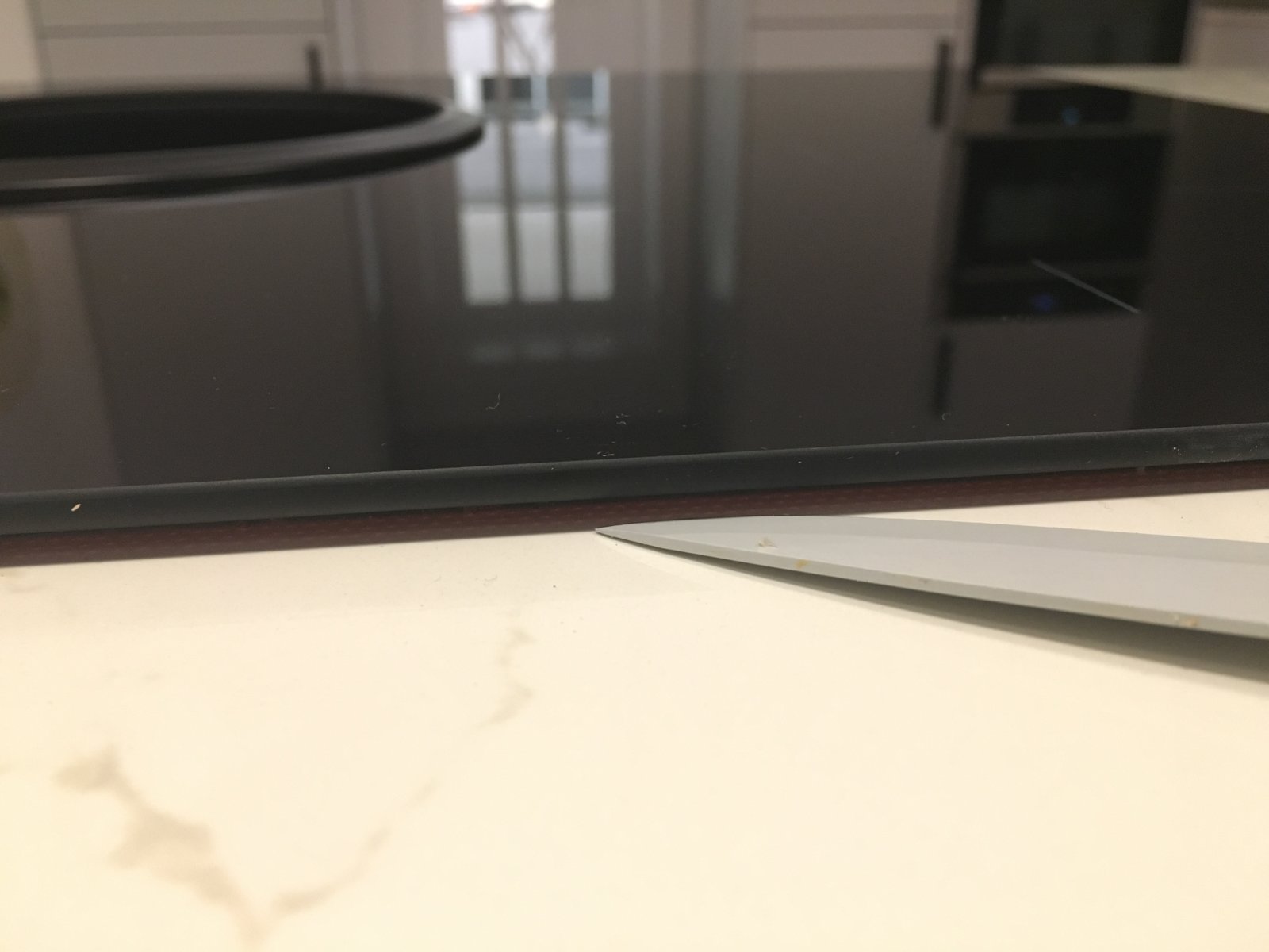

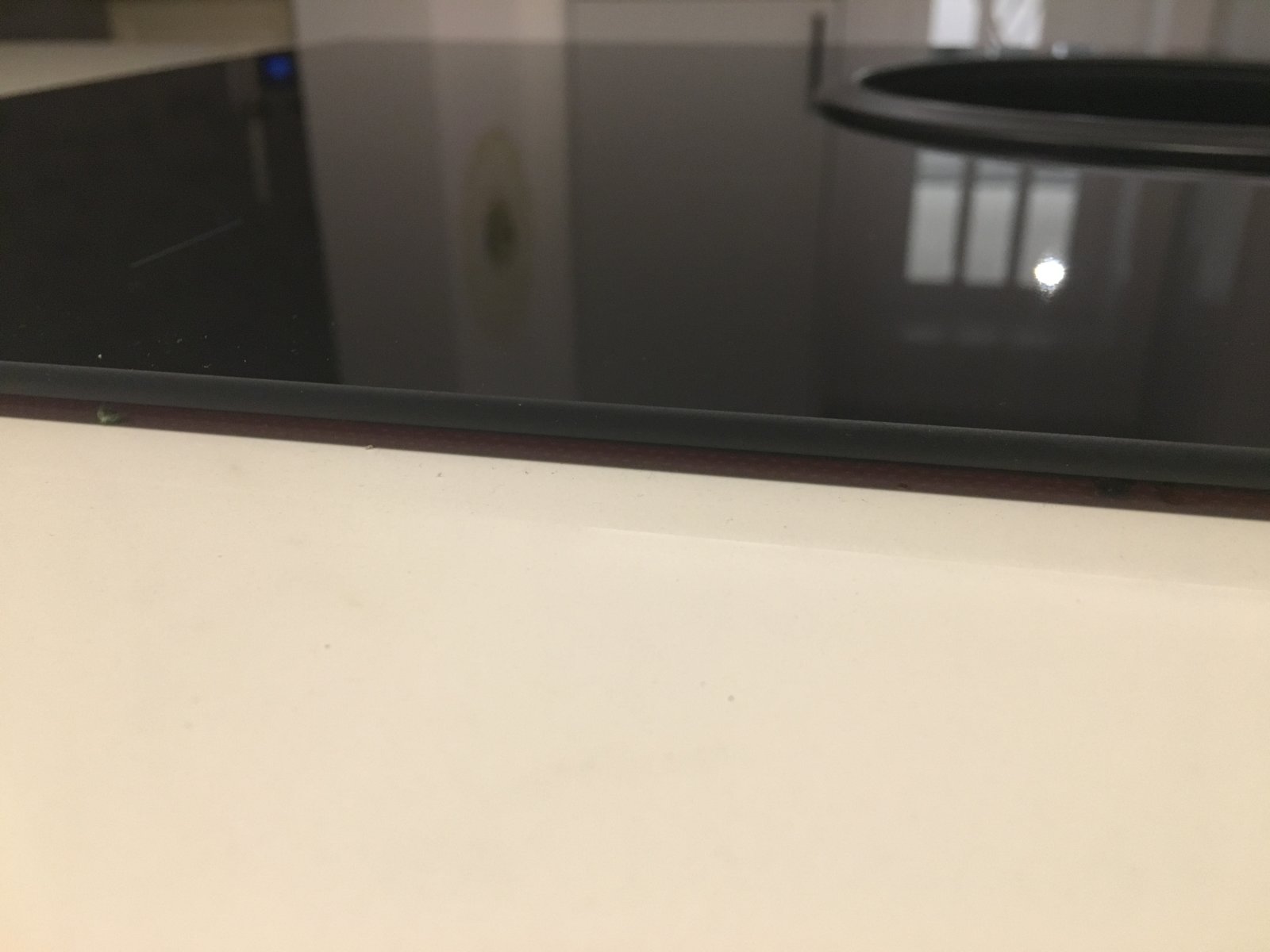

Here’s the current photo with the slight gap . Silicone it is ?
Something is wrong, and if Bora says silicone is required that's fair enough. Is the cutout in the worktop to the sizes Bora require ?
It should drop in to the cutout and have a little play, who specified the worktop cut out ? The kitchen fitter is talking ballllocks if he says he never fits them flush.
I think it is a few mm otherwise it would be flush after fixing the insulation tape.
