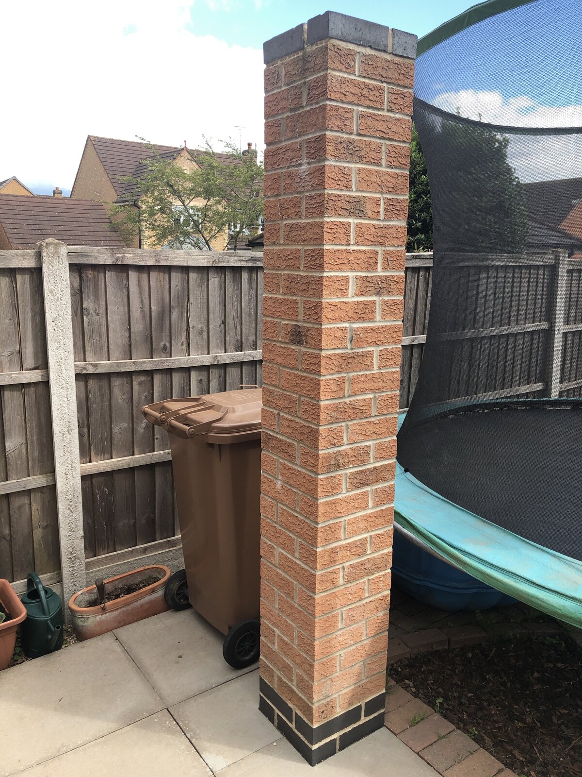

Hi, I want to get these demolished (there’s two of them) I got quoted £200, I want to do it myself and save some cash...what’s the best/cheapest way to do it please.....

They look strongly built. What were they for?
Don't try to knock the whole thing over because it will be very heavy and will cause damage or injury. Even a brick falling off the top will crack paving or break your foot.
Allowing for the cost of taking the rubble to the tip (several journeys) and the cost of tools and your time, £200 is very reasonable.
Ok thanks for your reply, they where used to support some wood, I got rid of the wood
If the £200 included disposal, it's a bargain
Basically take it apart brick by brick. You may be able to flog the bricks on Facebook, or build a BBQ
